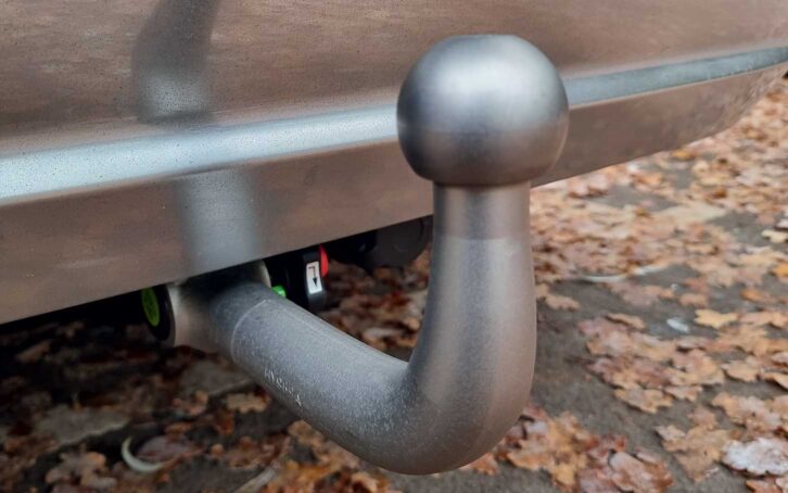

Let’s assume the caravan has a stabiliser hitch. Have you taken the paint off your tow ball?
Many tow balls have a layer of paint to protect against corrosion, but for pulling a caravan fitted with a stabiliser hitch, it is necessary to remove the paint from the ball. Failing to do so will result in the friction pads grinding away at the paint, making an awful noise and contaminating the pads.
A towball
Remove the layer of paint on the tow ball and sand it down.
If you haven’t taken off the paint, do so using sandpaper or an emery cloth. After removing the paint, wipe the ball down with white spirit or brake cleaner to remove any dusty residue.
This is going to be the most likely culprit behind the noise, and sorting that should put an end to that creaking sound when you’re towing your caravan.
