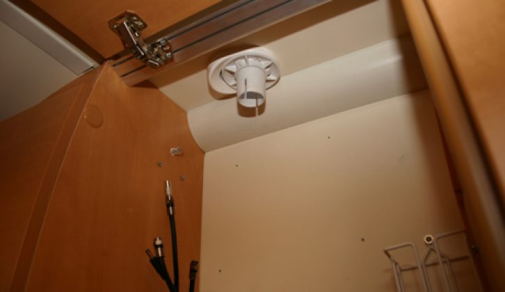

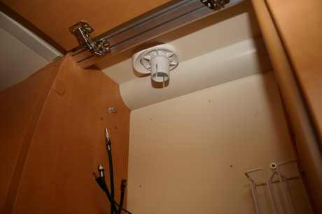

[tl:gallery size=460×307]1. Having withdrawn the Status 530 up through the roof of the caravan, I removed the two screws holding the locking plate in the roof locker in position so that I could also remove it and the taper washer under it.
