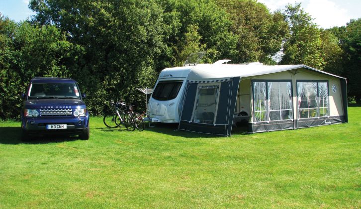

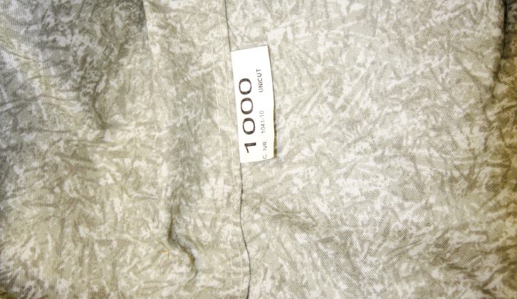

The first step was to book our awning onto the system and note what modifications were required. In our case, the awning is 1000cm, but our new Lunar Clubman caravan – despite being the same make and model as the old caravan – has an awning length of 1035cm. We had a choice: we could either have it extended to the next recognised size (1025cm), which might make it easier to sell at a later date, or have it made to the correct length of 1035cm.
We opted to have our awning made to fit the new caravan exactly, at 1035cm. One of the benefits of the way that Isabella awning roofs are constructed in sections is that they can be altered in such a way that they look original.

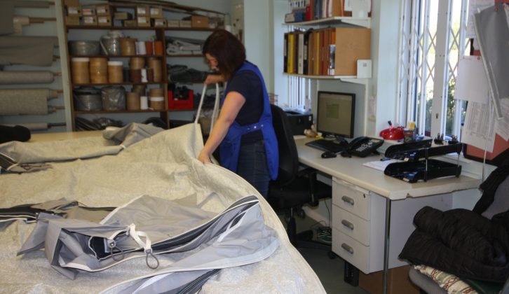

Once the awning had been checked for its condition, we went into the workshop, where I was introduced to Christine and her colleague Sue, who would be working on our awning.
The first thing Sue did was to remove the D-rings at each end of the base of the awning bead. This was then followed by the removal of the profile (the strip to which the fixing clips attach on the roof ), then the awning bead itself. Next, the stitching on the triangular panel at each end of the roof was unpicked so that it could be taken off. Any reinforcing patches and eyelets from that area are also removed. Because there was a double row of stitching on the roof seam, a strip 1cm wide was cut off so that there wouldn’t be any holes that could either be a weakness or allow any awning leaks when the new panel was sewn in. This 1cm was added to the new insert’s dimensions.
Once the roof section had been removed, a new piece was rolled out (in the same material as the original) and the old part was laid on to form a template. However, the increased measurements were used when it was marked out (adding 18.5cm to each panel). Once these had been cut to size, it was time to start the reassembly.
A special tool feeds the materials into the sewing machine, which puts a double seam into the awning roof join. This adds strength and ensures that it is waterproof. The new panel was sewn to the ‘Harlequin’ section at the end of the roof, before the reinforcing patch at the front corner could be replaced along with a new eyelet (where the support pole attaches).
It was then time to attach a new awning bead of the required length, plus reinforcing tape – as used on the original – which helps to prevent the bead’s tape becoming damaged when it is fed into the awning channel on the side of the caravan. After that, the D-ring at each end was replaced, before a new profile was stitched on.
The final job for Sue and Christine was to fold the awning and replace it in its storage bag, completing a remarkably quick and efficient awning extension process.
