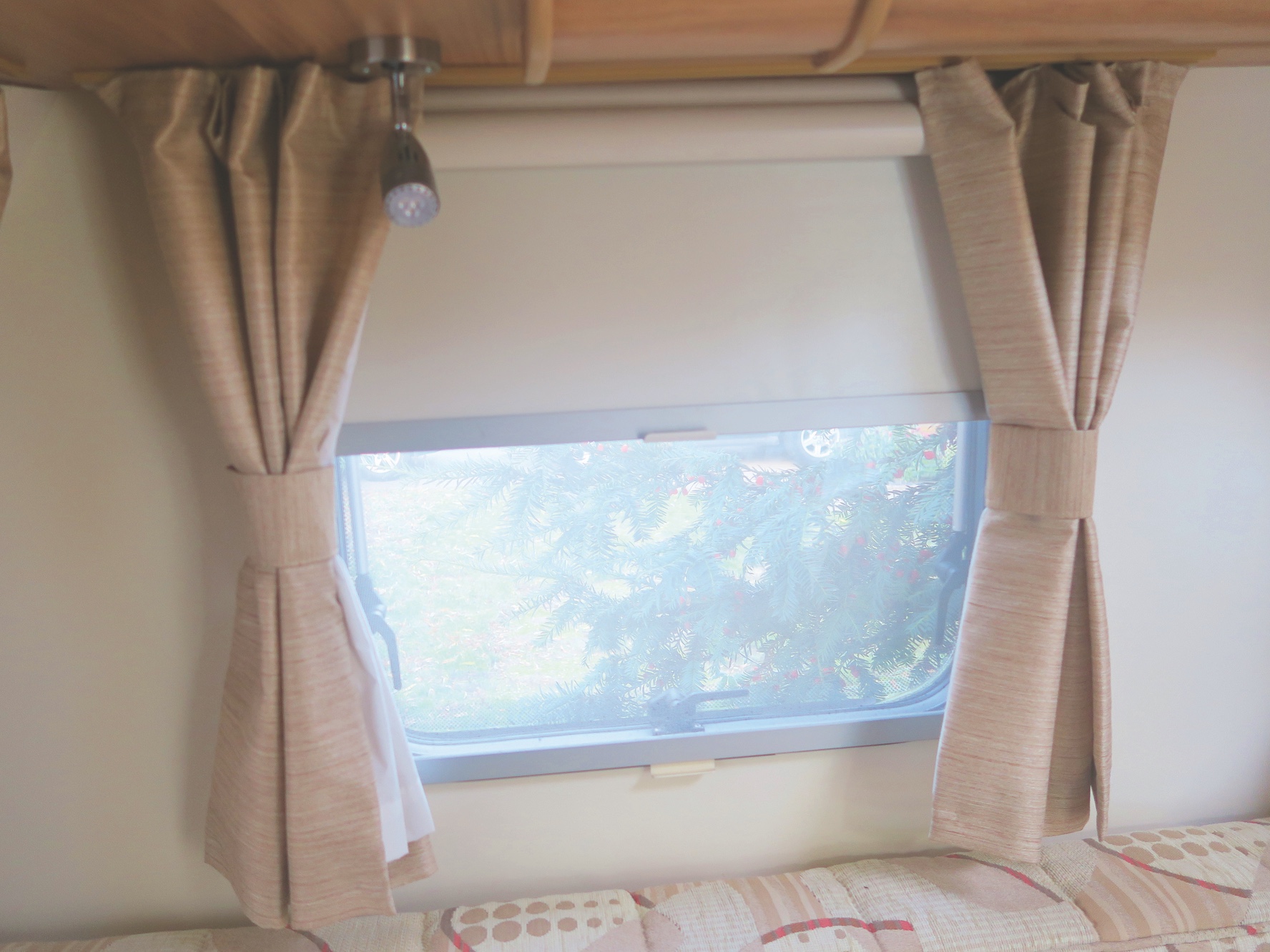

Most caravan owners usually like to see curtains on all of the windows, and if you value this form of ornamentation, do check that they run well and make sure any drapes near the kitchen remain well away from the burners on the hob.
An alternative to curtains in patterned fabric is net or voile drapes, which offer you a bit more privacy when you are inside your caravan, without reducing the natural light.
Curtains now tend to be regarded as a fashion choice – while some caravan manufacturers are no longer fitting them, some recognise that traditionalists would balk at the thought of a window bereft of drapes, and have begun mounting a fabric drop on either side to look like a curtain. This doesn’t draw across the windows, it’s merely a cosmetic add-on.
If you do have curtains and they are looking a bit tired and crying out for a make-over, firms such as Regal Furnishings offer a huge choice of fabrics to personalise your space.

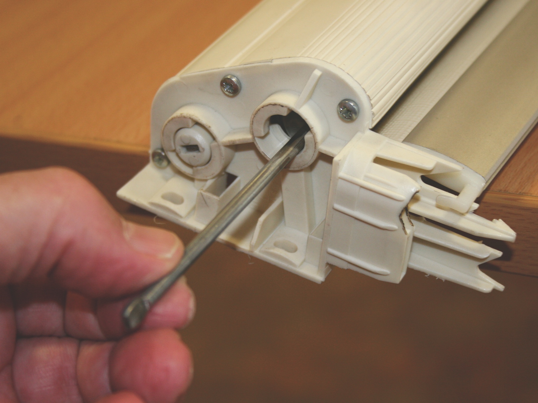

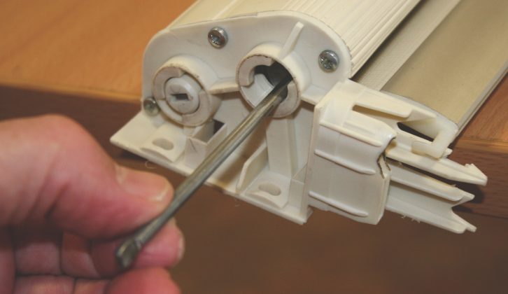

On many types of cassette blind, the spring can be retensioned or slackened – the procedure varies according to the product. Normally gaining access to the spring involves removing an end cap, which can often be a little tricky as van manufacturers are renowned for building furniture right to the end of the cassette, which then obscures the cap.
In this instance, the entire blind needs to be removed in order to make adjustments.

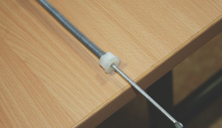

Once access has been gained to the spring, it can then be tightened or loosened by turning the steel spindle in the middle, using pliers. There should be no need to remove the spring completely.
Once it is at the required tension, ease it back inside the cassette in order to engage its locked position.
Repairs are also reasonably straightforward – I recently helped a neighbour to fix his blind. Dents were appearing on it where something had got stuck. On dismantling the blind, we established that the beading, which is used to secure the blind material to the roller, had slipped out of place.
The blind was reassembled and the tension set: a job that definitely required more than one pair of hands!
