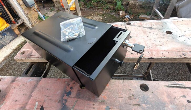

Out of the box

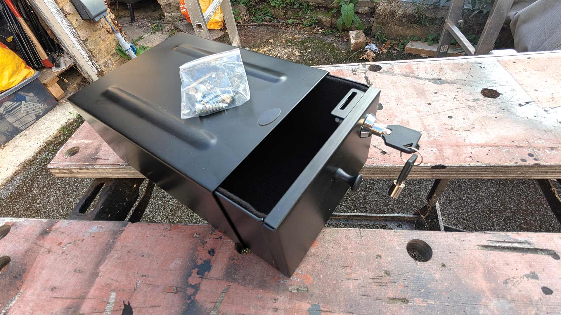

Inside the box you get the safe, a pair of keys, and a pack of chunky countersunk fixing screws. It’s finished in a durable powder coat. Nothing flashy, but it feels solid.
Before grabbing your caravan tool kit, think carefully about where to fit it. Caravan walls are often thin ply or composite panels –not strong enough for fixings.
The Milenco kit
The kit consists of the safe frame, the locking drawer, keys and countersunk mounting screws

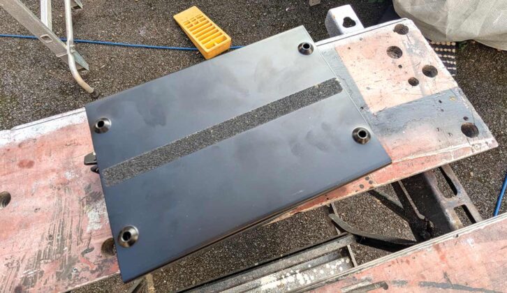

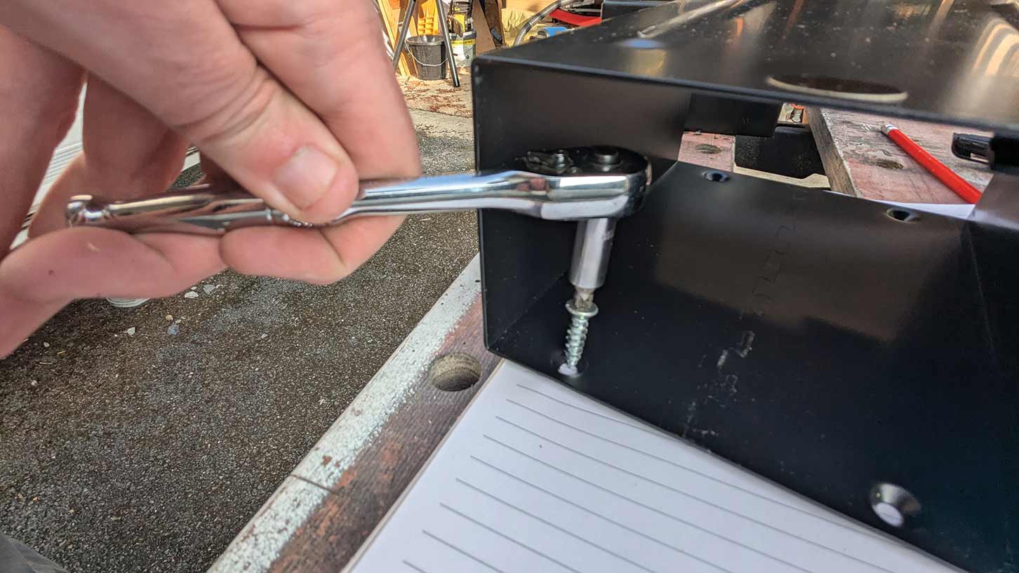

The safe is a simple steel box with two open ends and four countersunk mounting holes. You can’t get a drill directly through the holes because the top of the box is in the way.
The mounting holes viewed from underneath
Mounting holes viewed from underneath are also countersunk – the mounting screws need to be flush with the frame for the safe to work

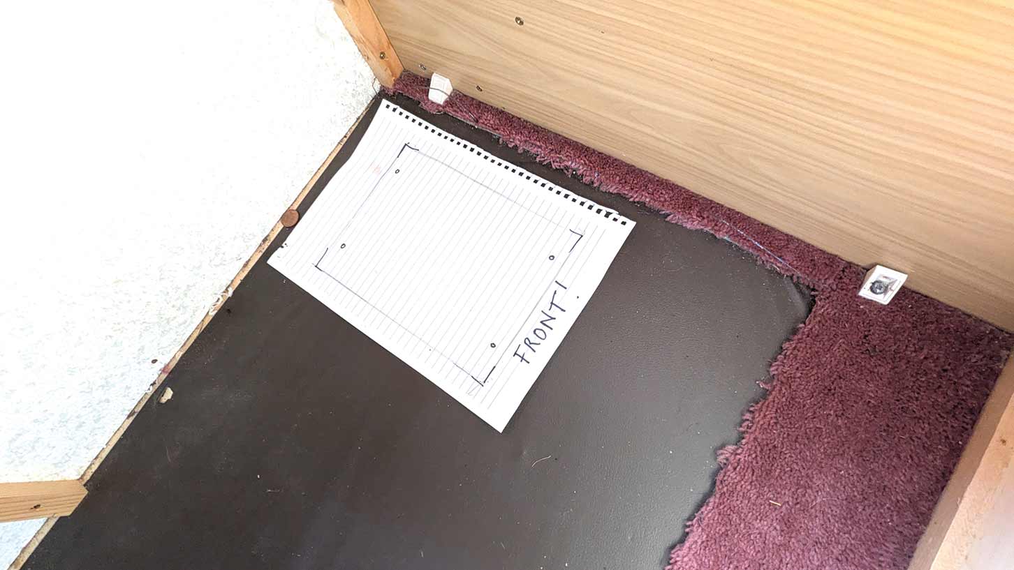

To work around that, I made a quick template. I grabbed an A4 notepad, placed the safe on top, removed the drawer, and traced around the base. Then I marked the mounting holes and noted the front of the unit on the paper. With the template in hand, we headed to the van to scout a location.
Using the template to work out where to put the safe
We used the template to work out a suitable location to mount

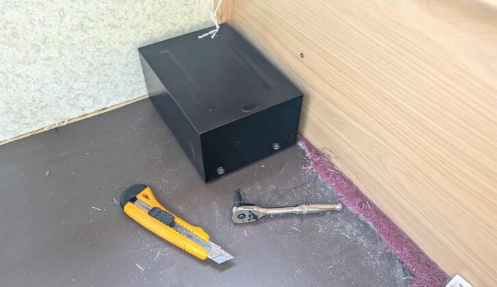

We settled on one of the underseat lockers. When we’re away, it’s typically full of clothes or bedding – easy to access but clear of any cabling, pipes or appliances. We’d considered the space under the centre chest, but the mix of wires, gas pipes, and awkward access quickly ruled it out.
Using the ratchet to drive the screws in

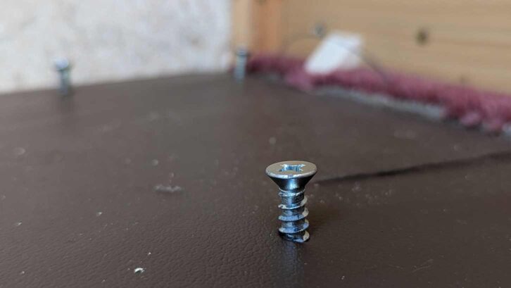

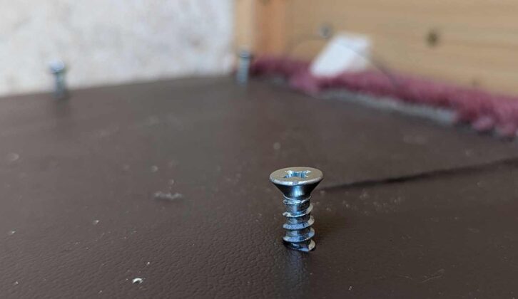

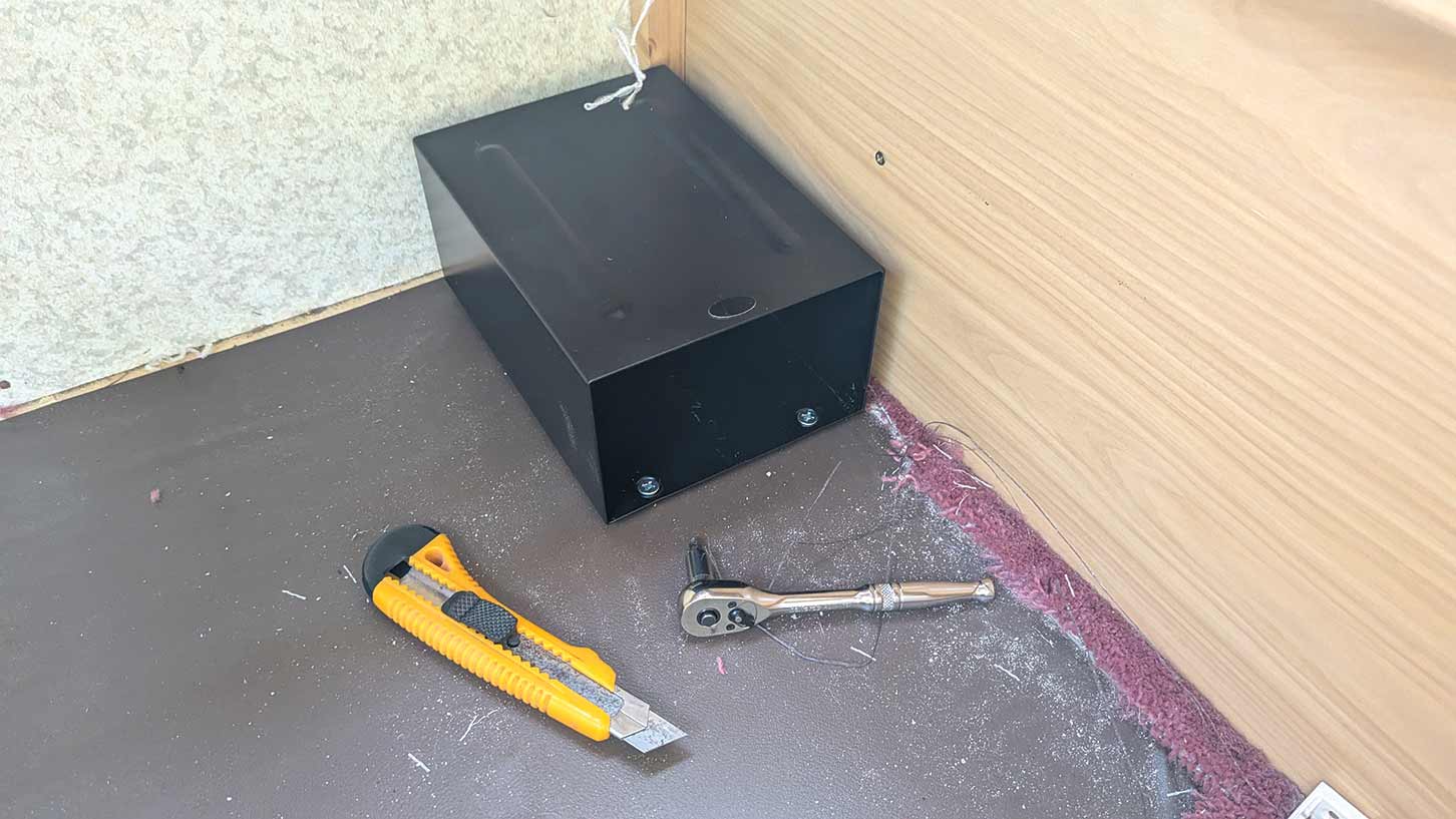

Once settled, we piloted the holes in the floor and found a ratchet we could drive the screws in with
Laying in the template showed we needed to trim back the carpet to tuck the box in properly. Once it was cleaned up, we taped the template down and used a 3mm wood drill to make pilot holes. The fixings themselves aren’t ultra-strong, but we added a dab of adhesive sealant to each screw before lining up the safe and securing it in place.
Starting again with the frame in place
We started the screws without the frame, then removed them before starting them again with the frame in situ
Screw access was tight, so I rigged up my smallest socket set with a PZ3 tip. The frame only allowed about a third of a turn at a time, so it was slow going. My chubby digits didn’t help. But it went in fine – fiddly but not difficult.
The safe in place
Secured and working!
Once the sealant cured, the safe was solidly fixed. The only way to remove it now would be to take out the drawer, so unless someone’s stealing the whole safe, it’s not coming out quietly.

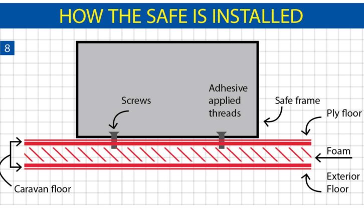

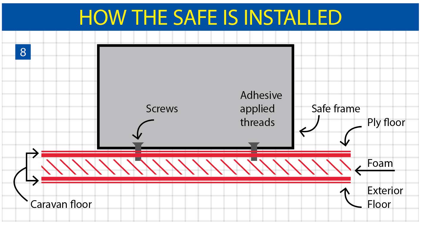

The safe screwed down
Cross-section showing how the safe is screwed down

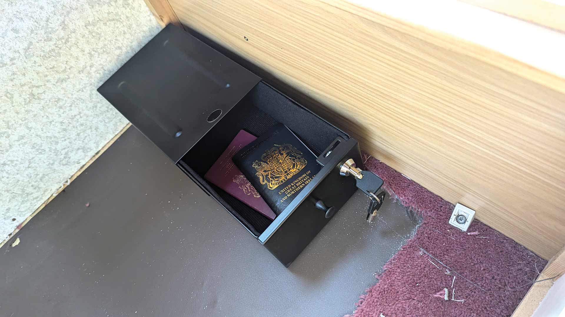

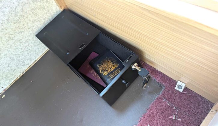

At a music festival, it gives us a discreet, secure space for wallets, cards, and other small items. It’s simple enough to access in our underseat locker, but easy to hide, too – just toss a soft bag or blanket on top.
The safe with items in it
Modest size means you won’t be putting your laptop inside, but for passports, wallets and phones, it is perfect

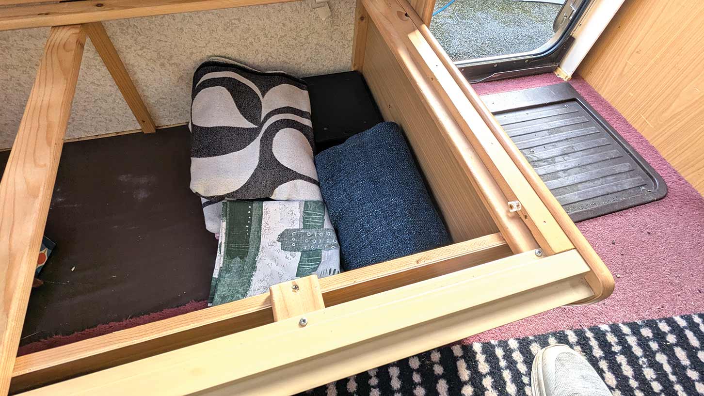

The safe with items on top of it
Once items are packed around it, the safe is very discreet and is ideal for keeping valuables hidden from view
