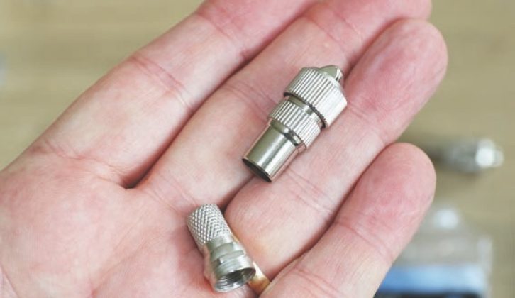

  • A length of good quality coaxial cable to form the extension lead, plus a short length (50cm or so) for each TV
  • Coaxial plugs
  • F plugs – screw-on type
  • Stanley knife
  • Wirecutters

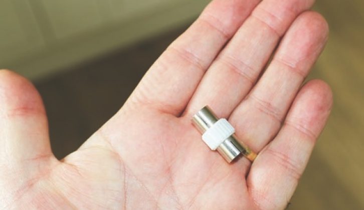

It doesn’t matter if you start with the long or the short cables, as they’ll end up having the same connections. At one end, you’ll need a coaxial plug (male), and at the other, an F plug. It’s also worth carrying a male-to-male coaxial adaptor in your spares, just in case the bollard has a male connection.
