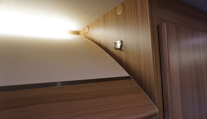

My own preference is stainless steel fender eyes, which I buy from marine chandlers, such as Gael Force Marine Equipment (www.gaelforcemarine.co.uk). These cost only £1.53 each and they are a robust, well-finished stainless steel hook.
You will need appropriate stainless countersunk screws of a suitable length for the thickness of your fixing places. Try the screws in the hooks and, if necessary, use a large-diameter drill to widen the countersunk recess in the hook until the screws fit flush.

1 Stainless steel fender eyes are neat and strong
