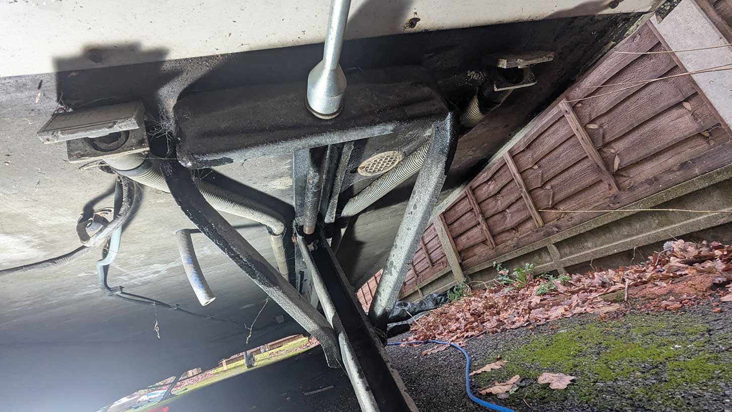

Towards the end of last season, Penny, my 1998 project caravan, developed exactly this symptom. I jumped underneath with a squirt of spray grease to ease the issue in the short-term, but pegged it as a task to return to during the winter as part of the regular maintenance.
On closer inspection, the corner steadies were not only noisy but increasingly stiff to operate. In the good old days, a typical approach to this sort of task was to slap a handful of grease on the corner steady’s worm thread, wind it back and forth and call it a day.

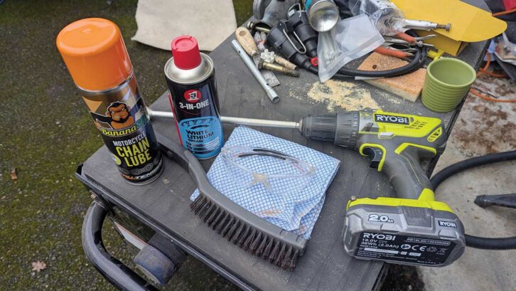

Tools for the task
It’s time to reach for your caravan tool kit! This is pretty unpleasant work, but it doesn’t take too long and won’t need doing for a while. The toolset needed is limited, but do ensure you have your eyes covered and ideally, have a pair of gloves on to simplify the post task clean-up.
Also, as we are raising and lowering the steadies to complete this task, ensure the handbrake is securely applied, the wheels chocked, and you don’t have people in and out of the van while you work.
We’d also advise doing one steady at a time to keep the other three doing their job.
Nigel’s tools for greasing the steadies
Before you start, you need a few tools handy. For cleaning up, get a stiff wire brush, plenty of rags and I used some brake cleaner for the final thread clean-up.
For getting the new lube in place, grab an electric drill with a corner steady attachment if you are lazy, or your steady winder if not.
We aren’t tremendously knowledgeable about motorcycle chain lube, but a 500ml can of Tru-Tension BananaSlip Chain Lube did the job.

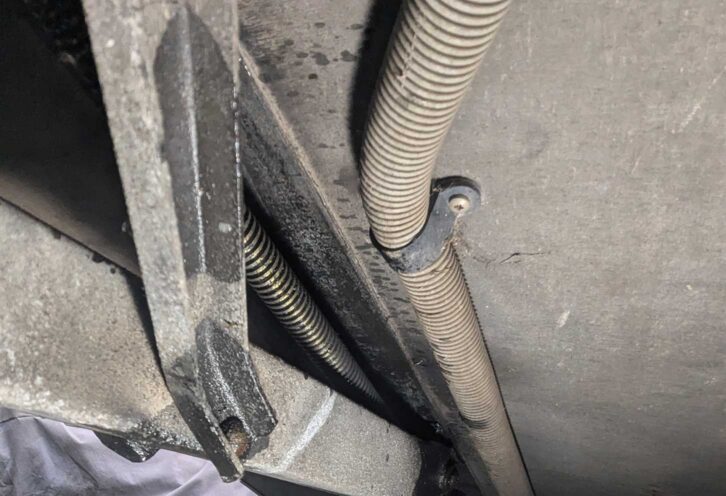

Wind the legs down halfway to expose the maximum amount of the threaded bar. Wear safety glasses and get to work with the wire brush. You need to be aggressive as the goal is to remove the old, caked-on grease and surface rust.
Scrubbing along the length of the thread
I scrubbed along the length of the thread to get the worst off, and used a rag to wipe the thread clean. You want to see bare metal. Brake cleaner or WD-40 can help – make sure to wipe it off.

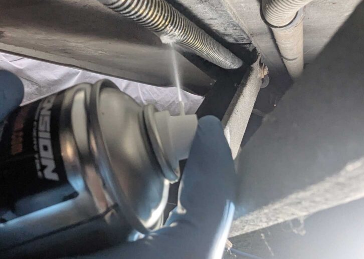

Take your motorcycle chain lubricant and shake the can well. Spray it generously along the entire length of the cleaned threaded rod. Because it comes out of the can as a thin liquid with a solvent carrier, you will see it wick into the gaps between the thread and the nut.
Spraying the motorcycle chain lubricant
This is exactly what we want. After a few minutes, the lubricant starts to tack-up and you can move onto the next one.

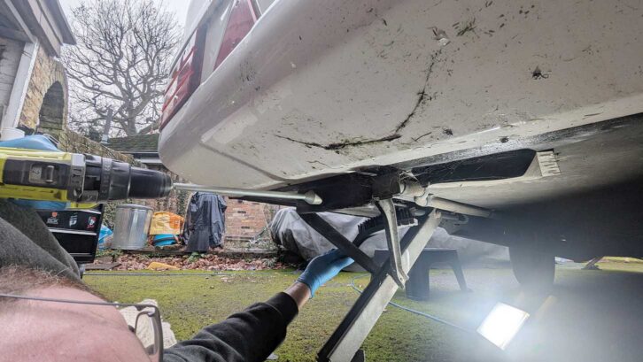

Step 4: Work It In
Now for the satisfying part. Attach your steady socket to your cordless drill. Set the torque setting on the drill to a low/medium setting – this prevents the drill from wrenching your wrist if the leg hits the stops.
Distributing the chain wax
Run the steady all the way up and all the way down three or four times. This action distributes the chain wax evenly across the mating surfaces of the thread and works the oil into the pivot points.
