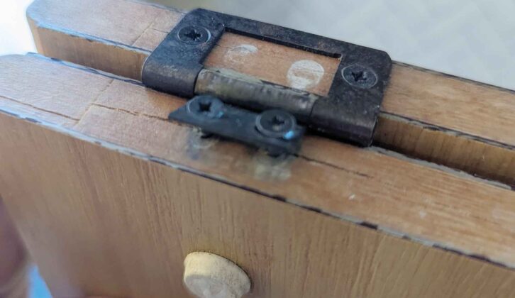

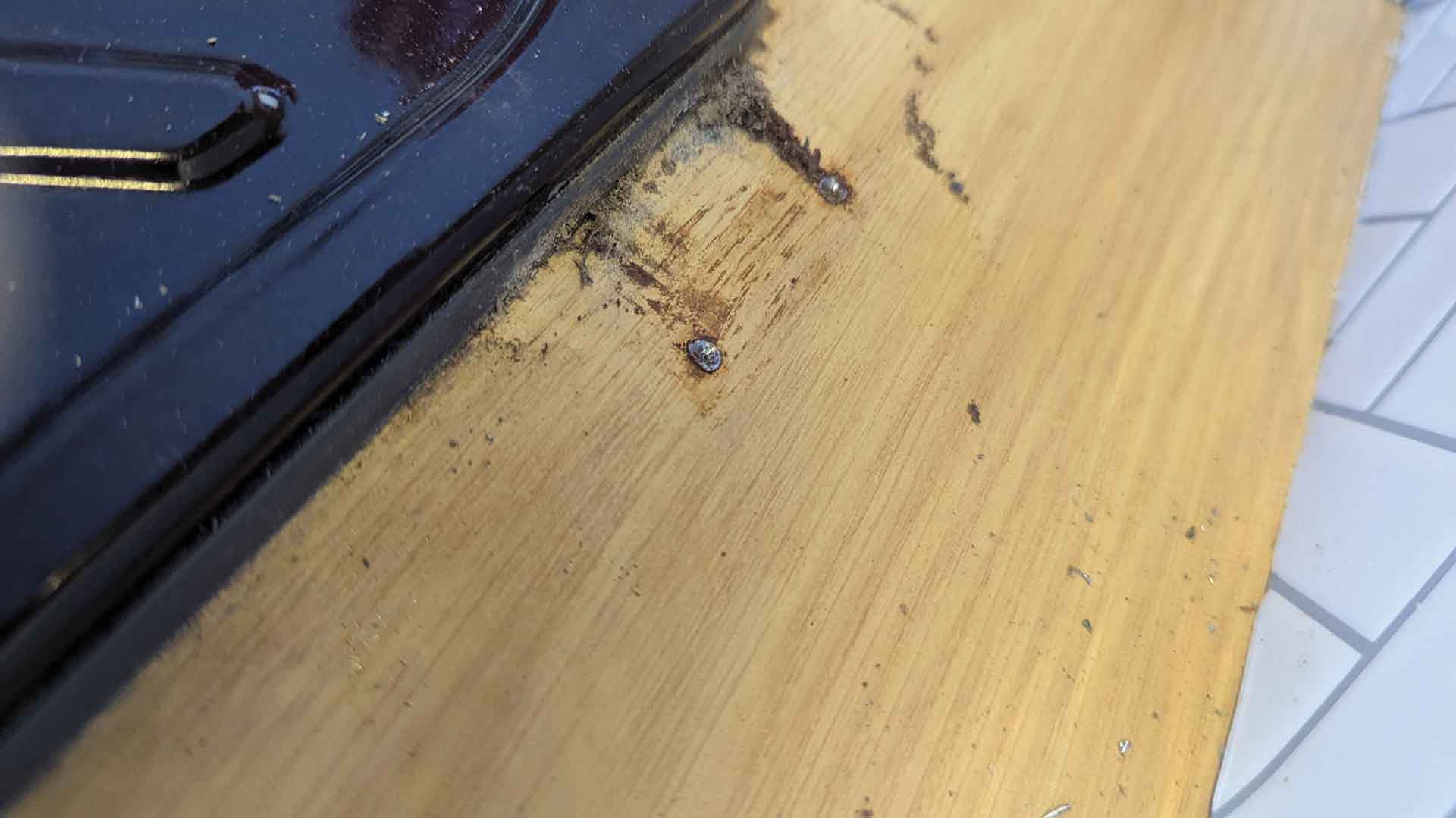

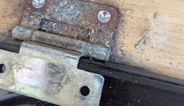

When you’re buying a used caravan, you may find that it comes with a fold-up cover for the sink, like Penny does. In truth, the cover is awkward to use, the hinges were semi-seized and it needed repair. We decided to remove it. It sounds easy. It was not.

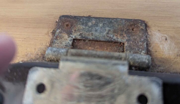

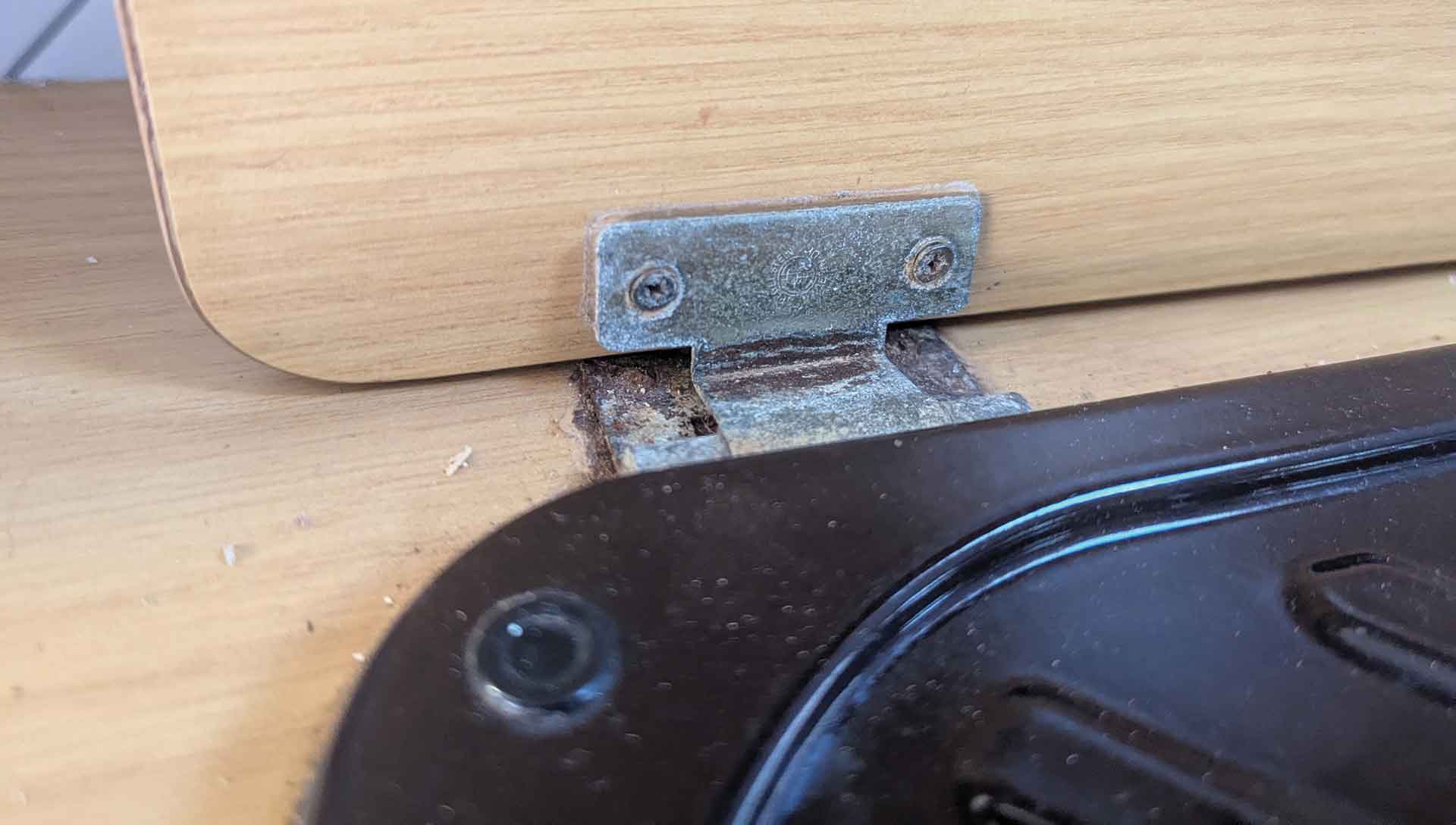

Being so close to the sink, the small screws were rusted and could not be undone. The only option was to drill off the screw heads. This took a while, made lots of mess and was a hassle.
Once the screws were out, the damage to the work surface could be fixed with a smear of filler. Then the whole worktop was thoroughly cleaned and wiped down, ready to start fitting the vinyl film.

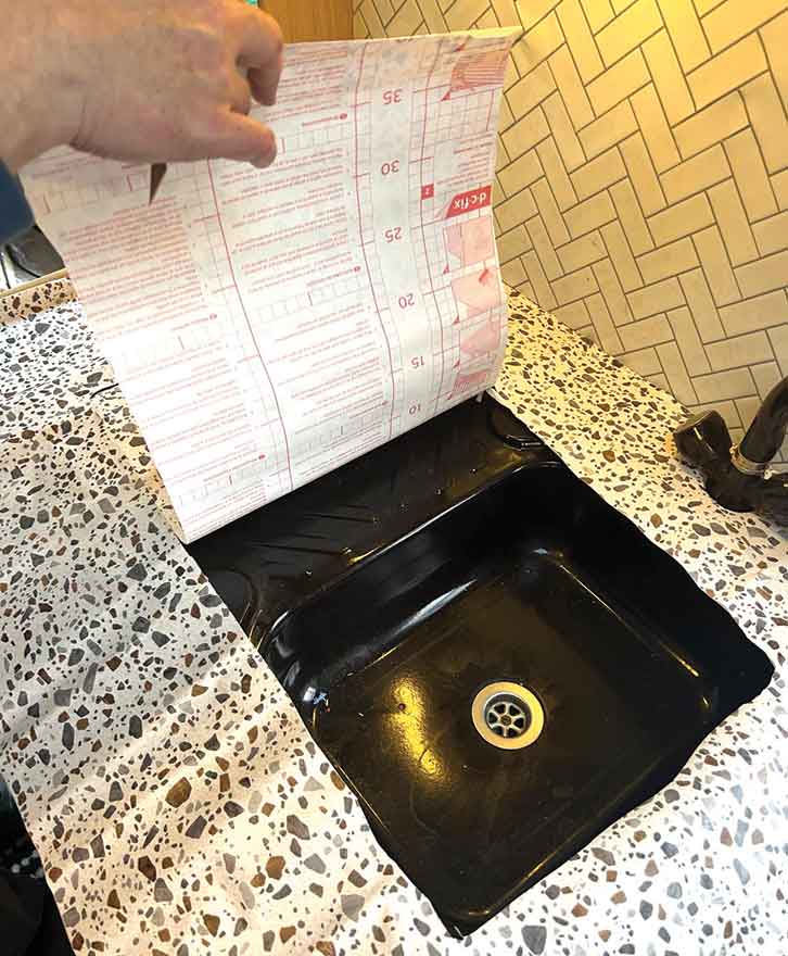

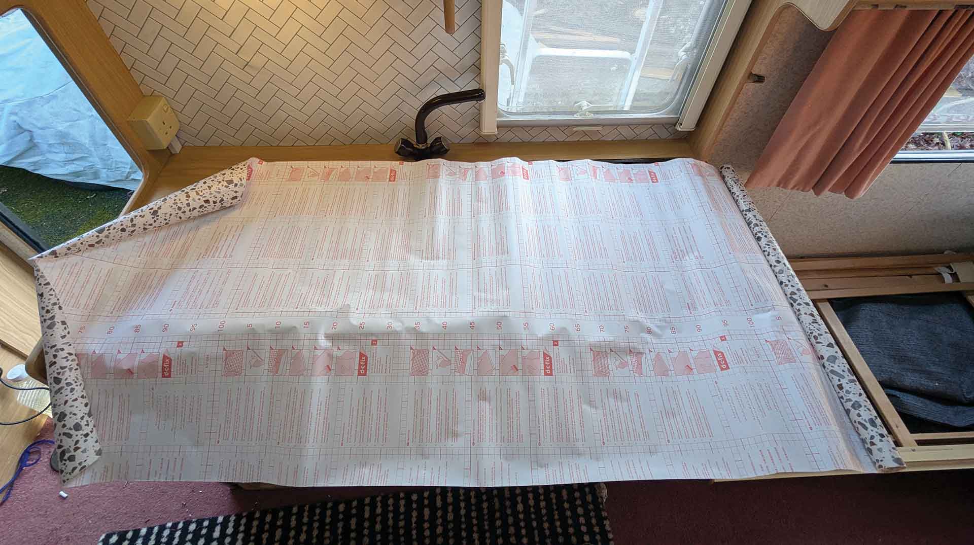

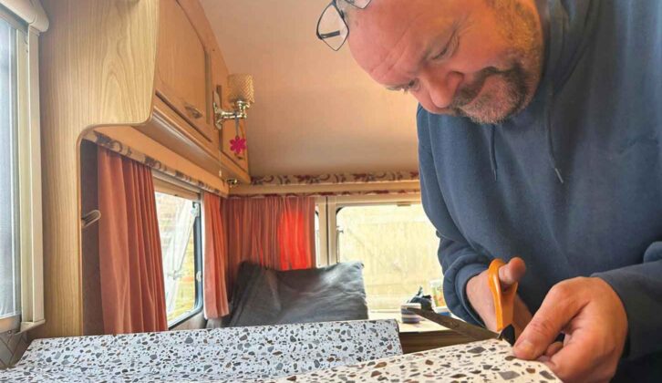

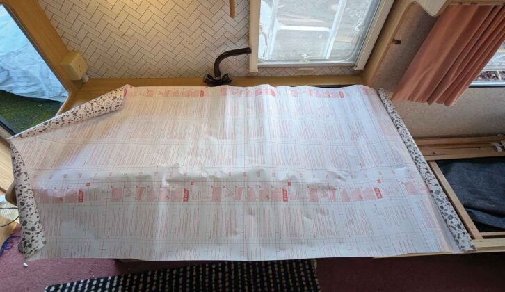

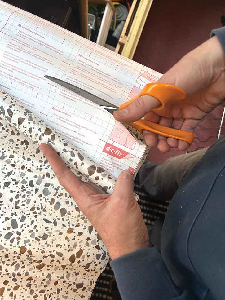

The best advice for getting good results is to plan how you are going to fit the vinyl before you get out the scissors. Our worktop has a sink and hob to cut out, which means there is a lot of waste, but that can’t be helped. We followed the guidance video from D-C-Fix on YouTube, which said that you should work out the total length needed first, and then cut the film to length.
Cutting to fit the caravan work surface

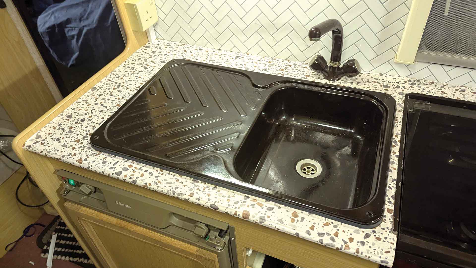

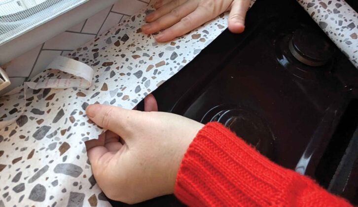

The sink and the hob are flat, so they didn’t get in the way when we began planning how to fit the vinyl film.
The tap, on the other hand, was a different matter. Ideally, you would remove the tap, sink and cooker to get the easiest fit. For us, however, this just wasn’t going to be practical.
It was easier to cut around the sink and the tap, although we were able to remove the securing screws from the cooker and lift it slightly, then fit the film underneath.

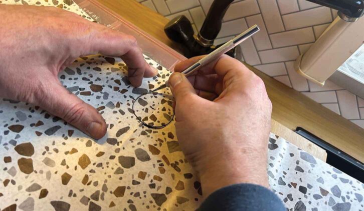

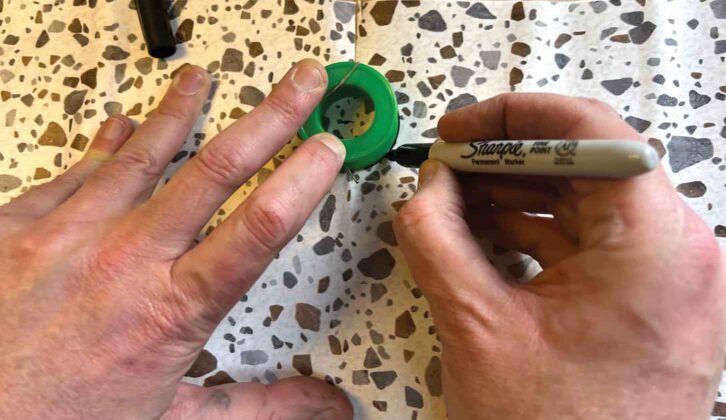

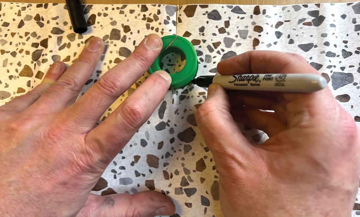

For the tap, we carefully marked and cut out a circular hole for the tap base and split the foil behind the tap. The join in the foil is behind the tap, so won’t be seen.

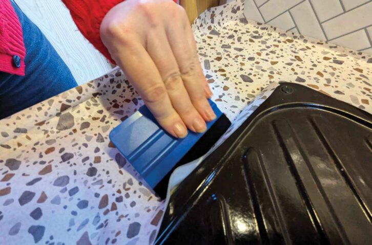

A small water spray is useful for making the fitting easier, while a hairdryer helps to get the vinyl to fit around the curved worktop edges.

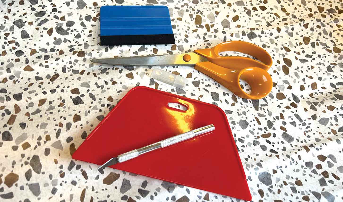

We also decided to invest in a smoothing squeegee, a sharp knife and a flat plastic scraper, which helped to get rid of any bubbles under the surface and ensure that the finished result looked as good as possible.

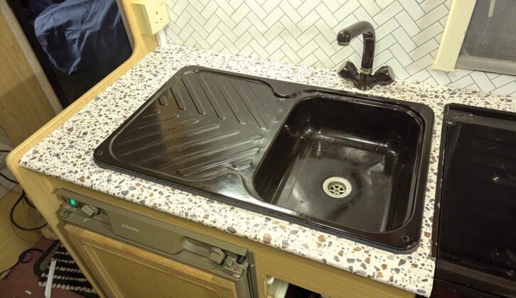

Final verdict
For an easy, cost-effective way to rejuvenate kitchen worktops, this is a great option. Replacing a caravan worktop is not really a practical proposition, unless you are a carpenter. It will also cost a lot more than £15.
Although this self-adhesive vinyl film is quite fiddly and time-consuming to fit, the overall effect is great.
Careful preparation, keeping everything clean and planning how to apply the film before sticking anything down are all essential for good results.
Time will tell how well the finish lasts, but there are few better ways to freshen up a kitchen for such a small outlay.
