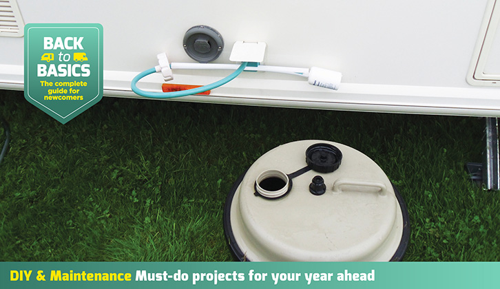

You know the problem. You drop your Whale external filter into your Aquaroll, trying to ensure that the filter unit on the end goes right to the bottom of the tank. That way, you don’t have to refill the water sooner than necessary. But often it feels as though the pipe is bending and not sitting as low as it might, probably because of air in the filter causing it to float upwards. Rod has a simple solution…
1 He uses Pipe Snaps – cheap, plastic sections of tube with a split down the side. These are designed to quickly and easily clip around 13mm domestic radiator feed pipes, to save you having to paint them.
Measure from the top of the filter to just under the filler neck, and cut a piece of Pipe Snap to that length.
2 Next, snap it over the Whale pipe, ensuring it butts right up to the filter.
3 This straightens the pipe and will keep it at the bottom of the barrel.
4 The pipe compresses and clips easily into the groove on the caravan end of the Whale filter unit, keeping it off the ground when you go to get water.
Note: Truma external pump owners can use a length of rigid plastic and cable ties to achieve the same effect.
