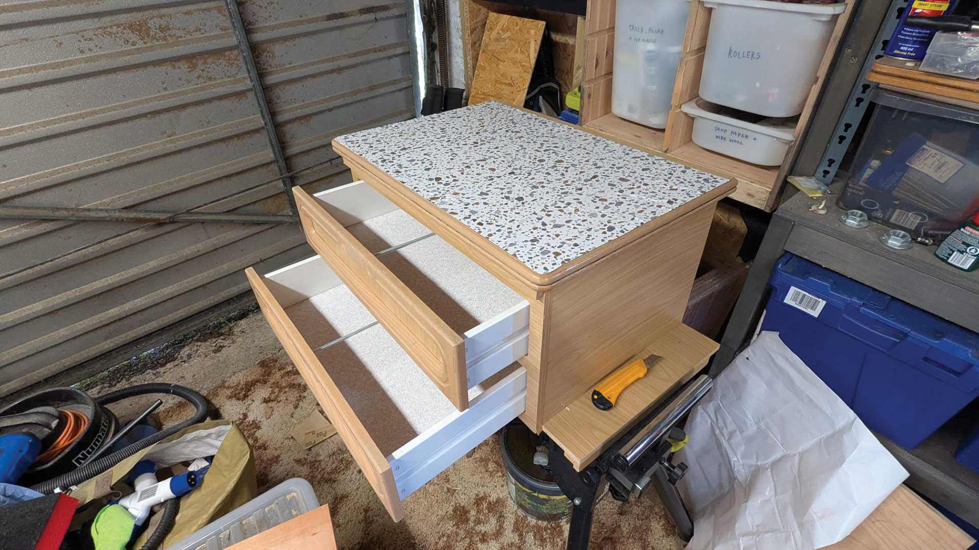

Like many mid-90s caravans, Penny has a central chest with an extending tabletop – and it has seen better days. The two drawers have developed saggy bottoms in their old age and now bind on the runners. There’s a dent in the top surface that’s hard to fix invisibly, and a bit of flappy veneer on the front face that’s easier to tackle – mainly because it’s hidden 99% of the time. The whole unit just needed cheering up.

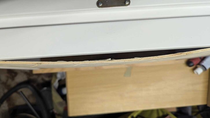

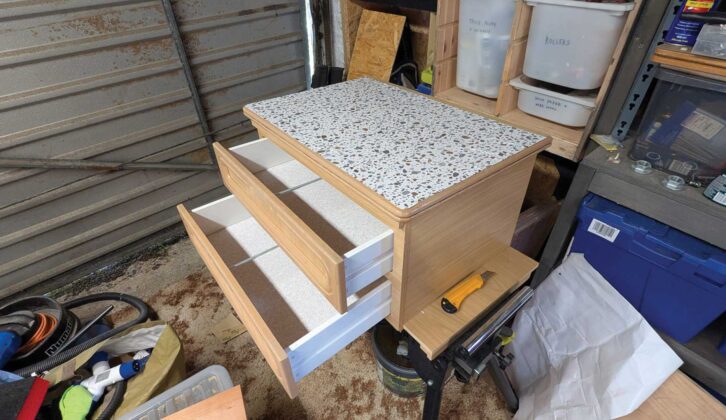

The problem with the drawers in my 1998 Bailey caravan was pretty simple. Over 25 years of service, the plastic sides had slightly distorted – probably a result of sticky runners making them harder to open. This allowed the plywood base to drop out of the support channel along the back, and this, in turn, caused the unsupported base to sag. Both top and bottom drawers had failed in the same way.
The base of the drawer was sagging

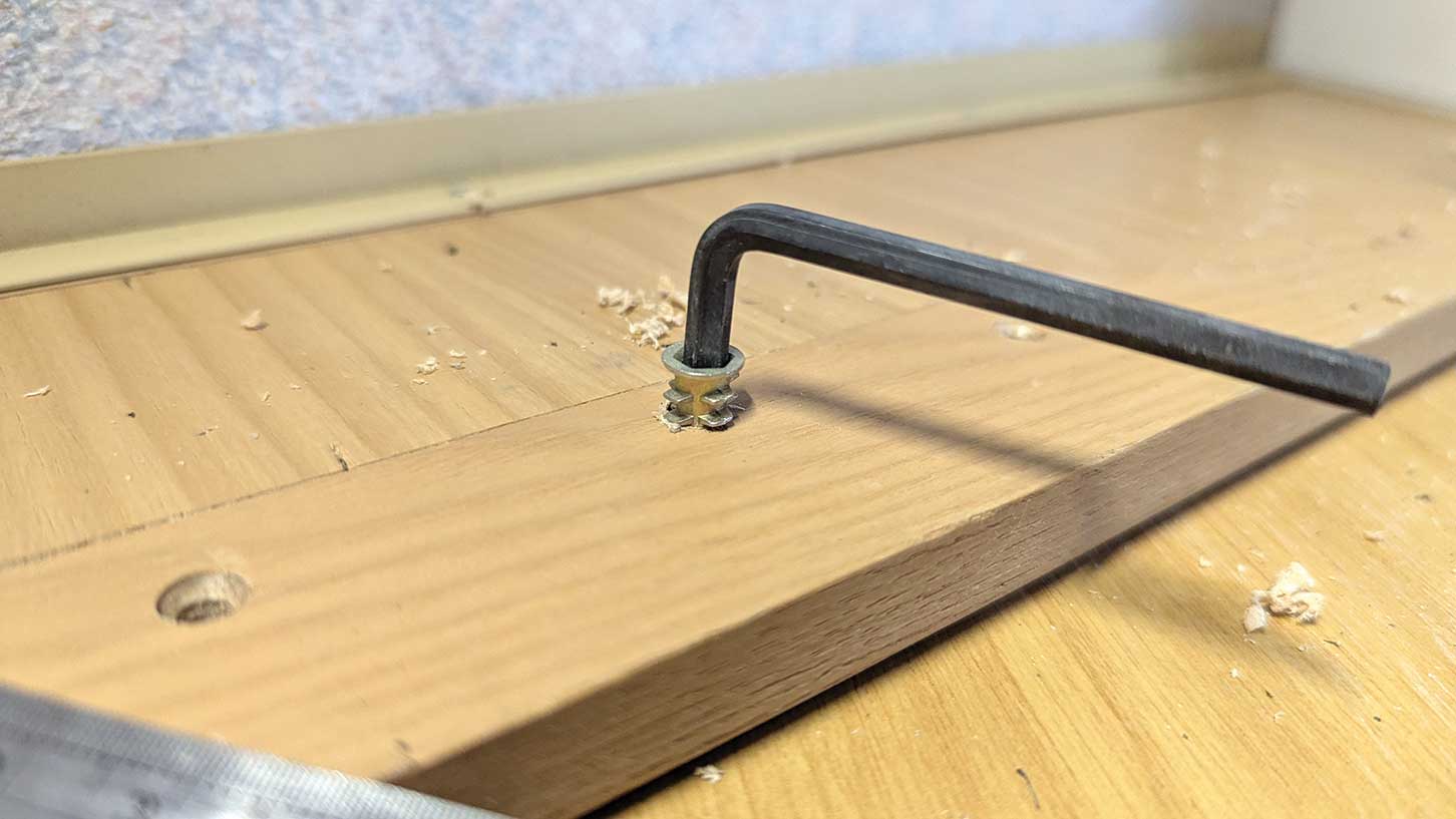

We considered glue, but didn’t trust it to hold long-term. Instead, we opted for something more mechanical. I picked up a length of 4mm threaded rod, nuts, washers and some threaded wood inserts. The drawer fronts are real wood, so they can hold a fixing.
Driving a threaded nut into the drawer front

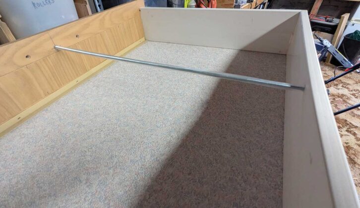

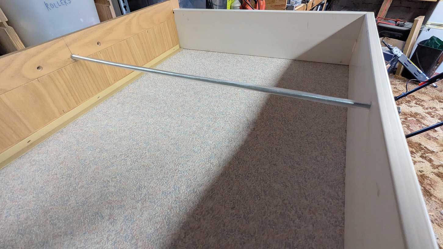

By fixing a small piece of threaded rod to the drawer front, and feeding it through a 4mm hole in the back of the drawer, I could pull the back of the drawer into alignment by tightening a couple of nuts on the threads beyond the drawer’s back panel.
First, I removed the drawer handle to make it easier to work. After a bit of measuring, I got my caravan tool kit and drilled a 7mm hole into the back of the drawer front and drove in one of the threaded inserts with an Allen key, making sure it lined up with the back panel.
The threaded rod
Threaded rod was passed to the back of the drawer and tightened to make it rigid
Then, after some more measuring to ensure good alignment front to back, I drilled a 4mm hole through the rear panel to be in line with the front panel fixing. Raiding my piles of useful rubbish in the garage, I found a length of car windscreen washer hose. This was perfect to slip over the threaded rod so we didn’t have sharp edges to snag items as they come in and out of the drawers. This was cut to length, and slipped over the threaded rod before fixing.
To pull everything square again, I ran the threaded rod through the rear hole, added a 4mm nut, and screwed the rod into the front fixing. Once it was in place, I marked the rod at the back panel, cut it to length with a junior hacksaw, then added a washer and a nut.
Tightening the nut pulled the drawer bottom back into its groove. Once the drawer alignment was nice and square again, I added a second nut behind the first to lock it all together, and a dab of thread sealant to stop it all popping apart in transit. We did the same fix on the other drawer too. The final improvement was a dab of furniture wax on the plastic runners. This meant the drawers now slide back and forth very smoothly once again.

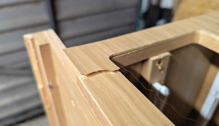

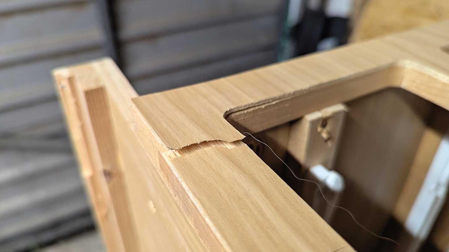

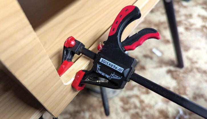

The final tidy-ups were all on the main centre chest cabinet. To fix the flappy veneer, we went for the simplest option. We mixed up some wood glue, squeezed it between the veneer and cabinet, and clamped it while the glue set. There was a slight rough edge where the split had occurred, but some careful sanding and a bit of furniture wax made it invisible enough for me.
The split veneer
Split veneer is easily fixed

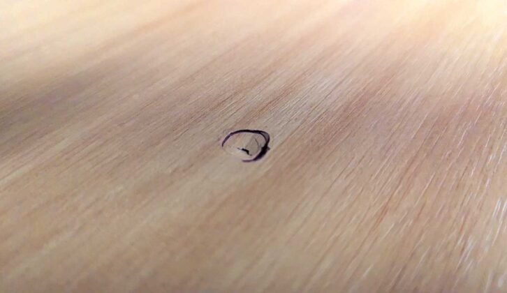

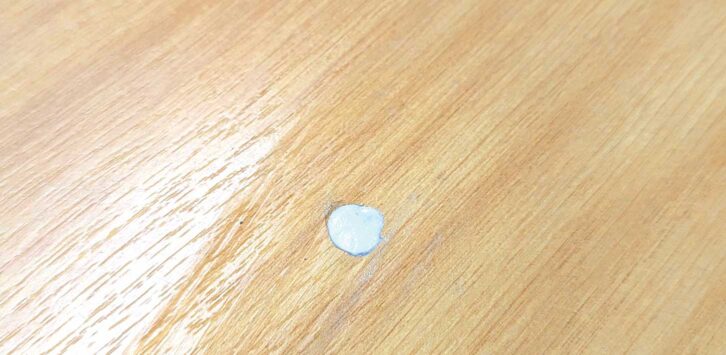

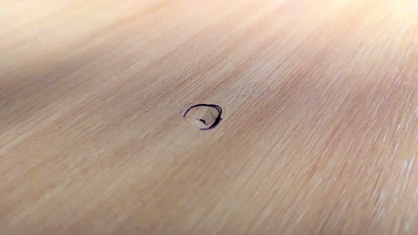

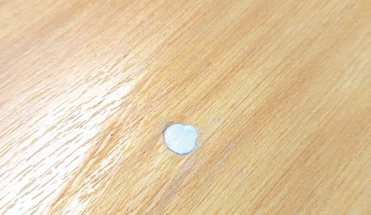

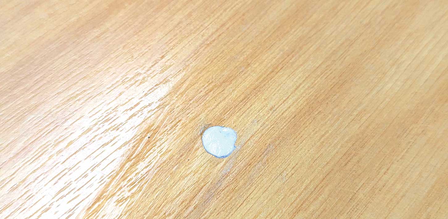

The final job was trickier. The two dents on the centre chest’s top surface weren’t going to disappear without a visible scar, so we chose to disguise it instead. I filled it with the same flexible filler still knocking around from the earlier job.
The dent in the drawer
The dent
Dent was filled flush
A light rub-down gave us a smooth finish. Then we covered the surface using leftover film from last year’s worktop refurb. This is sold as a worktop covering vinyl, is very hard-wearing and available in pretty much any finish you can imagine. It is self-adhesive so as long as the surface is dry and clean, the backing paper can be peeled away and the film firmly pressed onto the surface.
A small squeegee is ideal for ensuring there are no bubbles and a flat surface is achieved. We trimmed the edge with a craft knife and our budget cheer-up was complete.
Once trimmed neatly with a sharp knife, the result was a marked improvement.
