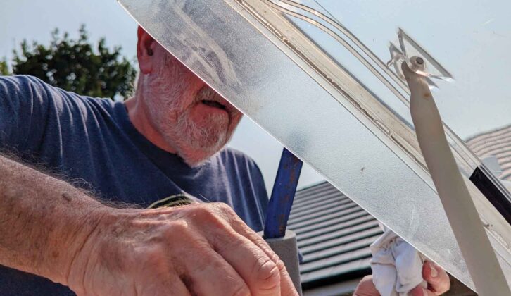

The previous owner did a pretty thorough job of cleaning the old sealant. That said, the bedding mastics used in vans are pretty resistant to removal, so before starting work, it still took an hour or so of detailed cleaning to remove every trace of the old stuff – vital to ensure a leak-free install.
We used white spirit to soften the sealant, and a small metal scraper to shave the remnants off the mounting plate. For the tight areas, we used lint-free cloth and electrical screwdrivers wrapped in paper towel. Then the whole surface was wiped in acetone to get rid of the oily residue from the white spirit.

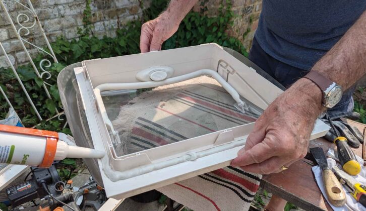

Helpfully, the Mini-Heki has a channel moulded into the base. This is ideal for putting a good thick bead of bedding sealant into, before fitting it to the caravan roof, and that is exactly what we did.

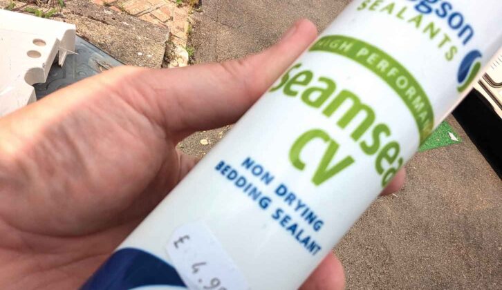

We got a tube of Hodgson’s Seamseal CV for the job. This was available on the shelf at our local caravan shop, Reading Caravans & Motorhomes, and at a fiver, I didn’t think it was a bad price, either.
Applying the sealant
We cut the end off the nozzle to provide a good thick bead of around 8mm. We had the Mini-Heki upside down on the bench, resting on a soft surface to avoid scratches. I started in the middle of the back edge, putting a generous, continuous bead of sealant all around.
I asked Sam to hold the vent still while I worked, and also to carefully turn it when I reached the corners to ensure a nice even bead all the way around.
It is essential that there are no gaps in the bead, and that it is thick enough to protrude above the sides of the channel. This will ensure that the bead contacts the roof properly and is compressed when attaching the base of the plate inside.

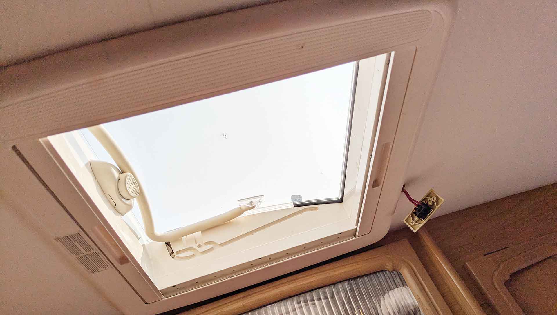

The final task is pushing the integrated blind into place. The blind is attached to the inner frame using barbed clips and needs lining up, then a firm tap with the flat of your hand all round to push it into place. That finished the inside work.
Outside, we looked at the roof, smoothed off any sealant that had oozed out, and that was it: job done.
One small task remains. The switch for the old extractor fan fouled the edge of the rooflight. We’ll need to isolate the cabling and tidy up the ceiling when we tackle those lighting issues.
