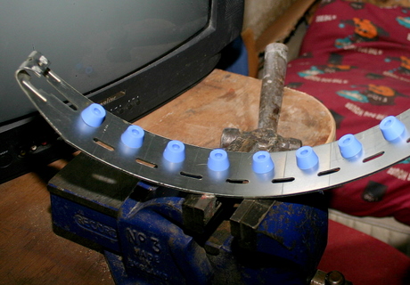

4. To keep the Bands at the correct height from the base of the well, studs are fitted to space the band off the wheel rim. Each one is knocked through the hole using a small hammer.
