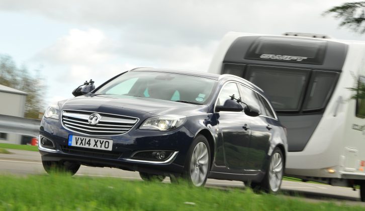

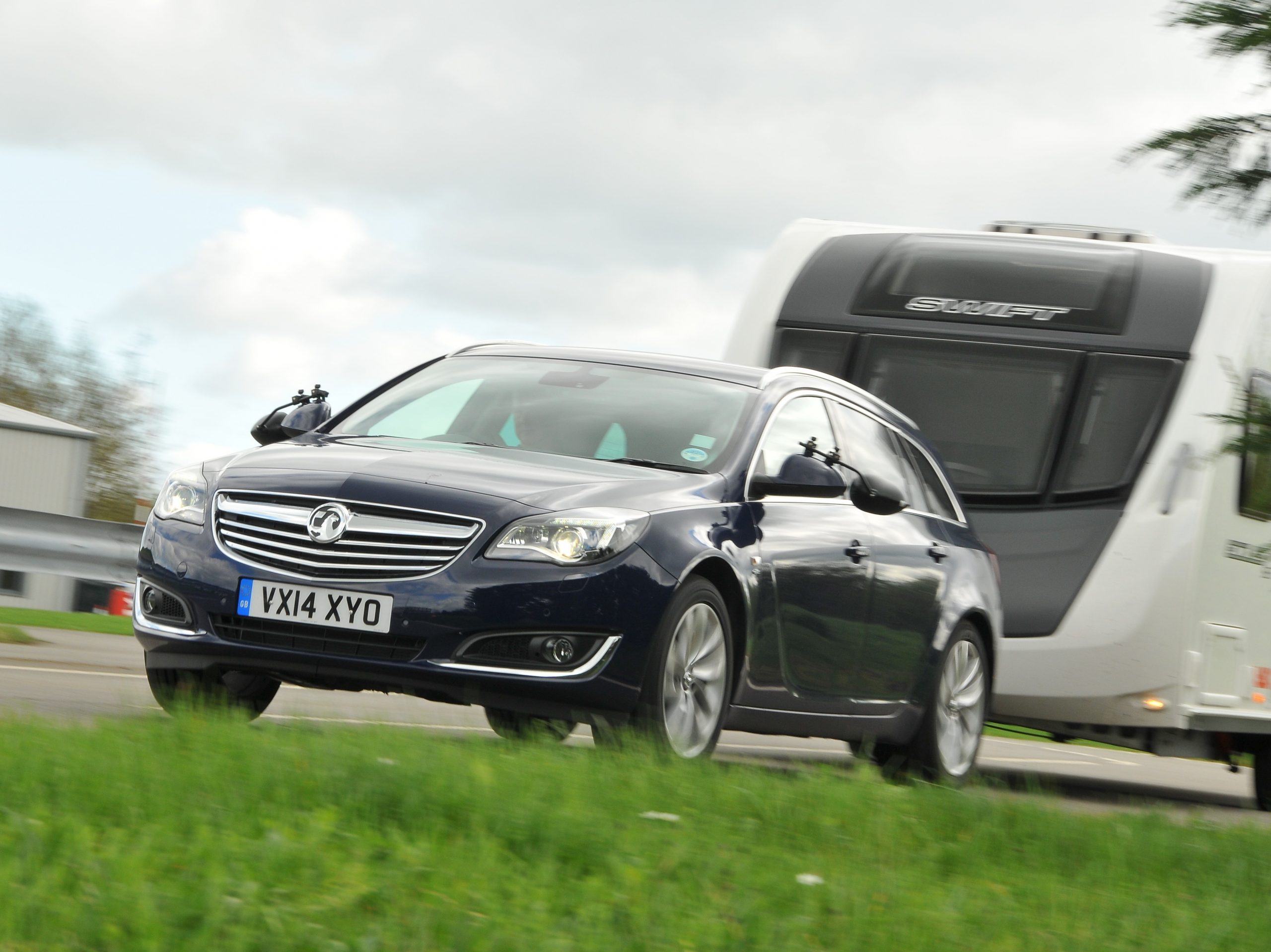

As if that wasn’t enough, certain manufacturers (I’m looking at you, Vauxhall) have a habit of not publishing the kerbweight in their brochures at all, making safe and sensible matching of car and caravan unnecessarily difficult.

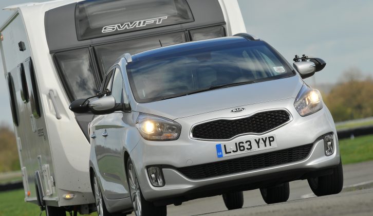

Some car makers, including Kia and Nissan, quote a range of kerbweights for the same model, depending on spec. I’m not talking about different weights for the same car with various engines and gearboxes, but a range of weights depending on whether or not you go for that full-length sunroof or the all-singing, all-dancing in-car entertainment system. So which weight should you use when deciding whether a car makes a suitable match for your caravan?
I’d be inclined to use the lower of the two, even though the chances are your car will weigh more. Better to be cautious than to underestimate the matching ratio and buy an unsuitable car.

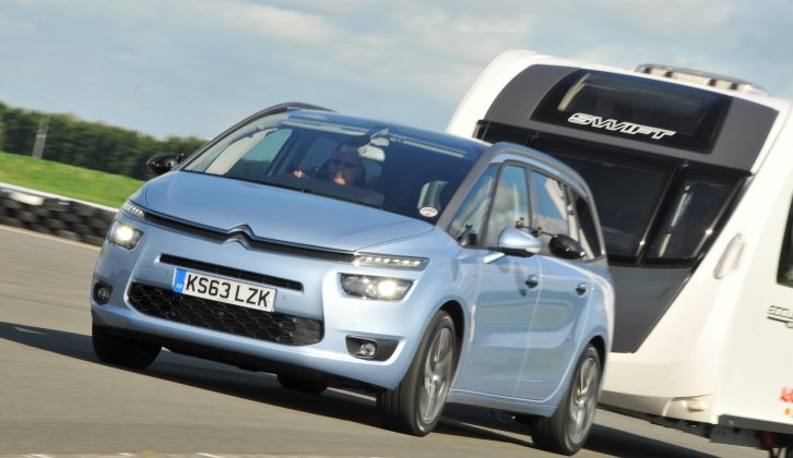

The Citroën Grand C4 Picasso HDi 150 is a good example. The brochure says the legal towing limit is 1700kg. Load the car to its gross vehicle weight, and the towing limit effectively drops to 1400kg.
That doesn’t make it a bad tow car. In fact, it’s a very good one. But at best, this way of presenting the legal towing limit is confusing. At worst it is downright misleading.
