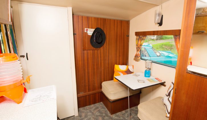

“We managed to keep the original sprung interior cushions, and we re-lacquered the factory linoleum and re-varnished the woodwork,” Cam says.
The caravan’s layout is quite unusual, but really practical. This four-berth van appears on first inspection to have just one make-up double.
The second double bed is disguised against the front wall, with a magazine rack that doubles as the corner leg once it is folded down. It is a great way to have a bed that is ready for you to fall into at the end of a long day without sacrificing precious floor space. There are straps to hold your bedding in place and, for safety reasons, it is lowered in transit.
