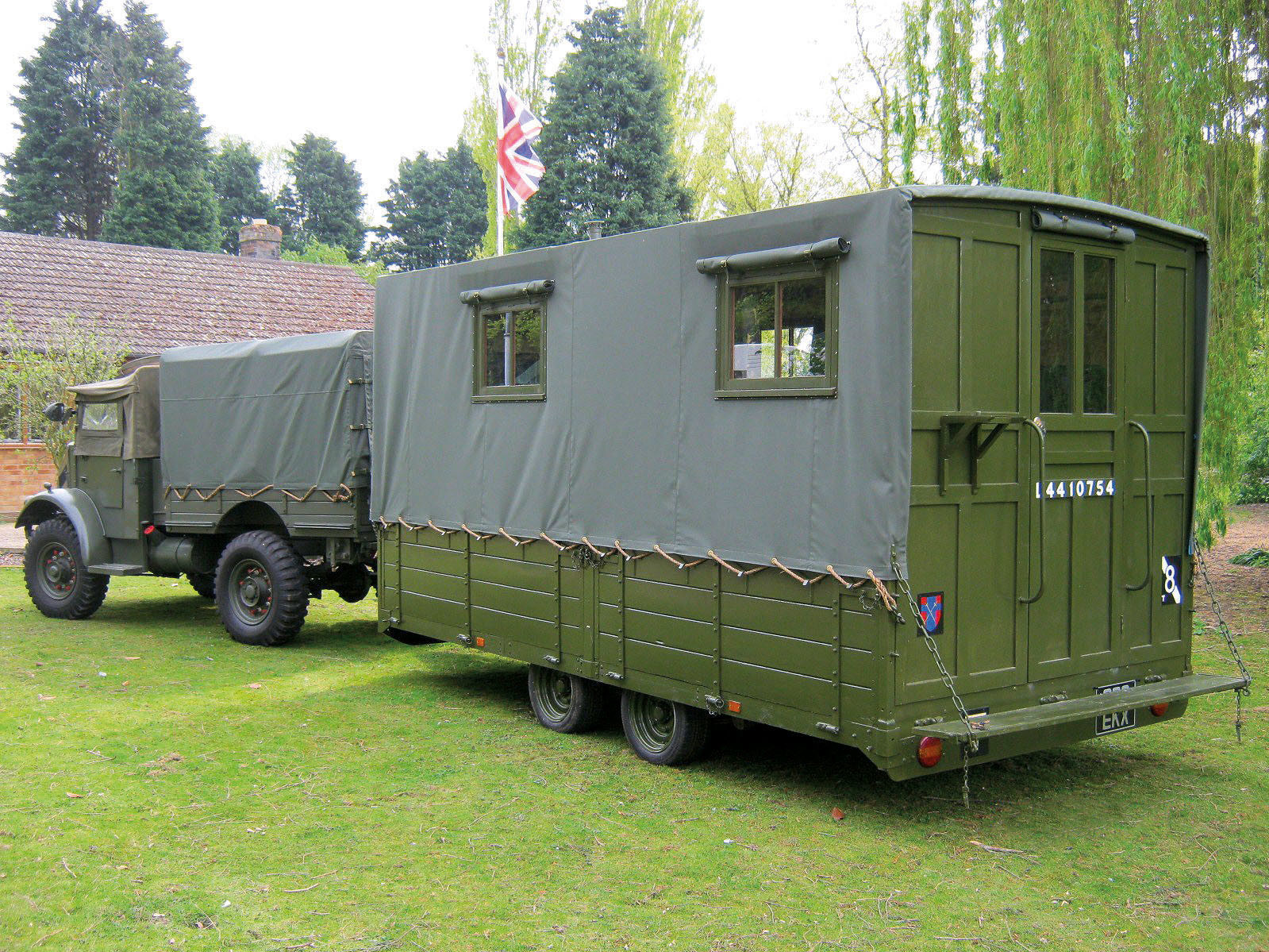

Paul’s recreation is based on a 14ft Ifor Williams trailer, using a Bedford army lorry hardwood dropside body – and his old Coachman as a donor for many of the interior fixtures and fittings: “When designing the van, I wanted it to give the impression that it was mounted on the back of a lorry, hence using the Bedford dropside body at the bottom. Next, it had to have a canvas top that was roped down to the body, and above all it had to be built on a very reliable base. That was where the 3.5-ton IW trailer came in.”
Both the trailer and the donor Bedford were bought via eBay – a handy source for several parts of the build. Other eBay finds included a new gas hob, after the original unfortunately had to be replaced because of leaking behind the control knobs, and a drop-down sink that has been installed in the washroom.
“I started the build in my workshop,” recalls Paul. “My son, Stephen, is a fully qualified welder, so I asked him to weld a 44mm box-section steel frame onto the trailer. We then bolted 40mm square timbers to the steel and filled the gaps between with Celotex insulation board, then covered the inside with tongue-and-groove boards. The outside was clad in aluminium sheeting, with canvas on top.”

Paul fitted blown-air heating, a water tank and water heater, a Thetford cassette toilet, a refrigerator, a kitchen sink plus an oven and a hob, many of these parts coming from the donor Coachman VIP. The gas system was then tested by a friend who is a qualified engineer.

The caravan is 14ft long, plus the A-frame, and 6ft 8in wide, but is fairly easy to tow: “It’s 2500kg and doesn’t sway very much, but the Morris Commercial only travels at around 50kph [about 30mph], which makes me very unpopular on the roads! Also, with something as old as the Morris, breakdowns are a very real risk, so we stick within a 40-mile radius of home.
