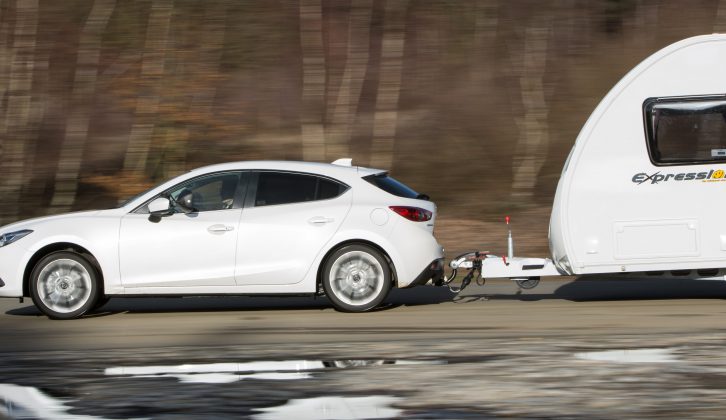

If they take a belts-and-braces approach to outfit matching, owners of 2.0-litre petrol powered Mazda 3s will need to choose their caravan carefully. With a kerbweight of 1355kg, the 3 has an 85% match figure (as usually recommended for secure and stable towing) of 1152kg. For more experienced drivers happy to tow heavier caravans, the legal towing limit is 1300kg.
Our experts matched the Mazda to a Swift Expression 514 with a Mass in Running Order of 1256kg. It’s worth noting that this caravan wouldn’t make a legal match for the Mazda if fully loaded.
Most of Practical Caravan’s team tow with diesel cars, so our reviewers needed to change their driving style to tow with a petrol. Whereas a diesel pulls strongly in the middle of the rev range, petrols generally need to be revved higher for good performance. That means more frequent gear changes and a heavy right foot.
Just a mile or so after collecting the Swift from Michael Jordan Caravans, our testers towed up a long hill that they typically tackle in fourth gear driving a diesel. In the petrol Mazda, they soon changed down to third, and were in second gear by the top in order to hold speed.
That’s not surprising when you consider that the 2.0-litre has a modest 155lb ft of torque, available at 4000rpm. To be fair to the Mazda, the testers were pulling a heavier caravan than most owners would match to a car of this weight and performance.
At the test track, the Mazda 3 showed that it’s up to the job of towing so long as the driver is prepared to work the gearbox. The Mazda pulled from 30 to 60mph in 14.4 seconds, a much quicker time than they’d expected, given the sluggish response while driving uphill.
The engine is less flexible at low revs, though. Our reviewers usually record a 50-60mph acceleration figure in fifth gear, but the Mazda ran out of straight before it reached 60mph. In fourth gear it took 17.9 seconds.

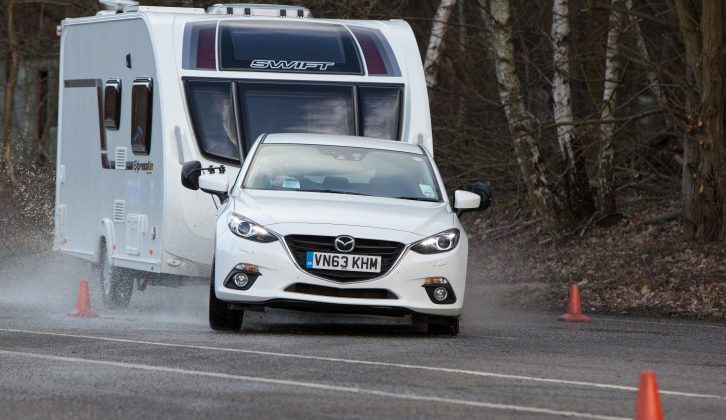

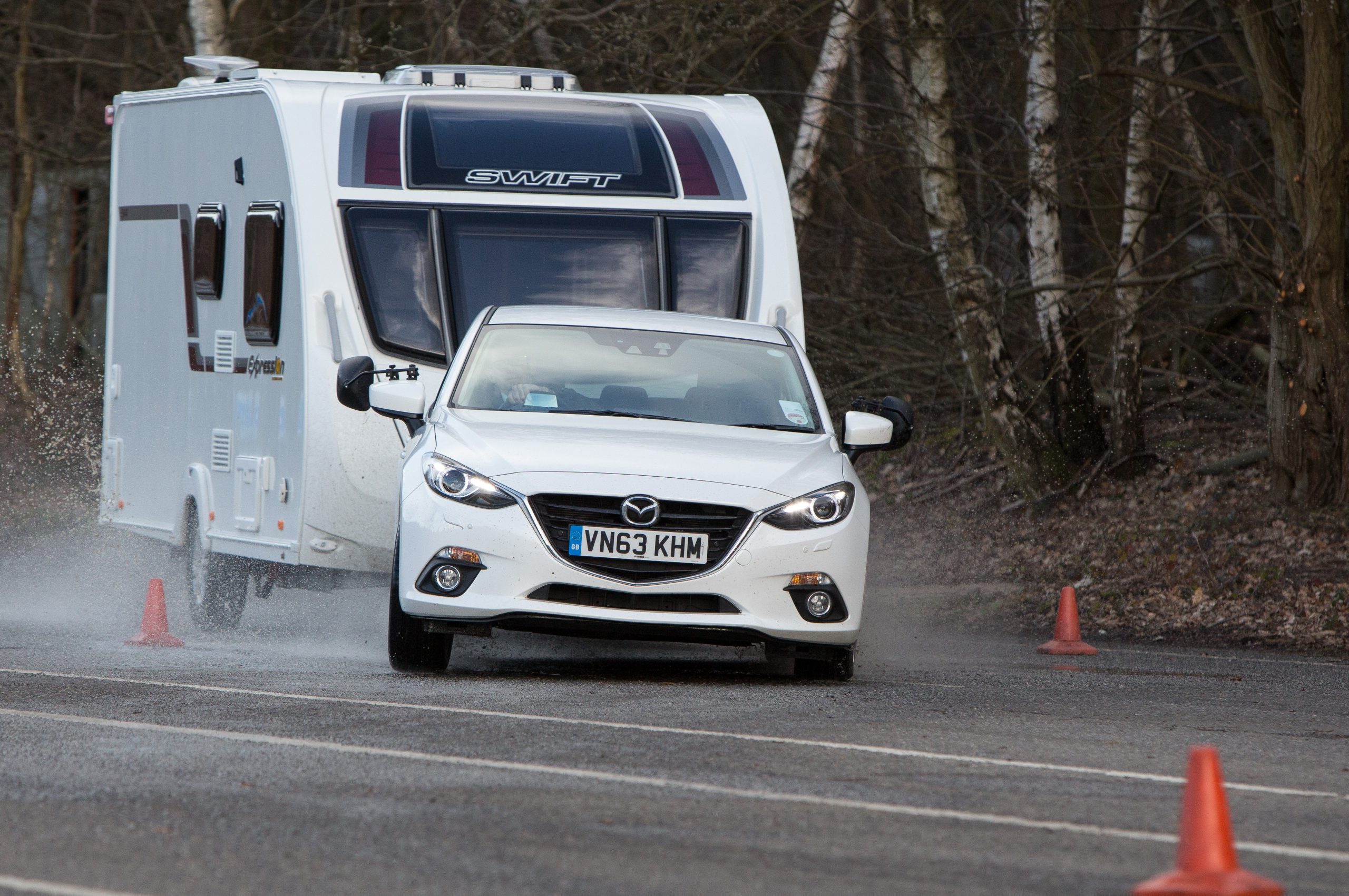

Otherwise the 3 proved itself to be a good tow car. Once up to speed, it remained stable and steady at the motorway limit, despite pulling a 93% match. Through the lane-change test, the 3 was unperturbed by having such a big van behind it, changing direction quickly, steering with precision and gripping well.

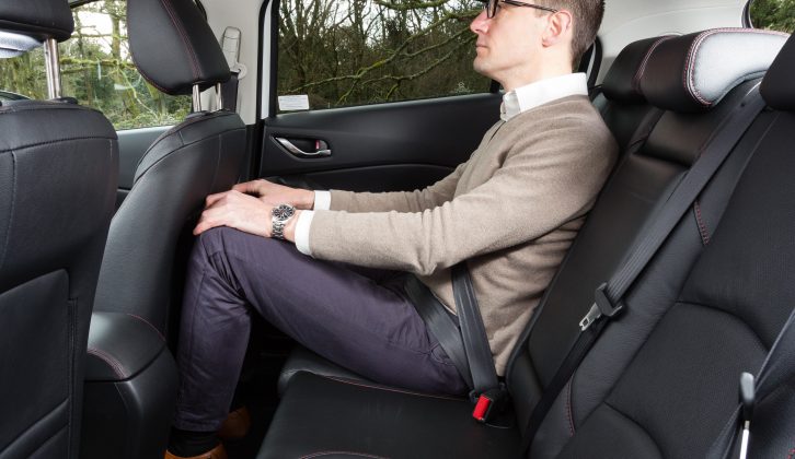

In the back, head and legroom are average by class standards, and the upwards slope of the window line and thick rear pillar can make passengers feel a bit hemmed in. There’s also a pronounced hump to the middle of the floor which makes the Mazda 3 better suited to carrying two in the back rather than three. What’s more, there are no air vents in the door pillar or between the front seats to help keep rear-seat passengers cool.
