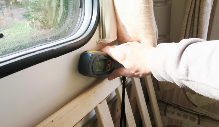

All doors, windows and blinds are assessed for smooth operation. General observations are made of the entire bodywork and this includes a visual inspection of the roof. A damp check is carried out around the inside of the caravan. If the reading on the damp meter is between 0-15%, then there are no concerns. However, if the reading is between 15-20%, then it will require further investigation and a re-check within a three-month period. If the reading is more than 20% then immediate attention is required because this highlights an area of water ingress. The service technician should give you a Damp Report at the same time the service is carried out.
