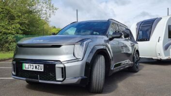

The first question, then, is choosing the right tow car engine. Very soon, new electric vehicles (EVs) will be mandatory. Battery EVs – in my opinion, a technical cul de sac – will be enforced initially, but their current towing capacity is so poor and its effect on range so catastrophic, we will leave them aside for now.
