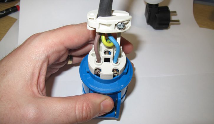

The best solution is to detect the suspect supply and correct it. To cope with all eventualities, you need a spare continental adaptor which you can convert. Carry it with you to the continent and use it if required.

- It can be corrected with a simple home-made adaptor
