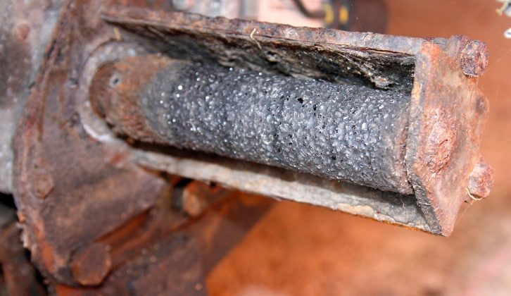

Clean the rollers using a wire brush. The rollers will need to be rotated, using your remote control, so you can clean the whole surface.
You can be quite brutal when brushing, as it will expose any places where the original gritted area has either come off or is loose.
Thankfully, in our case neither applied, but the surface must be free of rust or dirt before being regritted.
If you do find any areas of bare metal, the company recommends cleaning with emery paper or wire wool to help ensure a good key for the treatment.
If the surface isn’t cleaned in this way, it’s likely that the first time you need to use the mover, much of the newly gritted surface will break up and drop off, so the whole exercise will have been a waste of time.

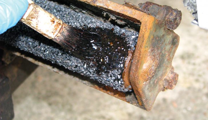

Place the plastic sheet that is provided in the kit underneath the roller that you’re going to be dealing with first, and then paint the resin mixture onto the roller surface, ensuring the whole surface is covered.
It needs to be thick enough for the grit to stick to, but not so thick that it runs.
Again, use your remote control to rotate that roller.

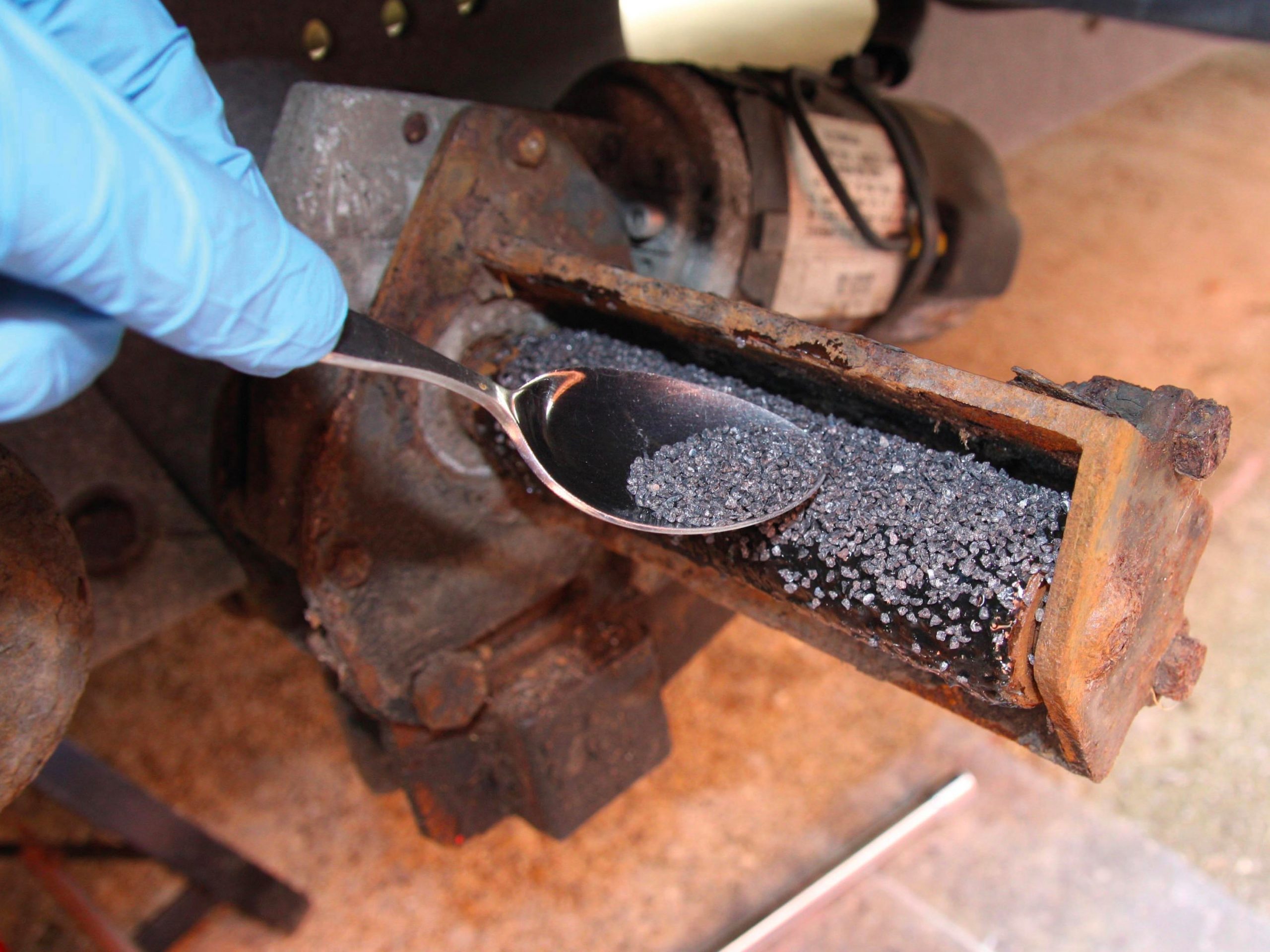

With the roller covered with the resin mixture, you pour the grit onto it.
We found that using a dessert spoon to pour the grit on worked well, because it gave better control of the amount poured (and was probably not as wasteful as simply pouring from the bag).
Again, cover the whole surface, using the remote control to rotate the roller as needed.

Once you’re happy the rollers have been adequately covered, and they have dried, you’ll need to mix more resin and hardener (in the same quantities as before), then paint over the whole gritted area on each roller with the mixture.
