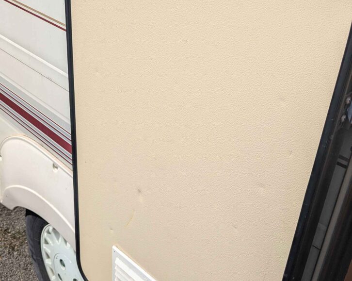

1. A lovely blank canvas, or a wasted space, depending on your point of view. Many modern caravans have a smart moulded bin on the door and we thought we could do something similar.
The caravan door as it was before

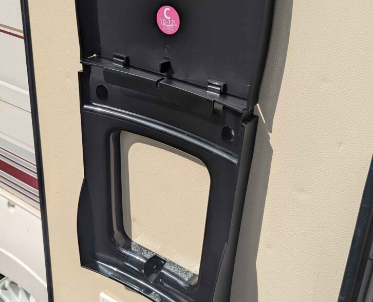

2. The Brabantia 10-litre door bin comes with screws and three mounting holes. In order to ensure we got the door level and centred, we placed it with sticky pads on the door. This allowed a little fine-tuning.
Getting the mounting of the door bin in position
3. With the position set, we used the supplied self-tapping screws to finally secure the frame to the door. The sticky pads are probably sufficient, but for complete security when the van is bouncing down the road, the screws are valuable insurance.
The bin, secured to the door

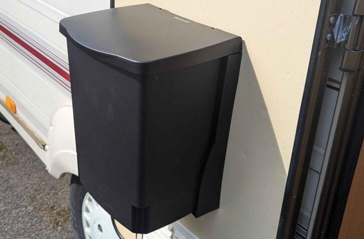

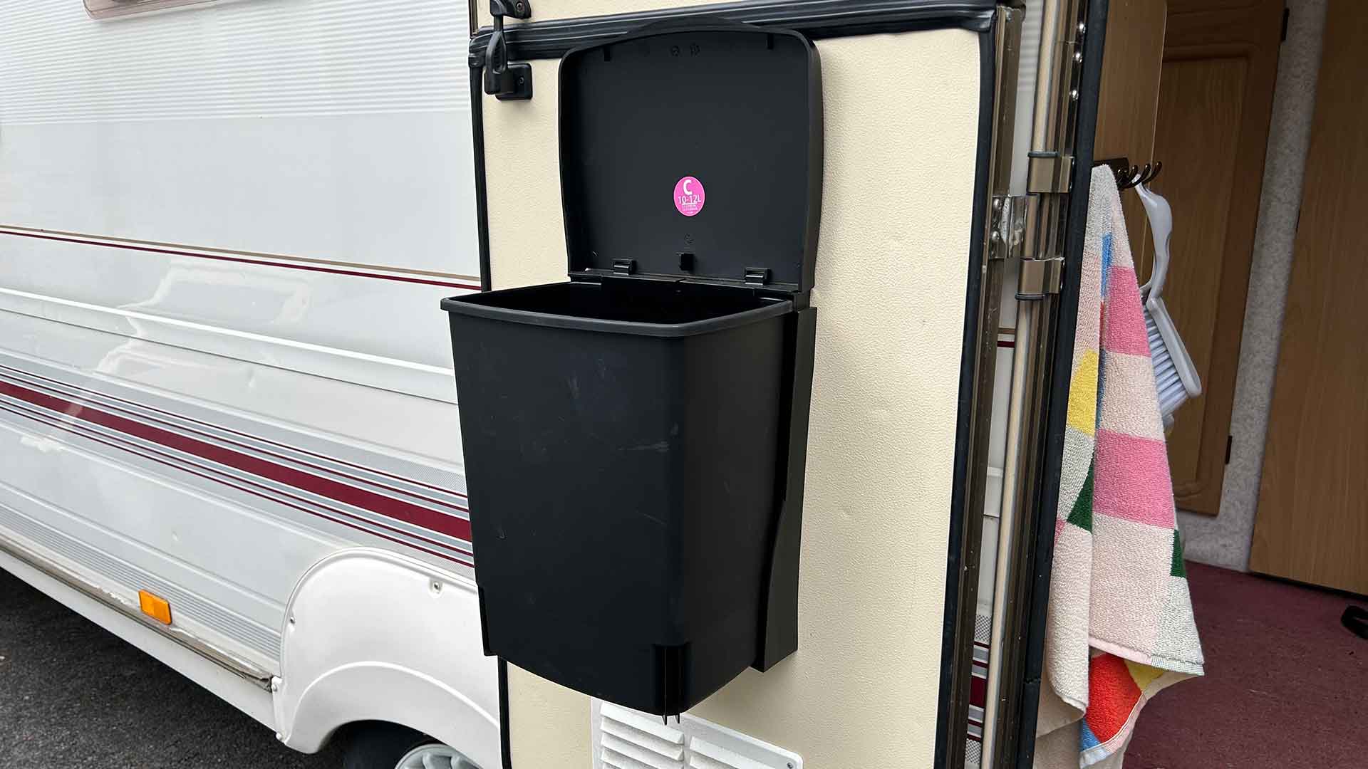

4. The new bin works really well! The actual bin receptacle locates in the frame and is held in place with small tabs, and the lid stops it popping out. Brabantia sells 10-litre bin bags to fit, so we have added a supply of these to the van.
The bin in use
