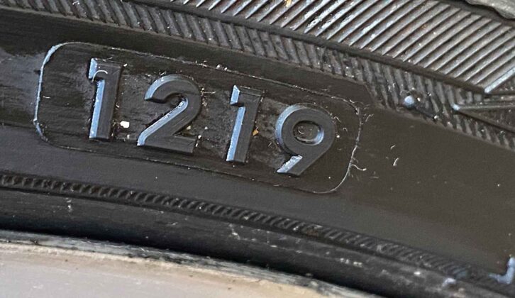

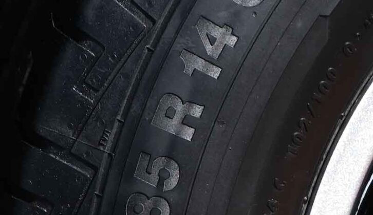

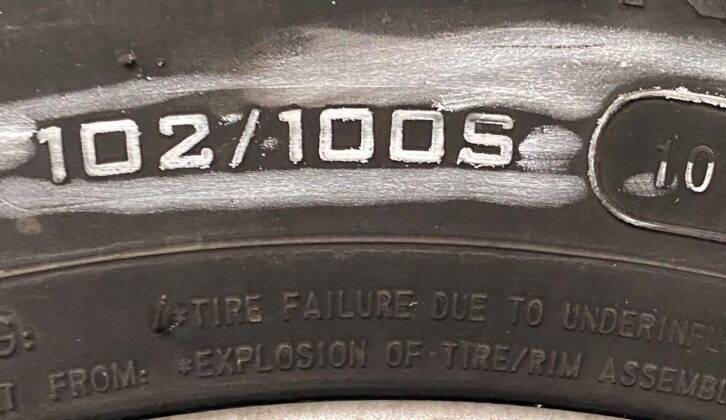

This is easy to do by reading the characters on the sidewall. These number and letter combinations reveal its age, size, profile and tread type, and whether it’s a run-flat tyre (take a look through our gallery at the top to see the different characters you will need to decode).
A tyre with the number '12 19'
This number indicates the tyre’s age. This tyre, for example, was made in the 12th week of 2019

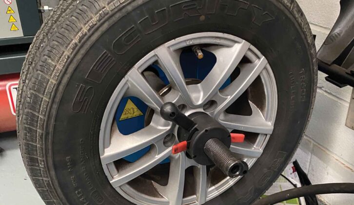

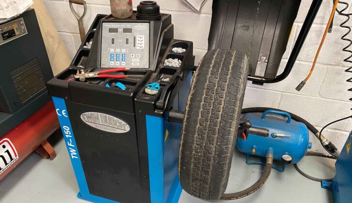

2. Balancing your wheels
In recent years, many manufacturers have stated that their caravan wheels and tyres should be balanced. Some caravanners did this anyway, but now some of the best makes of caravans, such as Elddis, Swift and Bailey, are recommending it. In theory, this should give a smoother tow and reduced wear, as the forces an unbalanced wheel and tyre place on a hub at speed are incredible and create potentially damaging vibrations in the caravan chassis.
Wheel balancing a tyre
Wheel balancing for caravan tyres is increasingly common

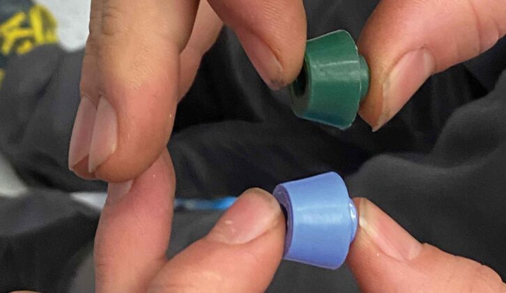

To buy and fit Tyron bands costs from around £90 per wheel. “Dealerships, independents and firms like Kwik-Fit will fit them,” says expert caravan technician David Hayes, at Out & About Motorhome & Caravan Services. “It’s crucial to buy the right ones as there are caravan-specific Tyron bands. Your fitter will love you if you get it right, as almost all the ones that we fit are made for cars, which are much harder to install.
Tyron bands
Tyron bands for caravans have green spacers and are easier to fit
“Normal vehicle bands have blue plastic button spacers, but caravan ones are slightly smaller and are green. This makes it easier for the technician to fit them; the 2-3mm differential makes life much easier. You can buy bands direct from Tyron. Ideally, you’ll need to know your wheel rim diameter and internal wheel-well width. But Tyron staff know their stuff and know the fitments for most vans.”
