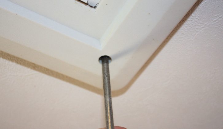

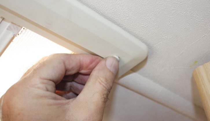

Working inside the caravan, prise out the four small screw caps (one at each corner, if fitted) from the inner trim, then remove the four screws that hold the trim in place. In our example (pictured right), this piece contained the blind and flyscreen, so if you’re planning to reuse them it’s worth giving them a quick clean.
With the inner trim removed, you’ll see the four metal clips that hold the unit in place. Release the clips by unscrewing each of the screws. These don’t need to be removed completely, but they do need to be loose enough so that you can turn them out of the way.

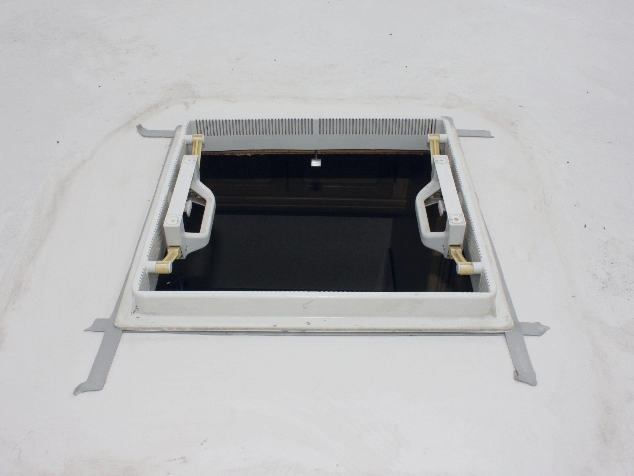

Once you’ve got there, you should break the mastic seal by working your way around the base of the rooflight assembly using a wide, flat blade. However, you must be careful not to damage the roof. Even after 16 years, the mastic on our van was surprisingly supple and grippy. Rather than over-stretching, I released one side then worked on the other from the opposite side.
Once the seal has been broken all the way around, the rooflight unit should simply lift out of the way. They’re quite light, so shouldn’t present any problems. If there is any resistance, make sure that all of the seal has been broken, or ask an assistant to check that the clips inside the van haven’t turned around.

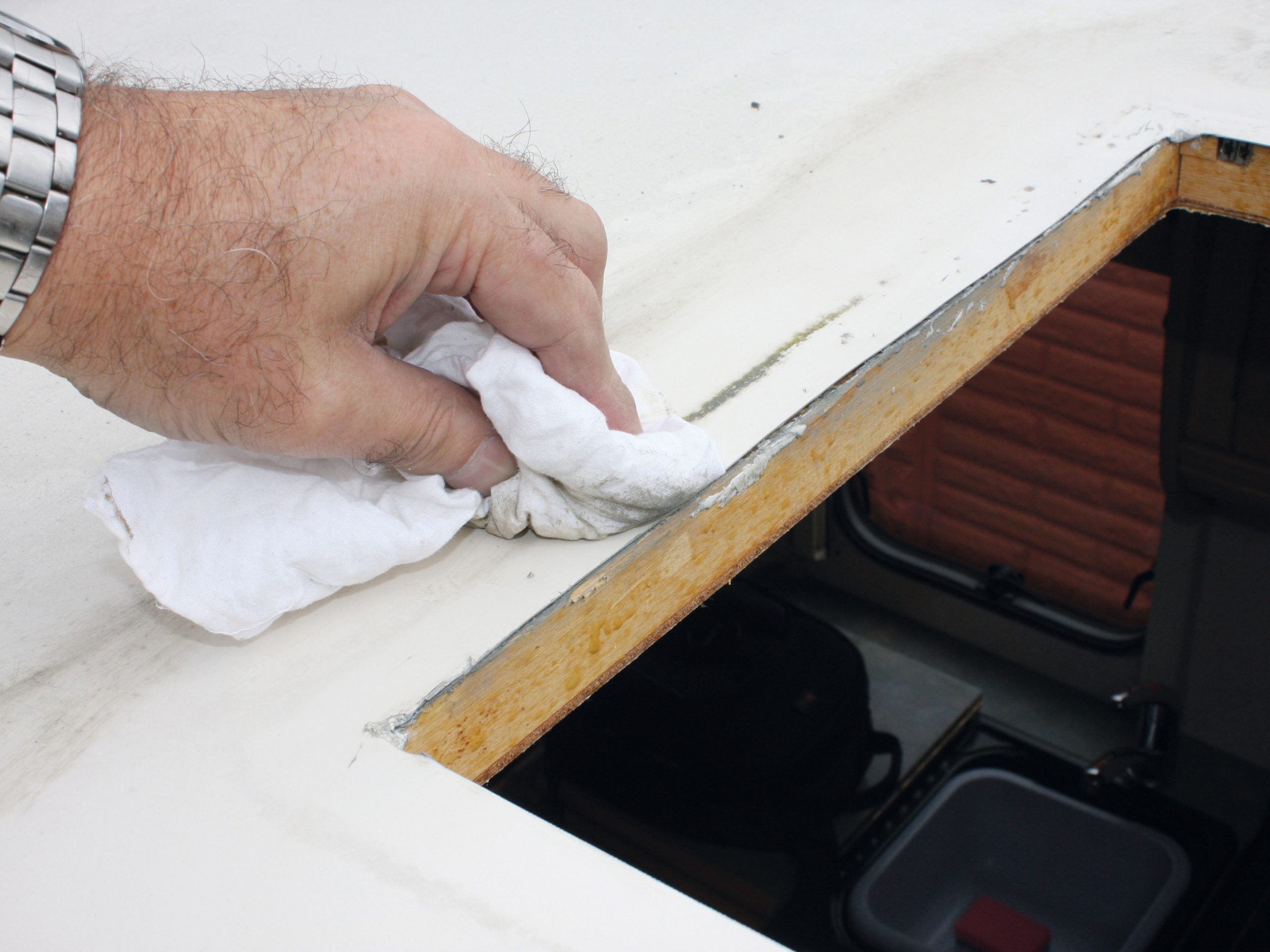

With the rooflight out of the way, remove all of the old mastic. I used a wide metal wallpaper scraper, but be very careful not to damage the roof. I was able to remove some of the mastic by hand, too. Once this has been done, thoroughly clean around the sides with white spirit, and ensure that none of the old mastic remains.
Once you’re happy that the roof is clean enough, cut four lengths of the new mastic sealing strip and place them along the edges of the rooflight aperture, overlapping the corners; make sure that there are no gaps underneath where the strips overlap by pressing one strip onto the other. Next, check that the new rooflight is clean where it sits on the roof (ie remove any old mastic and so on), then place it into the aperture, pressing the edges — and particularly the corners — into the mastic sealing strip. However, be careful not to press so hard that it cuts through the seal.

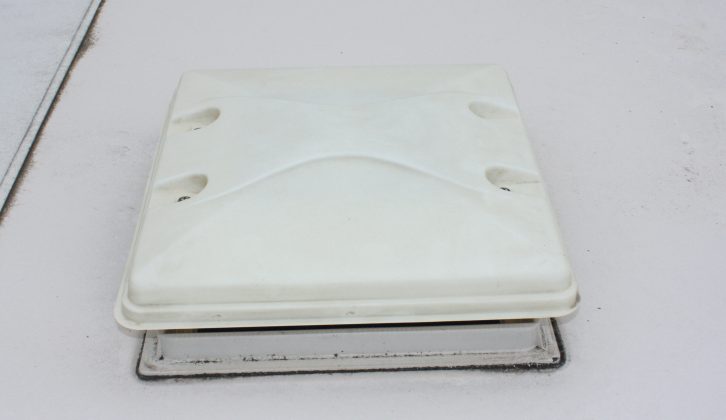

How to dismantle and clean your rooflight
If the original rooflight is in perfect working order but simply needs a clean, it’s a very simple task to remove the covers so you can give it a good clean. It doesn’t matter whether the rooflight is open or closed for this.
Working outside the caravan, remove the four screws that secure the covers to the handles. Ensure that you retrieve both the screws and washers.
With these removed, the covers should simply lift off. Take care to get hold of both parts (particularly if there’s a breeze!) because they’re very light. Also, be sure to retrieve the four rubber washers between the lower side of the covers and handles – these are the main seal.
You’ll now be able to access all areas of both parts of the rooflight, so you can give them a clean with soapy water. (We have reviewed a selection of caravan cleaning products here.)
Despite the fact that these rooflights had never been cleaned before, the grime came off quite easily. A small brush helped us to access the gaps between the vent slots.
Once you’re happy that the parts are no longer dirty, you can reassemble them. Make sure the four black rubber washers are correctly seated before you replace the covers. After carefully putting the covers in place (so as not to disturb the rubber washers), replace the four screws and their washers. Nip up the screws, but don’t over-tighten them or you could damage the covers and threads.
