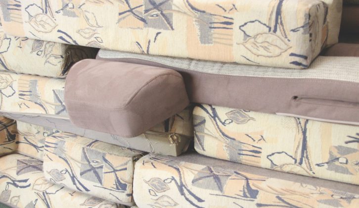

Remove the upholstery
For storage during the winter, consider removing the upholstery (seat bases and backs) from your caravan, and storing them somewhere warm and dry in your home.
Not only will this maintain your furnishings in excellent condition, by avoiding lengthy periods spent in a cold/damp environment, but it will also make your caravan far less attractive to potential thieves.
If you do this, leave a blind open so thieves can see that they’ve been removed.
Consider leaving mattresses upright, for maximum airflow all around.

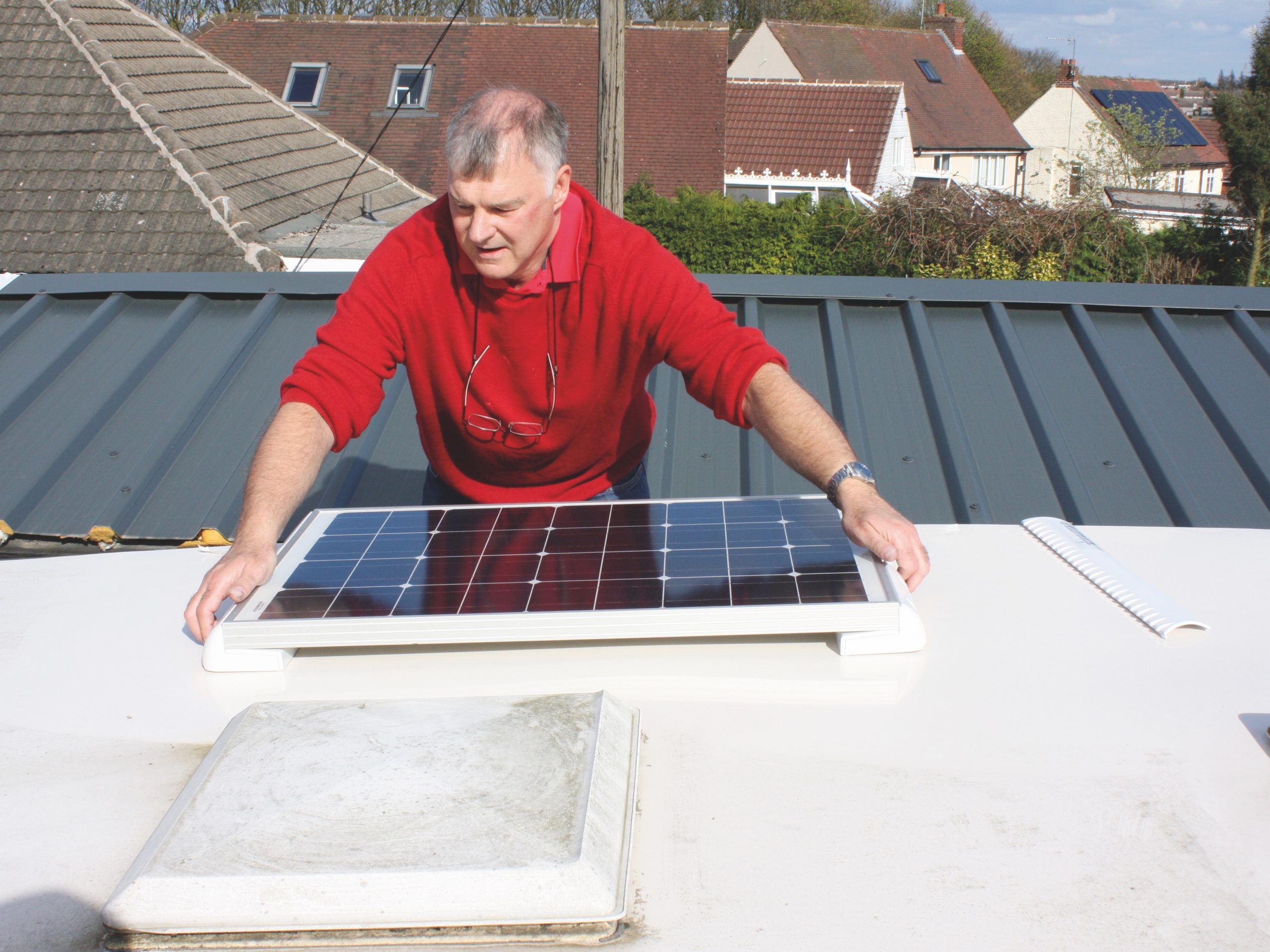

The other alternative method is to fit a solar panel, which will trickle-charge the battery over the winter months.
Remember, a power source will be needed if you want your alarm and tracker to continue functioning long-term.
