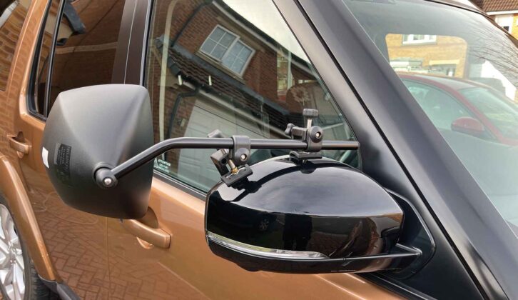

Your towing mirrors will need to be adjusted individually – this is one of those jobs that will be much simpler to tackle if someone else can move them as required, allowing you to sit in your usual driving position and judge the image. Make sure the tourer sits in as straight a line as possible behind your towing car too.

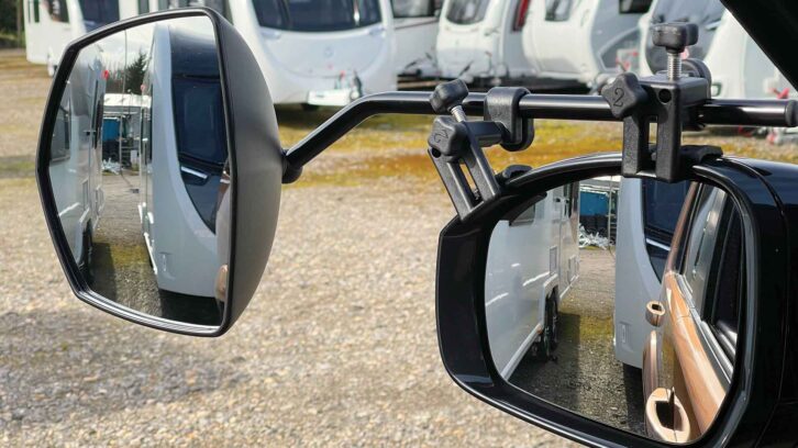

To begin, you should ensure your tow car’s wing mirrors are adjusted appropriately. You’ll know when you’ve achieved this because you will be able to see the car’s front door handle in the near bottom corner of the mirror.
A car's mirror and a towing mirror
Now that you’ve done this, get your towing mirrors and attach them. Swivel the head horizontally until the caravan can only be seen in the nearest 6mm of the mirror – by the time you achieve this, you will most likely not be able to see the car at all. However, doing this will ensure you can see along the side of your tourer and behind it.
Your tourer’s grab handles should be in the middle of the near edge of each mirror, while the wheel arch should just be visible at the bottom of the mirror. To achieve this, you may need the mirror head tilted up or down as required, but once you’ve done so, you will have a good balance between what is coming up behind you when you’re towing and also allowing you to see your wheel arch when you’re reversing a caravan.

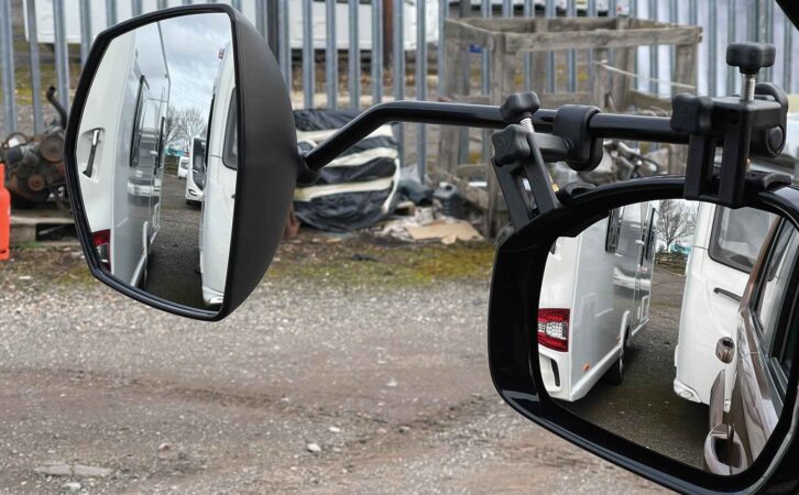

A common mistake can be to adjust your mirrors to ensure you can see your van. However, you should actually be using them to allow you to see the road behind your tourer.
Another error that is commonly seen is adjusting the mirrors to see your tourer’s wheels when reversing. However, so long as you have adjusted the mirrors correctly, you should still be able to reverse without having to alter them specifically for that purpose.
Each mirror will need adjusting individually
Don’t use unmatched mirrors either. This is because different mirrors will create a distorted idea of the distance, and as a result, objects will end up looking either closer to or further away than they actually are. If you’ve lost a mirror or broken one, you may find you’re able to buy a single towing mirror, which will resolve the issue if you need a replacement. However, if you’re unable to buy a single replacement, we’d strongly recommend purchasing a new pair instead.
