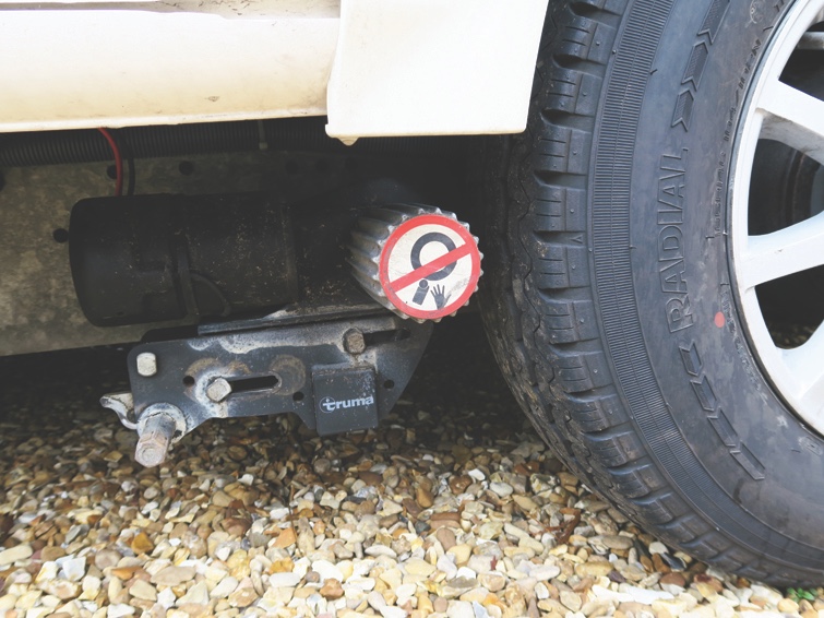

If your caravan has an alarm, tracker or motor mover, they will all require a substantial power supply in order to work, and this usually comes from the leisure battery.

They have a longer life and better starting performance (ideal for motor movers), and are spill-proof. However, they can be twice the price of a standard wet leisure battery.

They have a poor starting performance (for movers), but excellent durability: about twice that of an AGM battery.
