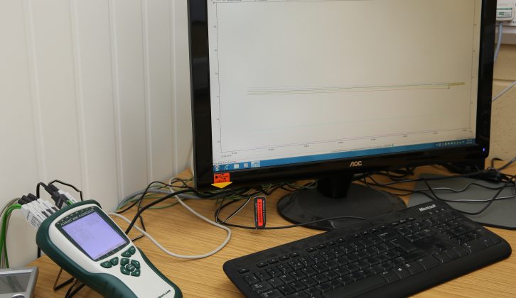

First, the caravan is reversed into the chamber, the doors are sealed and the huge refrigeration units are fired up. An engineer then adds a thermal probe into each corner of the main living area of the van, 1m above the floor, with another in the centre of the van at the same height. All the probes are linked up to the control room – and a further 11 can be added, which is ideal for identifying cold spots when prototype testing.
