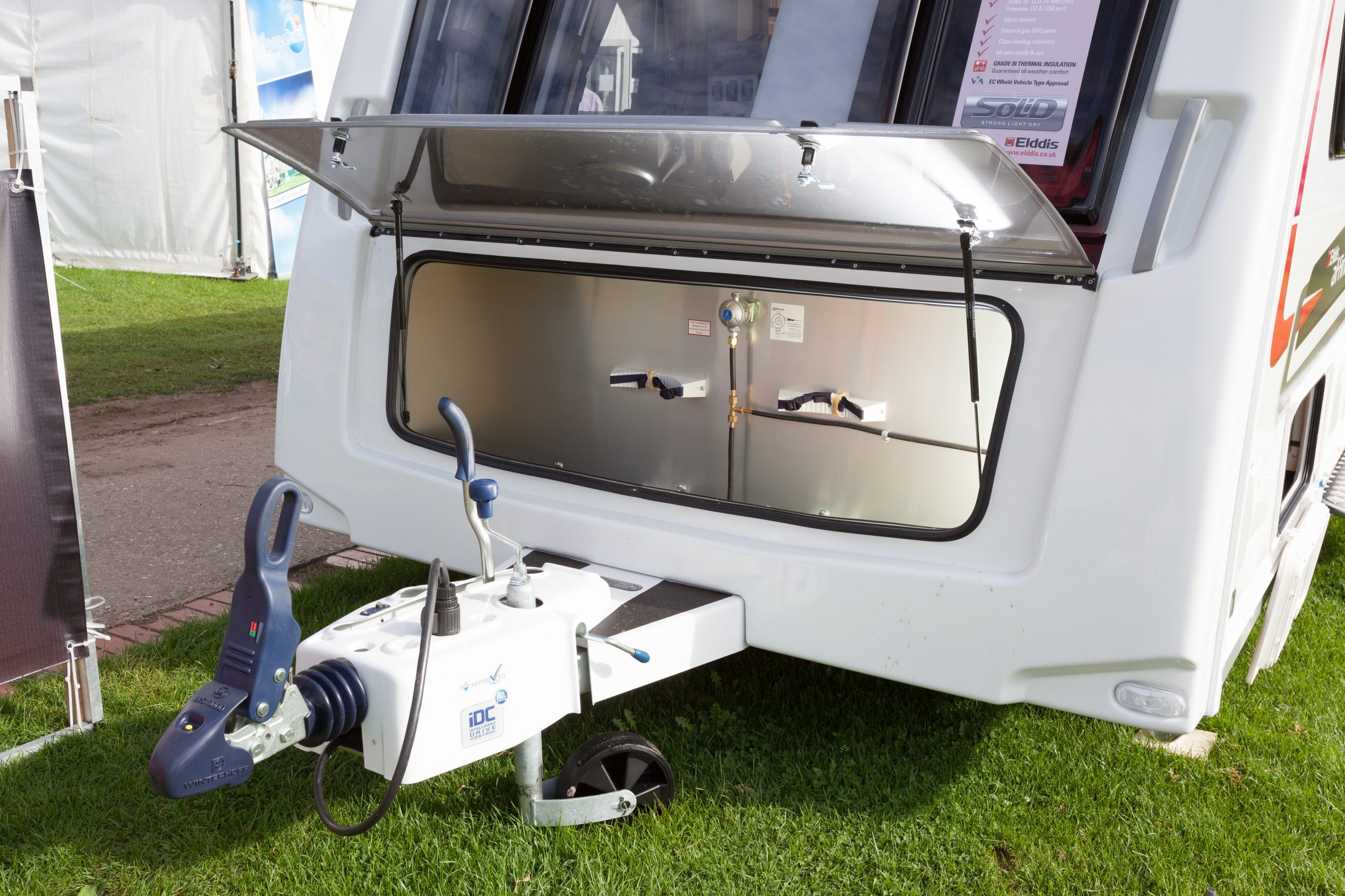

A GRP skin under the floor is bonded and bolted to the BPW chassis. For towing safety, BPW’s Swing V-Tec self-centring axle and IDC control system are fitted. A wide door affords good access to the gas locker and its continuous hinge should keep the inside dry. The exterior is smart, but lacks the wow factor of some rivals.

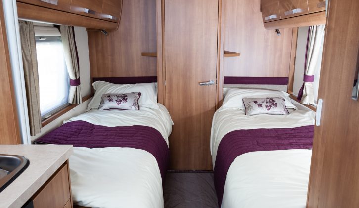

The twin beds in this Elddis caravan are good lengths (at 1.92m and 1.87m, respectively) and comfortable. There is a cut-away in the front panel of each bed box where you can grip the base and lift it easily, while the gas struts can support a fully made bed. The space between the beds is a little narrow.
The room lights are above the roof lockers and each twin bed has a reading light. They also get handy bedside shelves but there are no overhead shelves. A TV can be set up here for evening viewing.
