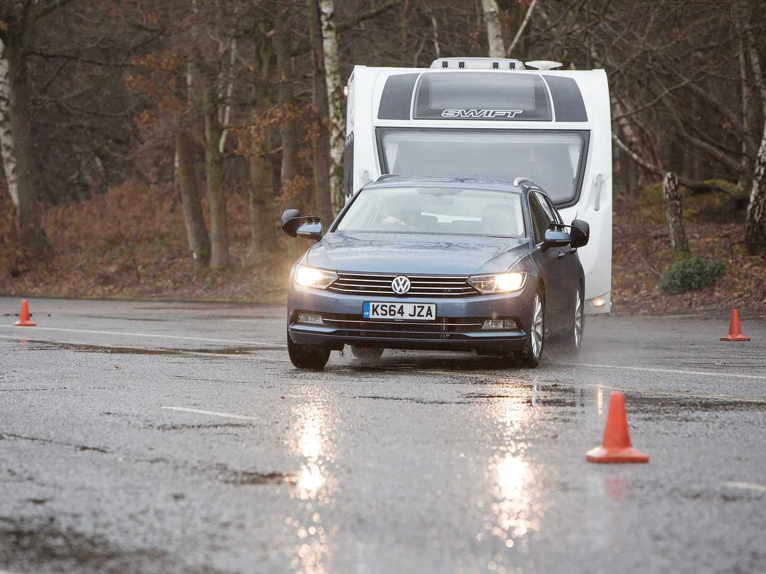

The Passat coped comfortably with the emergency lane-change test, too. If you need to change direction in a hurry, the VW is happy to be hustled. It corners with little lean, keeps the van under control and finds plenty of grip, even on a wet surface.
Damp conditions lengthen stopping distances, but the 11.9m the Passat needed to stop the outfit from 30mph is a good performance on a wet track.

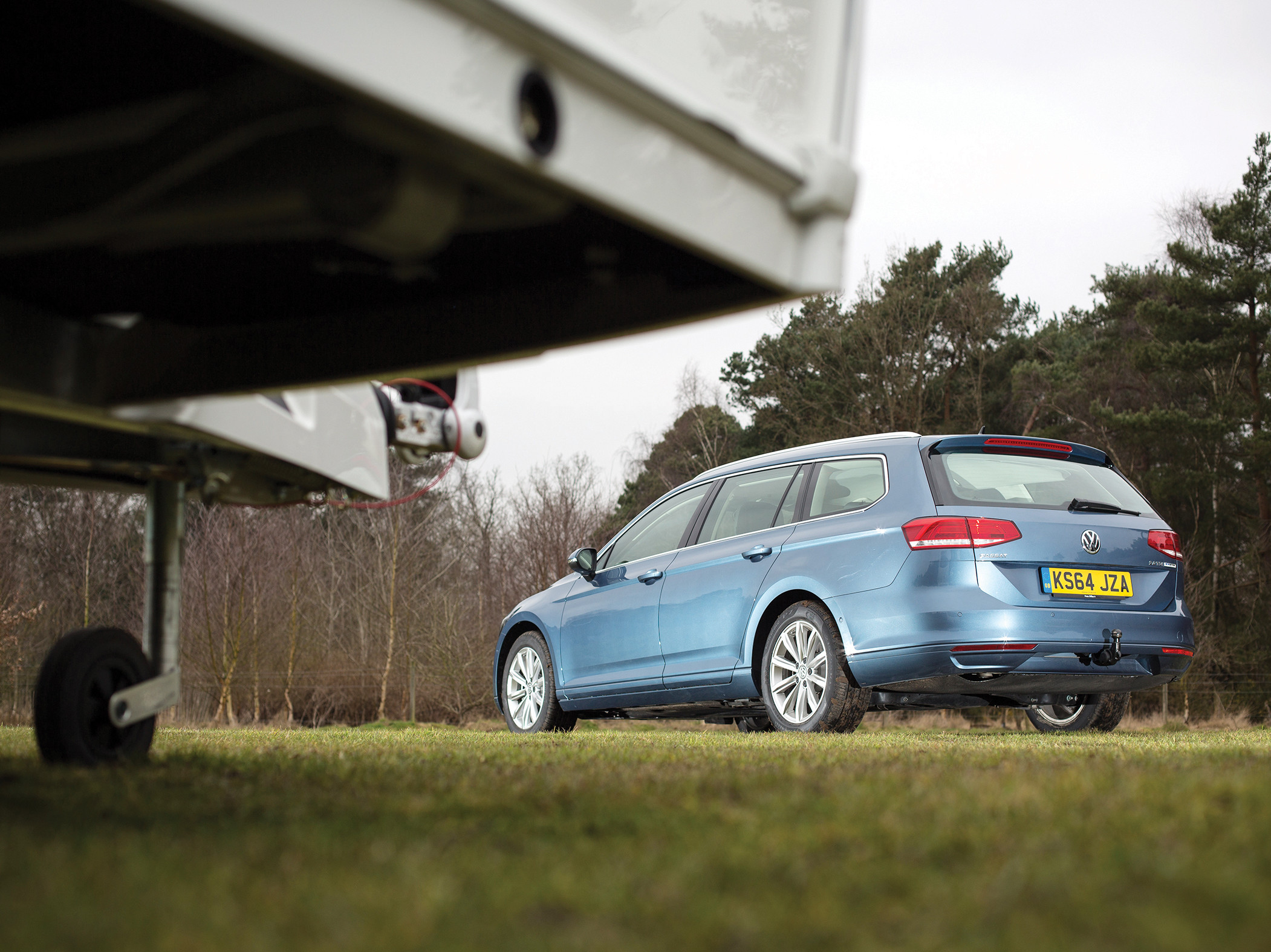

There are other signs that VW has thought about the needs of tow car drivers. For one, the towing electrics are now on the side of the towball rather than tucked up under the bumper, which makes hitching up easier.

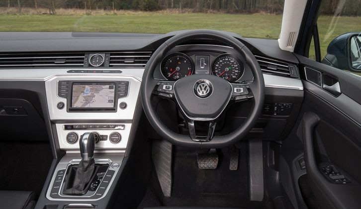

The variable suspension works in tandem with Driver Profile Selection, a standard feature that alters the steering, throttle response, gearbox and other systems. In Sport, the steering weights up nicely and the throttle is more eager. In Comfort, the wheel is light and easy to turn – ideal for parking.
Whichever mode is selected, the Passat is refined and comfortable. There’s some road noise over coarse surfaces, but the engine sounds distant and subdued, with little wind noise.
