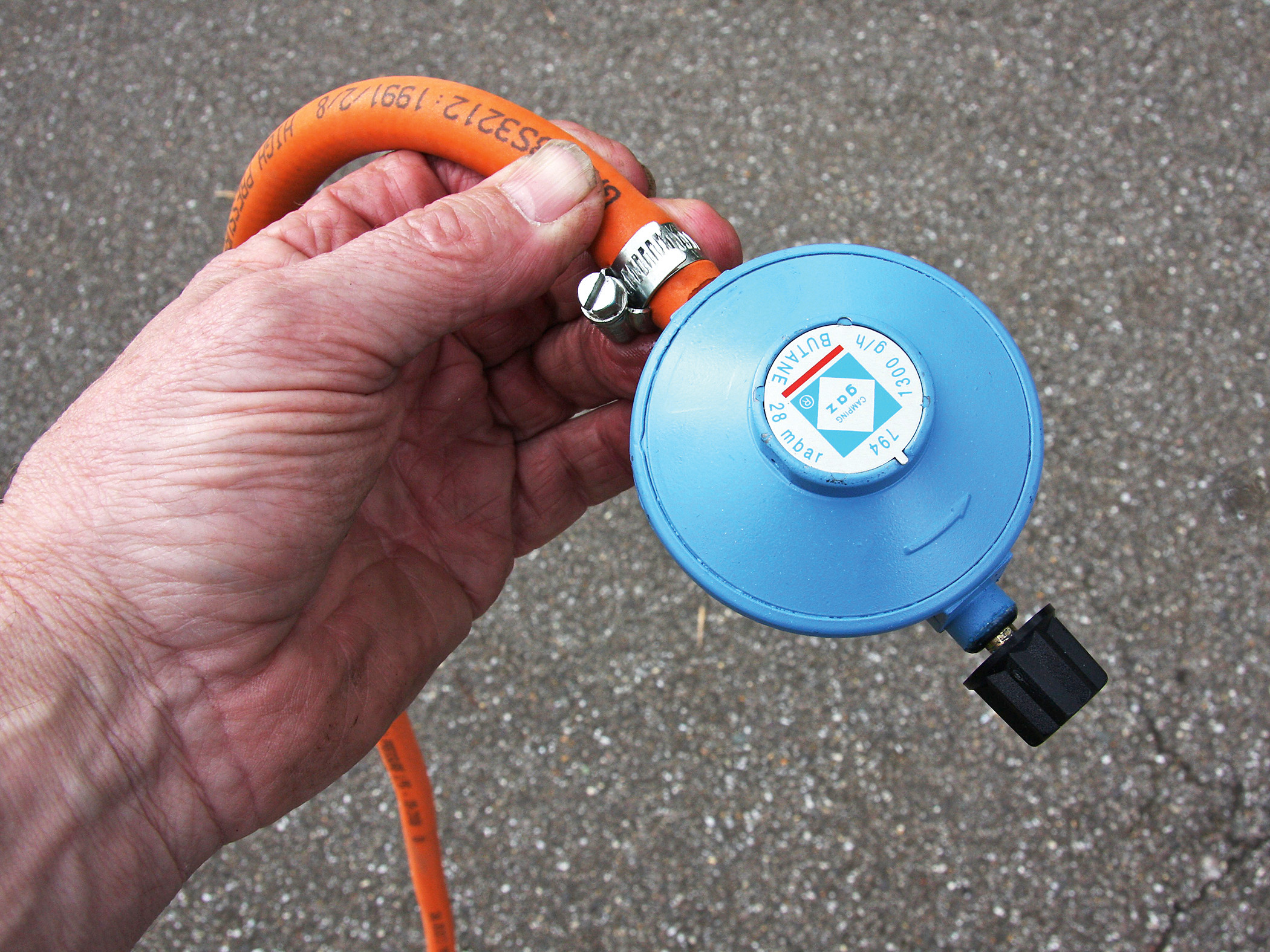

As a rule, a blue (or occasionally green) 28mbar regulator is manufactured to accept the lower pressure of butane; a red 37mbar regulator is made to suit propane.
Since many pre-2004 caravans are still in use, these regulators are sold in camping accessory shops and priced at around £7.50. The trouble is that you may need to buy several regulators to match the different types of gas cylinder used at home and abroad.
When a regulator fits directly to a cylinder, the pressure of gas serving a caravan is reduced and regulated at source – namely the cylinder itself. Accordingly, the owner can then purchase some low-pressure flexible hose to link the regulator’s outlet with the caravan’s main supply pipe. In addition, the hose can be fastened securely using Jubilee-type hose clips.

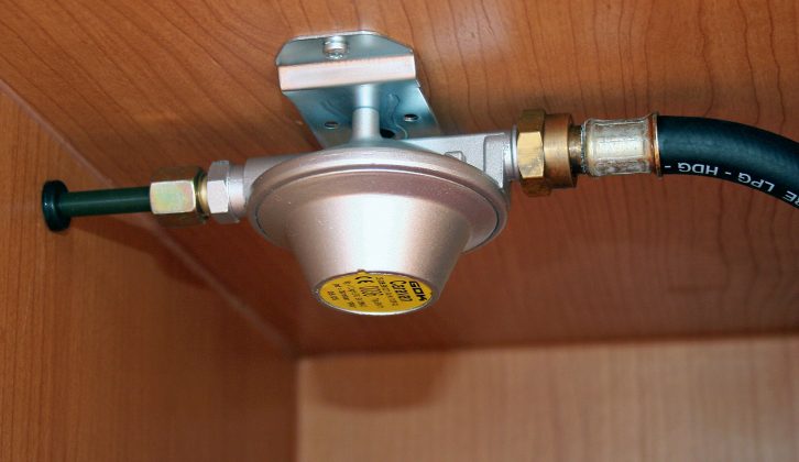

In the UK, however, it was considered far better for a caravan manufacturer to mount such regulators on the wall (or sometimes the ceiling) of the gas locker. This meant that the owner merely had to purchase a high-pressure coupling hose to link the fixed regulator with his or her choice of gas cylinder.

Notwithstanding the benefits of a wall-mounted regulator, bear in mind that its flexible coupling hose has to deal with high-pressure gas coming from the cylinder. For that reason, you must not use low-pressure hoses or clips that are designed to be used with cylinder-mounted regulators. Instead, you have to purchase a purpose-made high-pressure coupling hose that includes factory-fastened connectors.
Without question, wall-mounted 30mbar regulators that accept either butane or propane are a welcome alternative to the traditional cylinder-mounted products. Moreover, a fixed regulator now forms part of a caravan and is therefore subjected to a periodic check when a van is serviced.

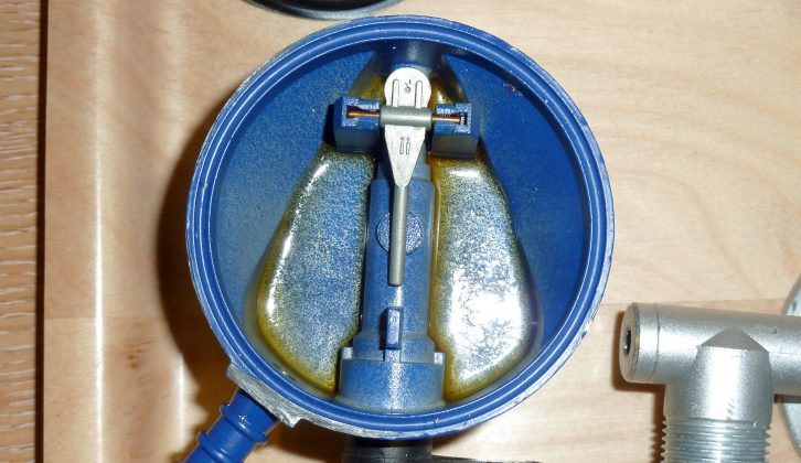

Shortly after the introduction of wall-mounted regulators, service specialists reported that ‘an oily liquid’ was sometimes discovered in the gas supply pipes. This mysterious liquid also found its way into regulators, some of which had to be replaced. Not surprisingly, it was also believed that this liquid was probably the cause of gas starvation and the failure of certain appliances.
In the period that followed, fingers were pointed in several directions. Some specialists blamed the gas itself, others blamed the regulators. However, factual evidence was crucial and laboratory experiments were conducted in order to find cures for the problem.
From the outset, it was also recognised that if a caravan is not in current use and its owner has neglected to close the supply valve on the cylinder, gas will remain in the flexible coupling hose. It was also found that, under certain conditions, condensation could form in the hose as well.
Further analysis showed that the plasticiser compound used to maintain the flexibility of a ‘composite rubberised’ coupling hose sometimes gets absorbed by the condensation deposits. That seemed to account for the presence of this ‘oily liquid’, although others still wonder whether liquefied petroleum gas (LPG) might yield impurities, too. Either way, the problem never seemed to occur in the low-pressure hose used on older caravans fitted with cylinder-mounted regulators. That was one of the anomalies.

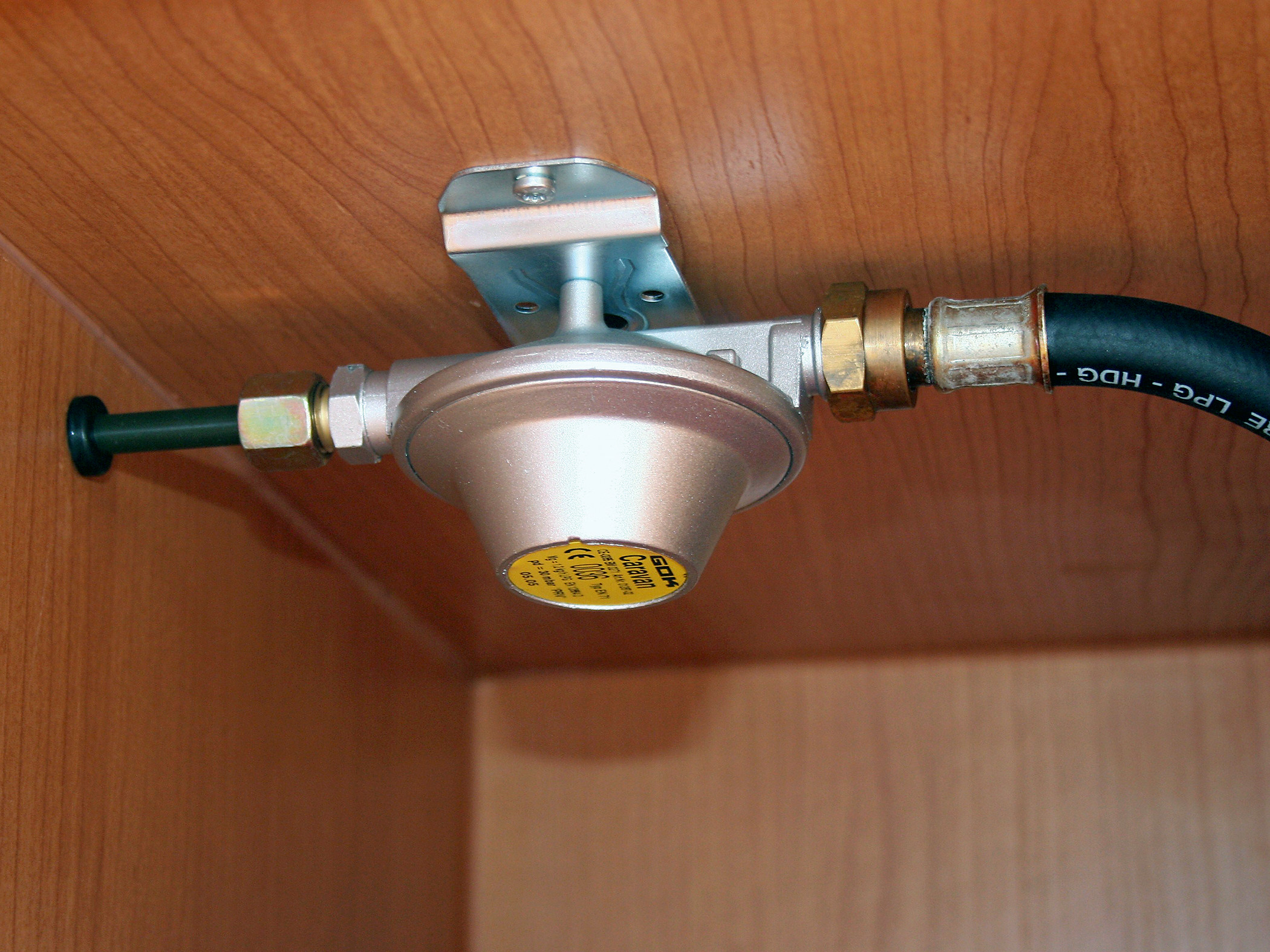

“If a regulator is mounted lower than the outlet from a gas cylinder, the slope on a connecting gas hose makes it easier for condensation accumulating inside to discharge into the regulator through gravity and to upset its operation. Any looping downturn in a hose can also act as a collecting point for residual moisture.”
This observation then led to advice that a dealer could improve the gas system by remounting a regulator higher up in the gas locker. This would allow condensation forming in the hose to flow into the cylinder instead of into the regulator.
Alternatively, some dealers have fitted an extension pipe and elbow above a regulator in order to elevate the high point on a connecting hose.
Incidentally, if you own a post-2003 Avondale, you are likely to have a Clesse regulator mounted right at the top of the gas locker. This arrangement creates a good downward slope on a connecting hose and claims have been made that gas starvation is virtually unknown in such installations.

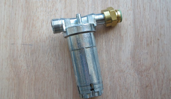

Fitting a Truma gas filter may help further in preventing blockages. It does so by intercepting unwanted liquids and contaminants in its replaceable cartridge. The product is installed in the supply pipe before it connects to the regulator. Brackets and angled connector pipes are available to be used with the unit and a dealer can usually install the filter in well under an hour.
Once fitted, it is simple to remove the collecting vessel whenever liquid is sighted in the inspection points at the bottom. Equally, removing the housing yields access to the cartridge which can be unscrewed by hand for periodic replacement. The details are provided in the instruction booklet.
