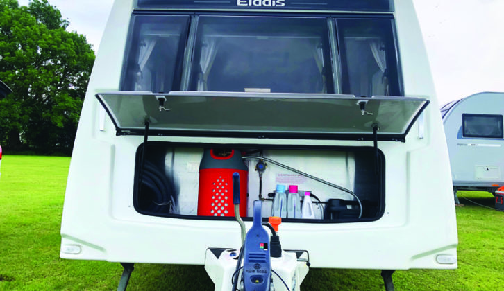

Gas cylinders have to be stored in a compartment that is sealed off from the living quarters. Usually this is the caravan’s front locker (aka the gas locker) where there is typically enough room for two bottles.
With average use, two cylinders should be more than enough for a fortnight’s touring, and in warmer climes (with judicious summer use), they could last an entire season. Off-gridders, who rely on gas to power all of their facilities, will use considerably more, though, especially for winter touring.
Some modern vans, Baileys in particular, have a smaller locker for the gas bottle/ This is often positioned closer to the axle, for better weight distribution and sorter pipe runs to the boilers and kitchen area.
Gas bottles should always be securely strapped into the locker, and the regulator pigtail fitted and tightened with a 30mm spanner. It should be noted that gas fittings have a reversed thread, so you undo the connections by turning the nut clockwise, which might seem a bit counterintuitive at first.
Ensure that the gas bottle is turned off at the top tap before removing it. When the pigtail pipe is separated from the bottle, you will smell a small amount of gas, but as long as the bottle is turned off, this is normal.
Finally, screw the plastic stopper into the bottle’s brass thread to protect it and prevent any small amount of leakage.
When retightening the pigtail nut on the gas cylinder, ensure that it is hand-tight; but do not over tighten, because this might damage the threads and make removal more difficult.

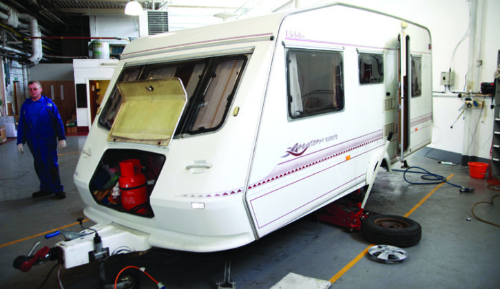

In a full vehicle caravan service, the LPG hoses and regulator are inspected, not just for damage, but also for their age. An LPG regulator has a 10-year lifespan and the hose, five years.

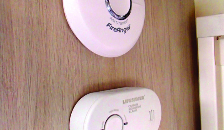

Smoke and CO alarms
Alarms to warn of the presence of smoke or carbon monoxide (CO) are essential.
If burnt exhaust fumes from your boiler, fridge or cooker leak into the caravan’s interior, they can be highly dangerous. They contain CO, which can overcome an adult in minutes, quickly leading to suffocation. These relatively cheap devices could save your life.
