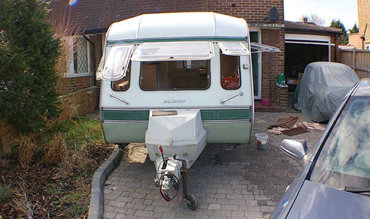

It’s easier to make checks if you keep your caravan at home, but whether it’s on the driveway or you’re storing the caravan at a facility, you’ll be checking over the same things.
A caravan on a driveway
It’s easier to make checks if you keep your caravan at home, but whether on the driveway or at your storage facility you’ll be checking over the same things

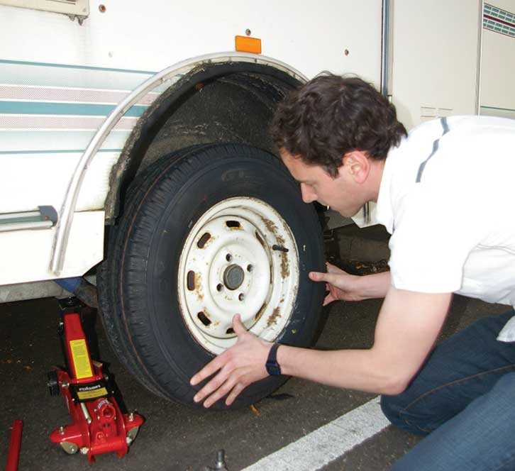

Ten minutes spent regularly checking tyres over will be time well spent. Look for cuts in the tyre sidewall, caused by impact, or anything stuck in the tread
You may also be wondering “how often do caravan tyres need changing?” After all, they cover fewer miles than car tyres, so can deteriorate through age before the tread wears down. Look to replace the tyres once they are five years old or so. We wouldn’t recommend towing with tyres that are more than seven years old as the risk of degradation is too great.
You can check the age by looking for the four-digit stamp on the side. For example, ‘2123’ means the tyre was manufactured in the 21st week of 2023.
Even younger tyres should be checked for visible damage, such as cracked sidewalls or cuts, and replaced if necessary.

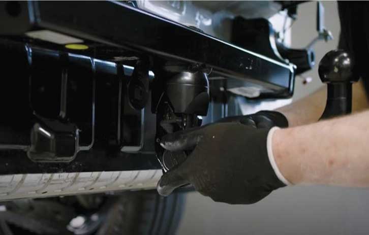

Ensure your towbar is securely fitted

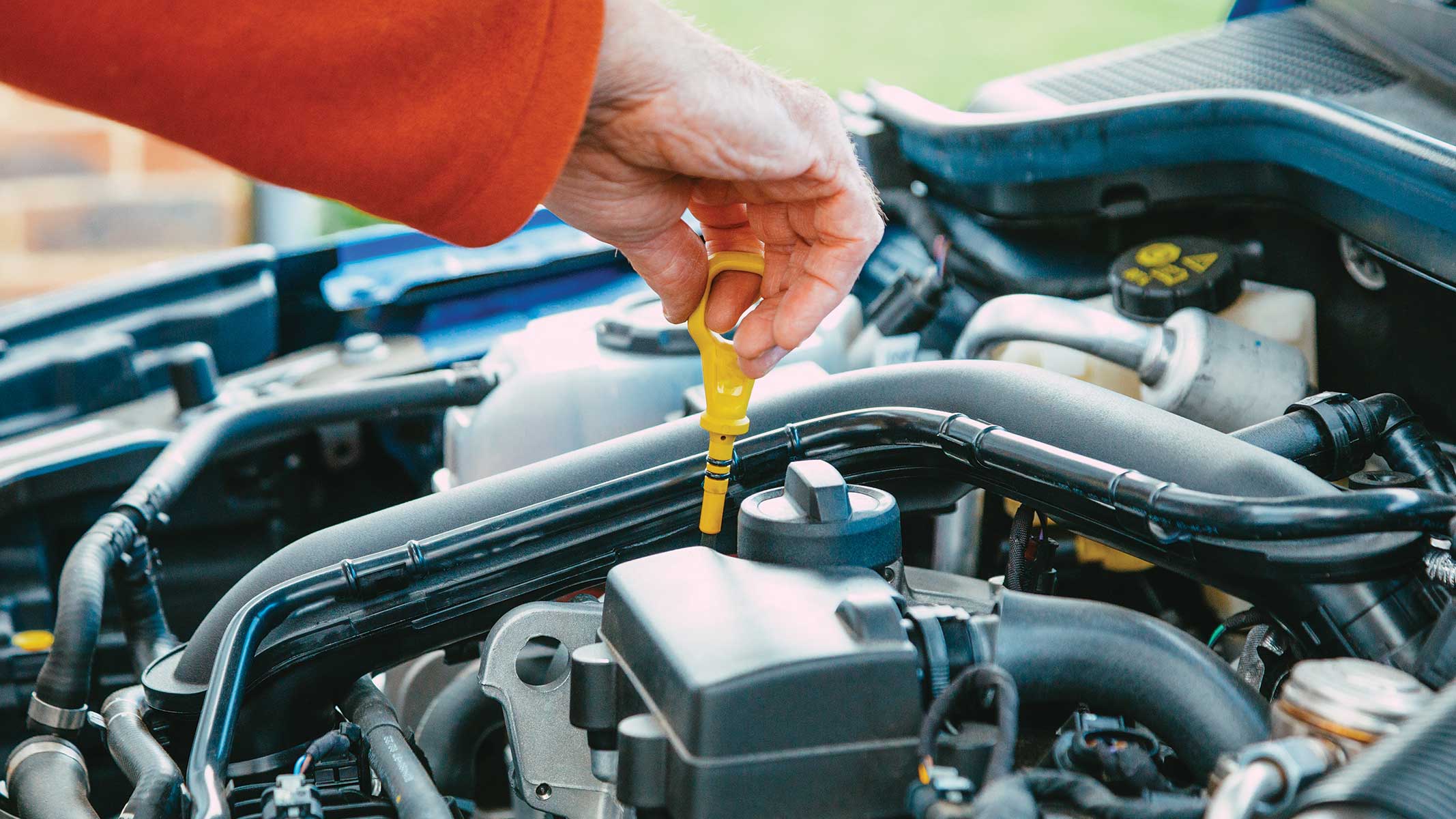

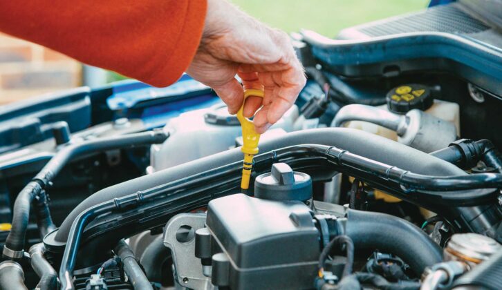

Otherwise, a little DIY maintenance will go a long way. Check the oil level. This is probably part of your regular routine anyway, but it’s especially important to do before a long towing journey that will put the engine under extra strain.

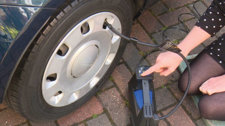

The night before or on the morning of your journey, inflate your car tyres to the correct pressures for towing. These may be higher than in normal driving to reflect the greater load on the tyres.
Checking the tyres
Everything your car does – accelerating, steering and braking – depends on the tyres. You need to be sure that the tyres are safe and legal
Don’t forget to check the spare tyre is properly inflated, if your car has one. If you have a puncture repair kit rather than a spare, make sure the kit is complete and in date. Do this a week or so before the holiday so you have time to replace it.
