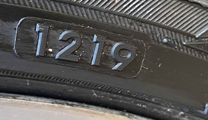

To determine the age of your tyre, simply look for the small lozenge embossed on the tyre wall with two numbers in it. For example, 12 20 denotes the tyre was manufactured in the 12th week of 2020. If this was on your caravan today (Spring 2026), you would be wise to replace it in the next 12 months, whatever its external appearance.
