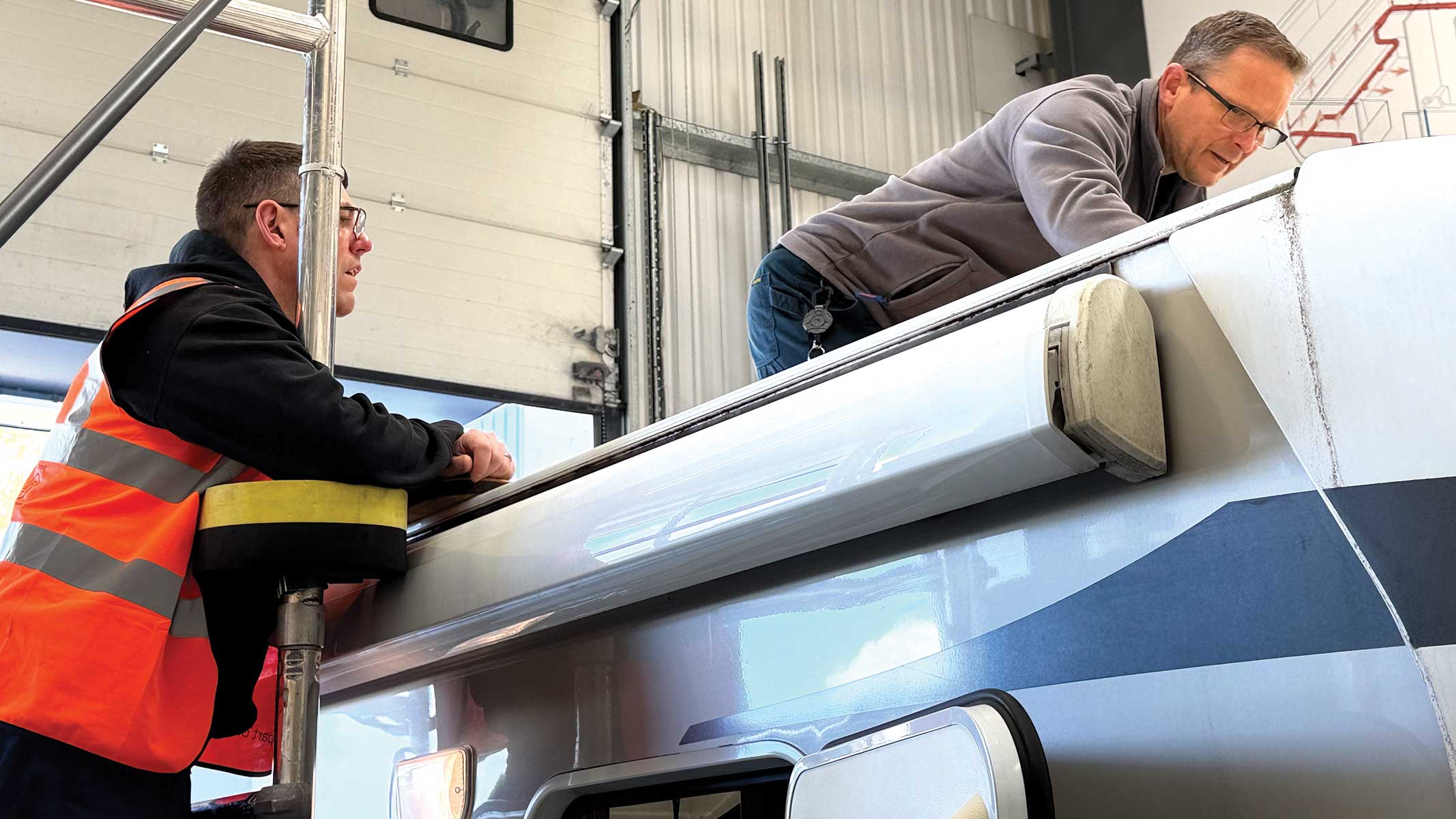

We’re at Truma’s Derbyshire HQ, where technicians Simon and Rich will fit an Aventa Comfort air-con unit to a motorhome (it’s the same process for a caravan).

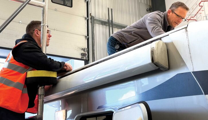

Technicians working out where it will go
Assessing the position of the unit
In the vast majority of caravans and motorhomes, fitting Aventa air conditioning is straightforward for an experienced caravan technician. Truma recommends using its approved network or an AWS-accredited outfit to fit its systems properly.
Checking the roof
Further assessment of position

The Aventa fitting process starts with a careful assessment of the van, checking for sufficient space on the roof and an accessible 240V power source. Access to the control panel is also important.

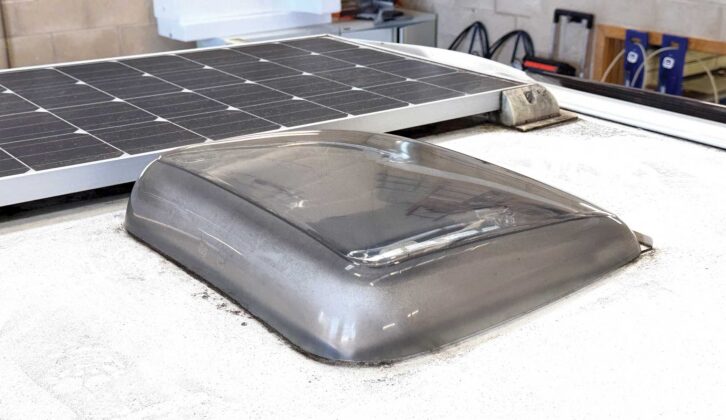

Removing the rooflight
Rooflight to be removed

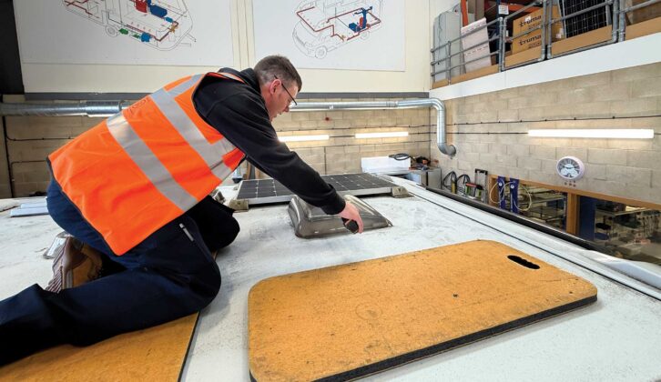

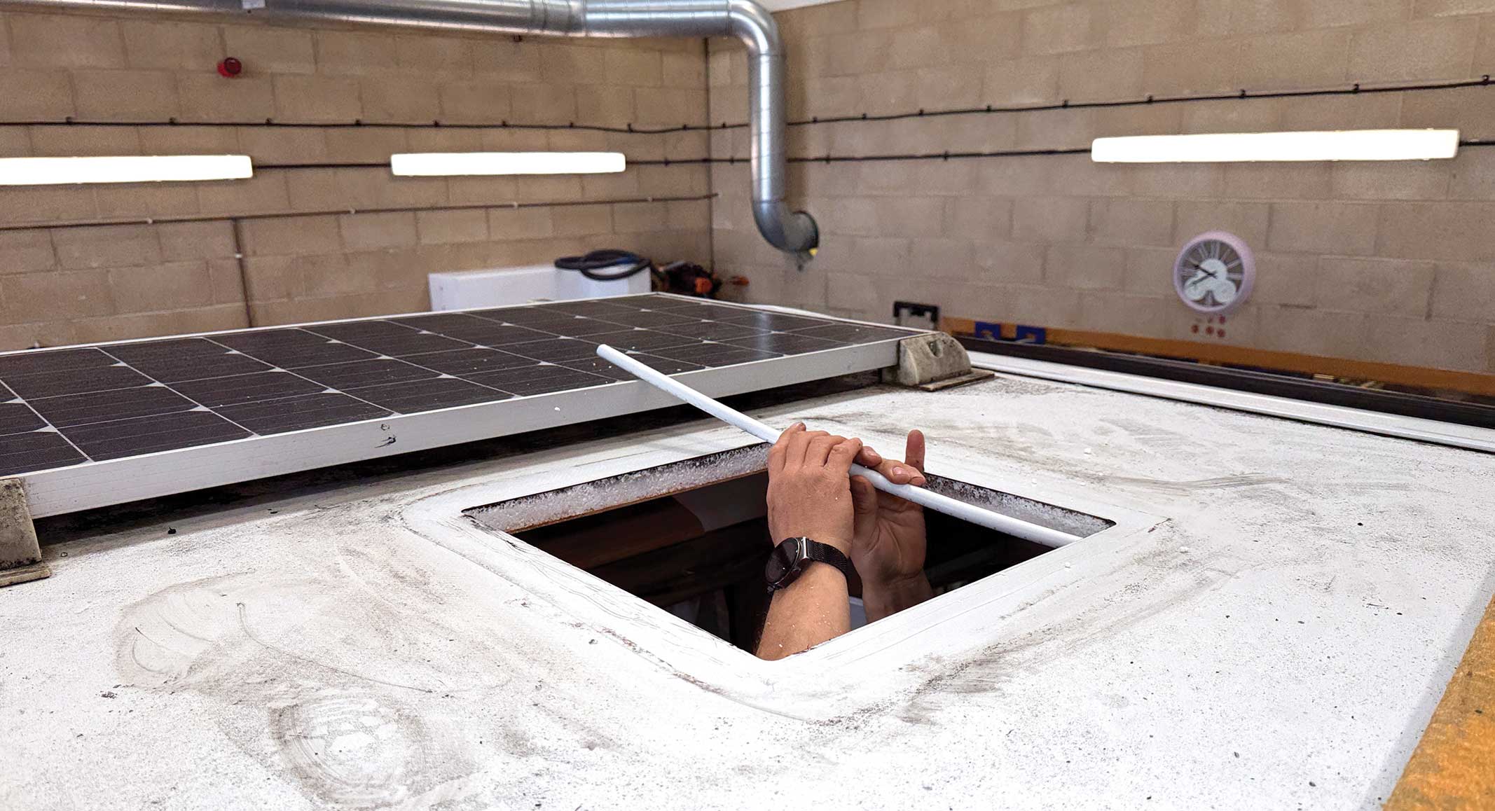

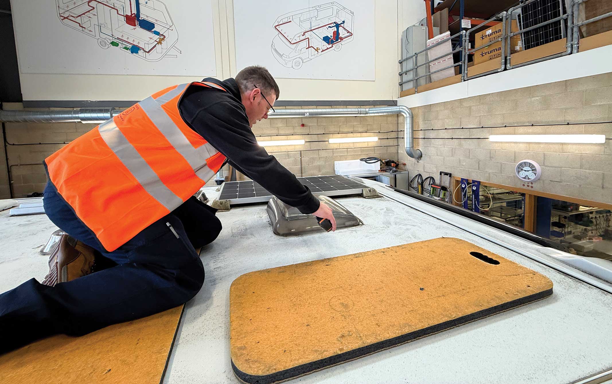

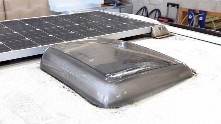

The technician measures carefully, to ensure there is enough room for the unit. With this particular motorhome, a solar panel left just a centimetre of spare space to work with. In the worst-case scenario, an existing panel or satellite dish might have to be moved.
Preparation

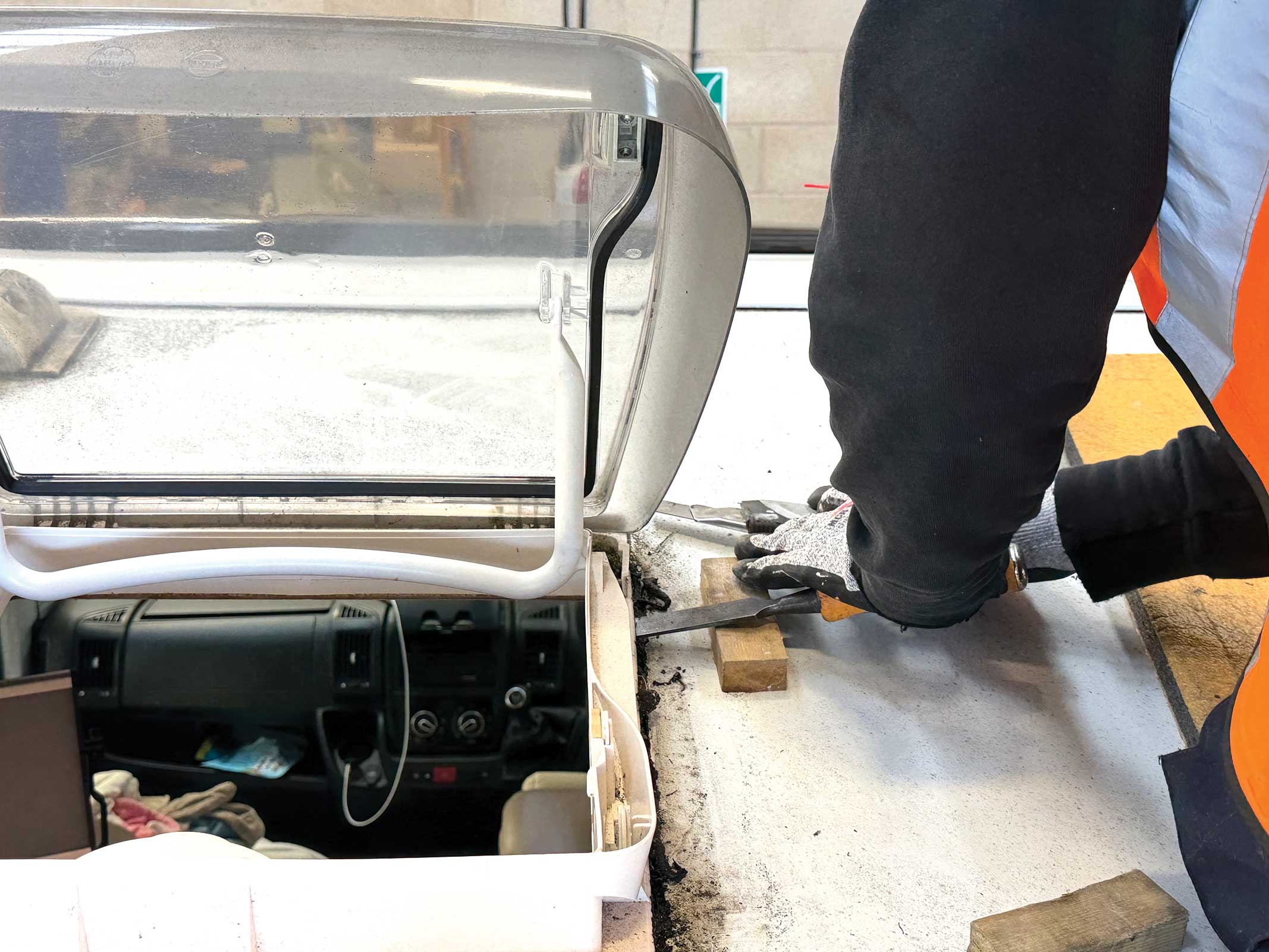

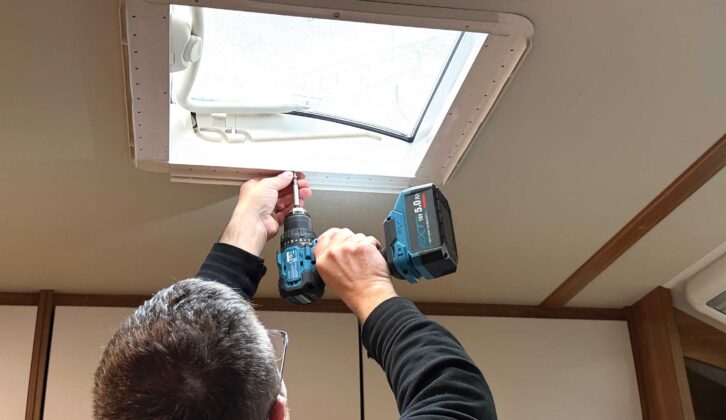

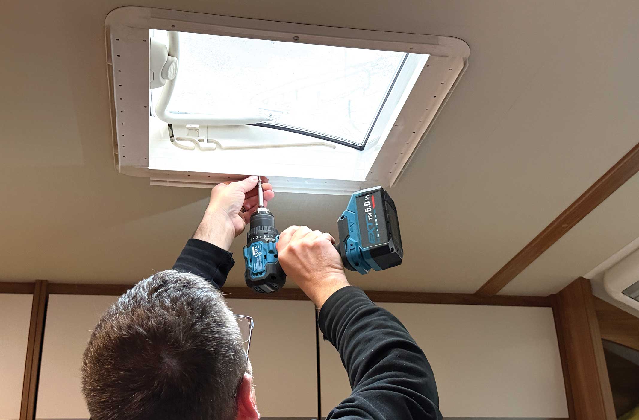

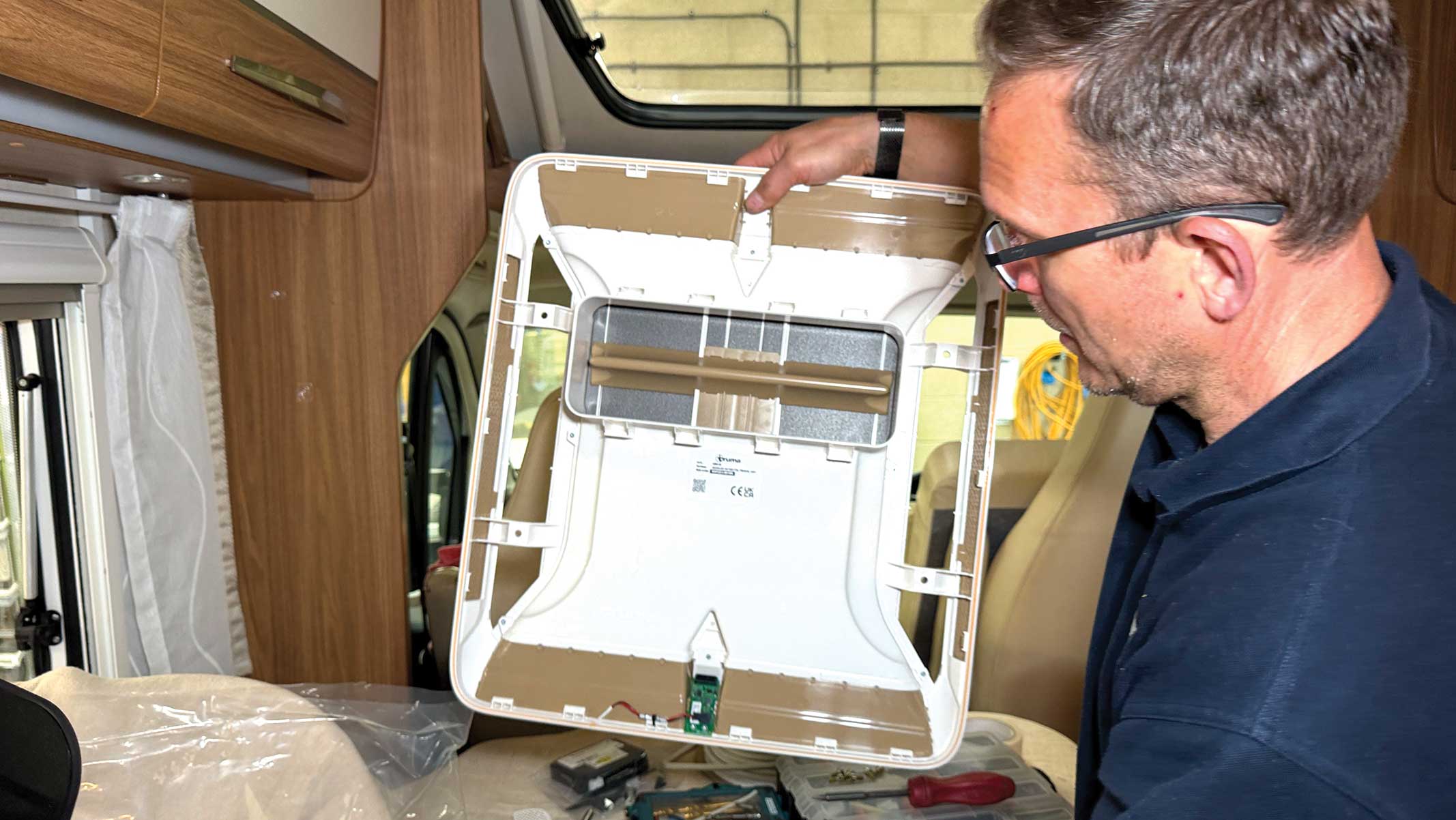

Once it was confirmed that the Aventa would fit, the 40x40cm roof light was removed.
First, it was unscrewed on the inside, then the sealant was carefully cut. The unit was eased away from the roof panel. Time was taken, so as not to damage the roof surface. Truma offers the rooflight back to the customer, in case they ever want to move the Aventa unit to another vehicle and replace the roof light.
Removing the rooflight from inside the 'van

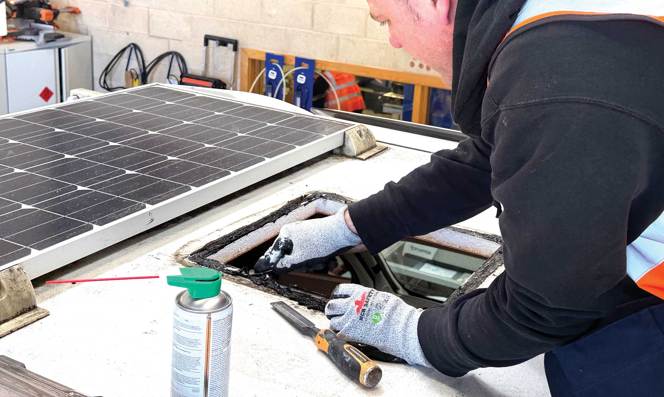

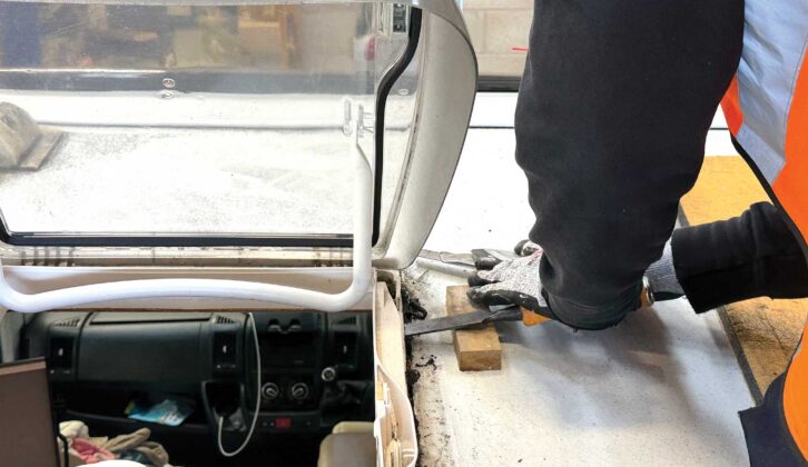

Next, the residual (and resilient) adhesive sealant is carefully scraped off the roof panel. A solvent spray was used to keep the scraper clean, and to clean the roof panel. These adhesives are very durable, so plenty of rags were used.
Cleaning the roof
Cleaning the roof
Once all the adhesive had been removed, the technician cleaned the wider area to ensure the A/C unit sealed properly.

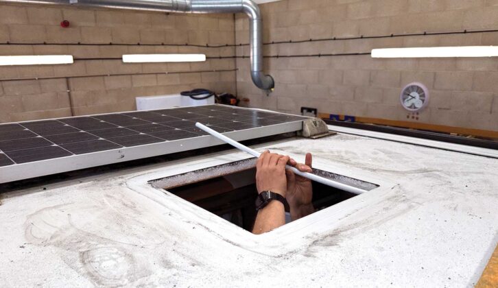

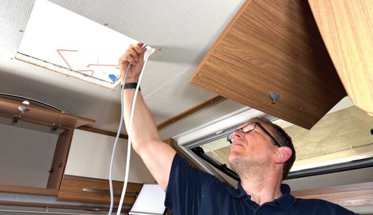

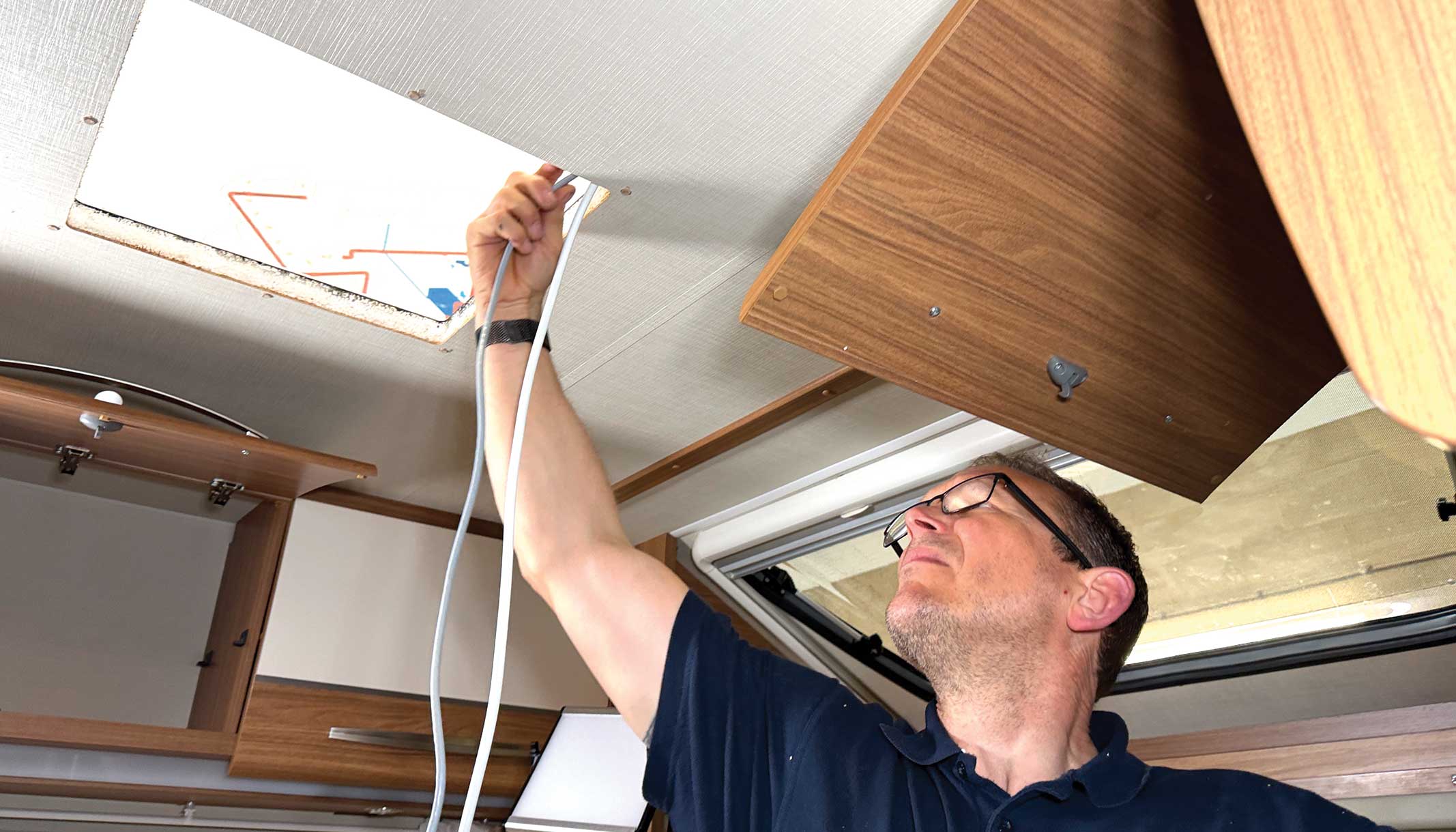

Once the roof was prepared, a channel had to be created to run the power cable to a 230V supply, and the data cable to the control panel. Typically, the engineer will try to take the cable into a roof locker, to ensure the installation is as discreet as possible. The best way to do this ‘invisibly’ is to bore a hole horizontally through the polystyrene layer in the roof panel. To avoid damaging the aluminium or GRP roof surface, or the ceiling panel, this can be done by hand using a long 12mm-15mm Auger-style drill bit.
To extend the hole all the way to the nearest roof locker space, Truma technicians use a sharpened length of stiff PE pipe. Once the bored hole reached a position above the top locker, a 20mm hole-saw was used to drill vertically and complete the channel into the locker.
Creating the cable hole
Next, after ensuring that the cables were long enough, they were fed through the hole and into the top locker, before they were cut to length at the roof aperture.
Pulling the cables through

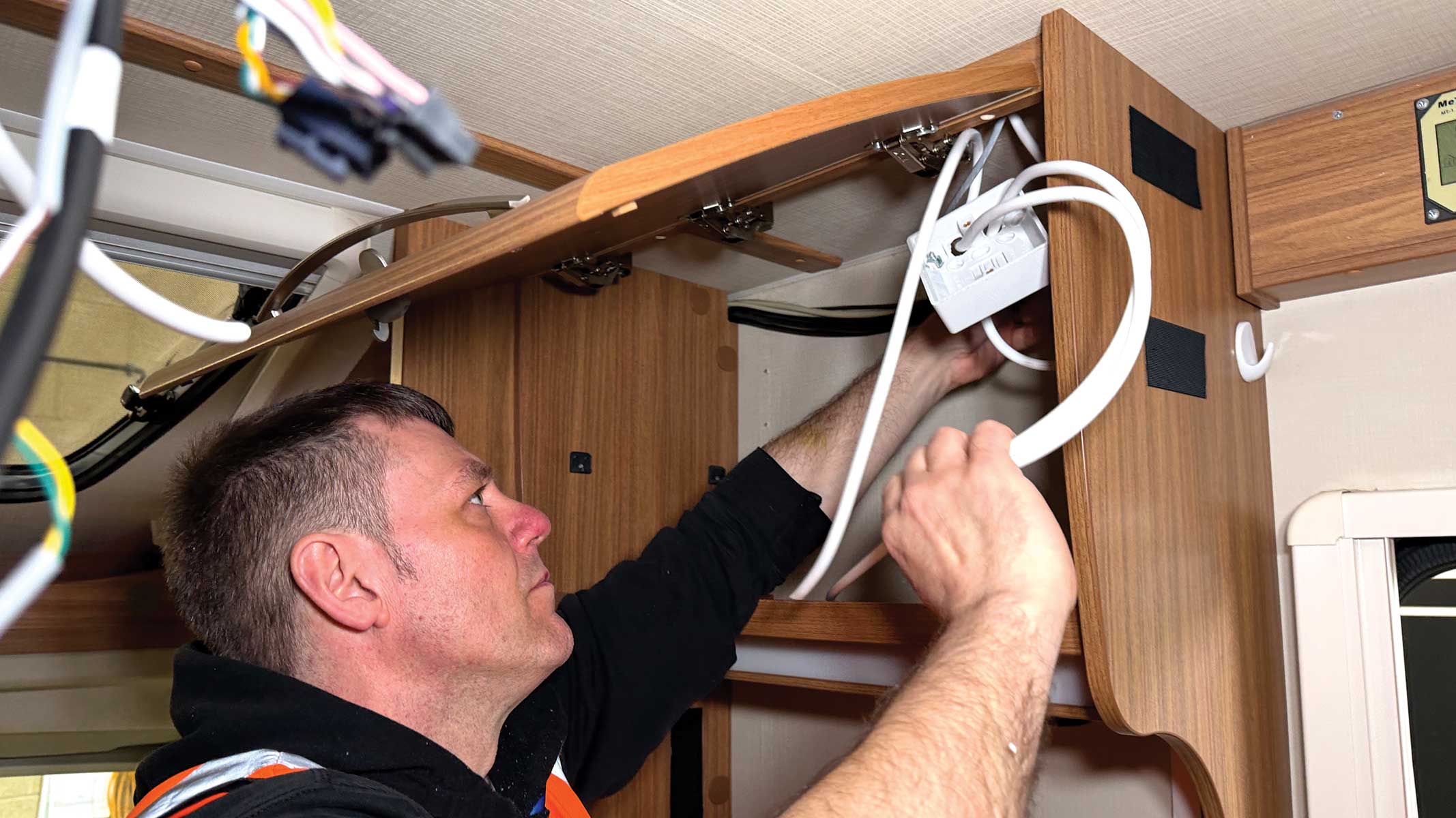

Inside the locker, a collar fixing was fitted around the cables and screwed it in place.

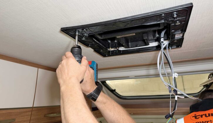

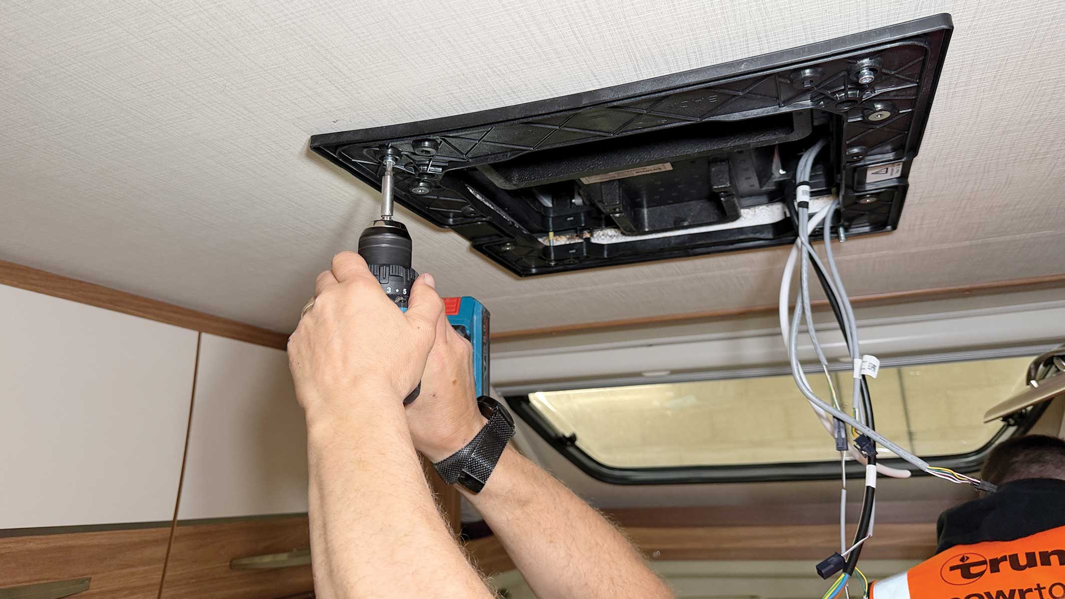

With the unit correctly positioned, the lead technician, Simon, went back inside the vehicle and fitted the internal frame, which secures the air-conditioning unit in place. He bolted it up firmly, thereby preventing any movement.
Next, the power lead was attached to the power connector on the unit, the team ensuring that all the connections were secure.
The next step was to connect the CAN-Bus data cable to the air-con unit. This allows you to control the system from the main panel.

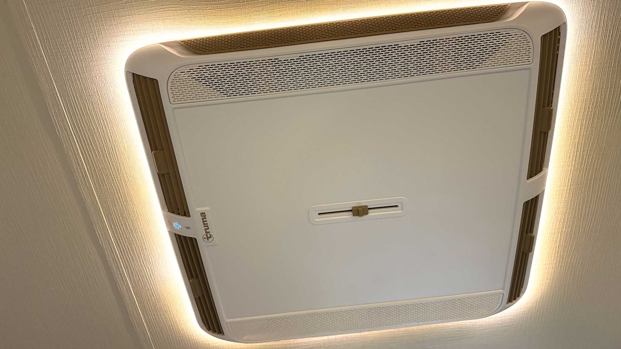

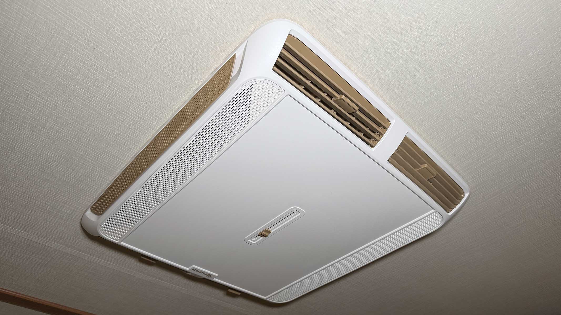

Fitting the fascia
Fitting the fascia

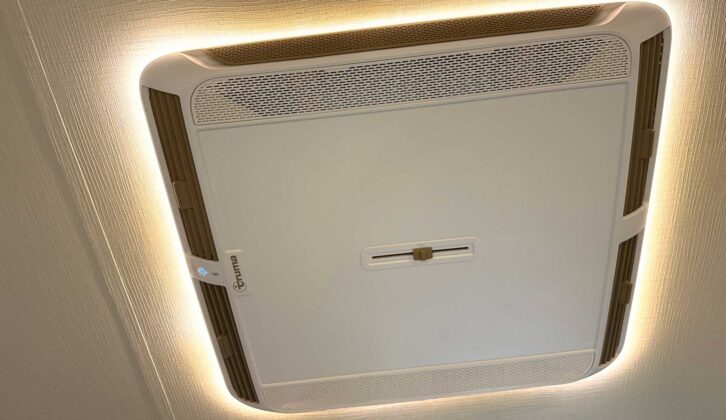

The unit’s fascia, with adjustable louvred vents, was then fitted and screwed in place. The main A/C unit was now installed.

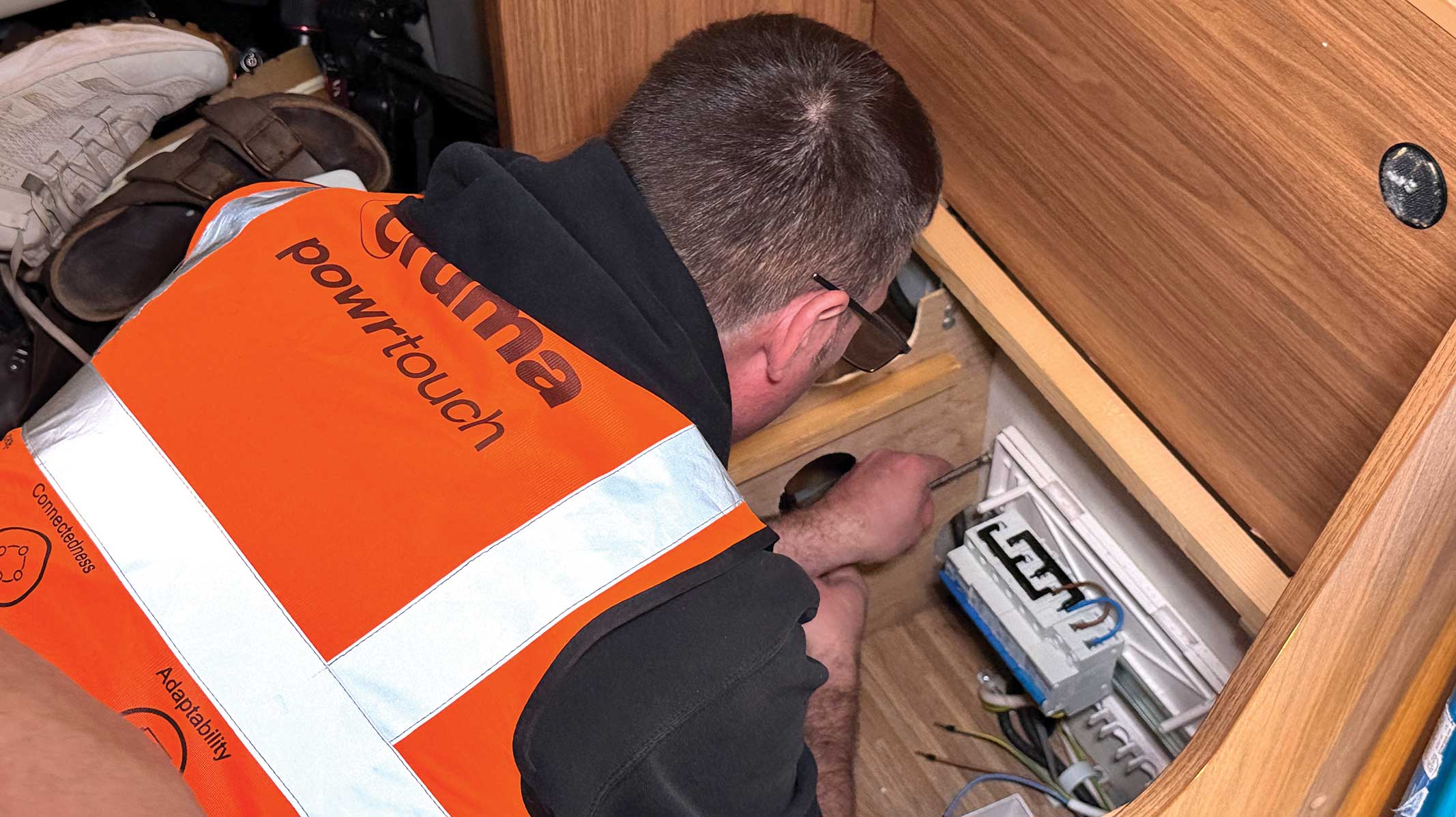

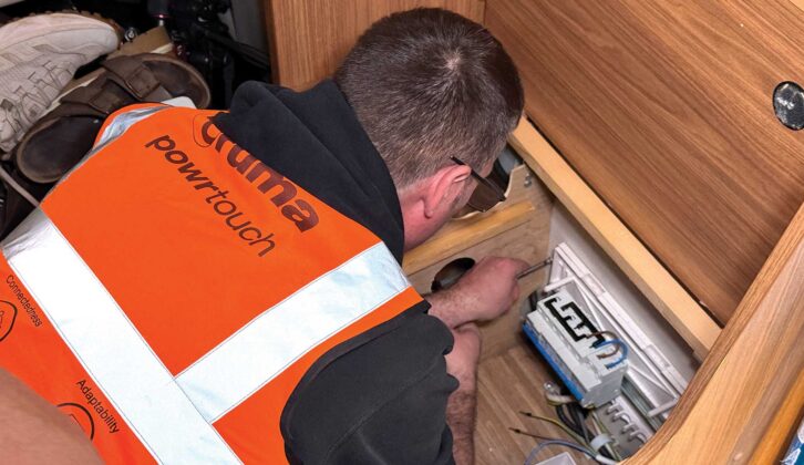

To prevent total loss of power in the van should an air-con unit ever fail, the team fitted an isolator switch. This was positioned, sensibly and unobtrusively, in a locker.
Then, once the cable was channelled down to the van’s electronic control unit, it was connected to the power source.
Fitting the isolator switch
Connecting the power

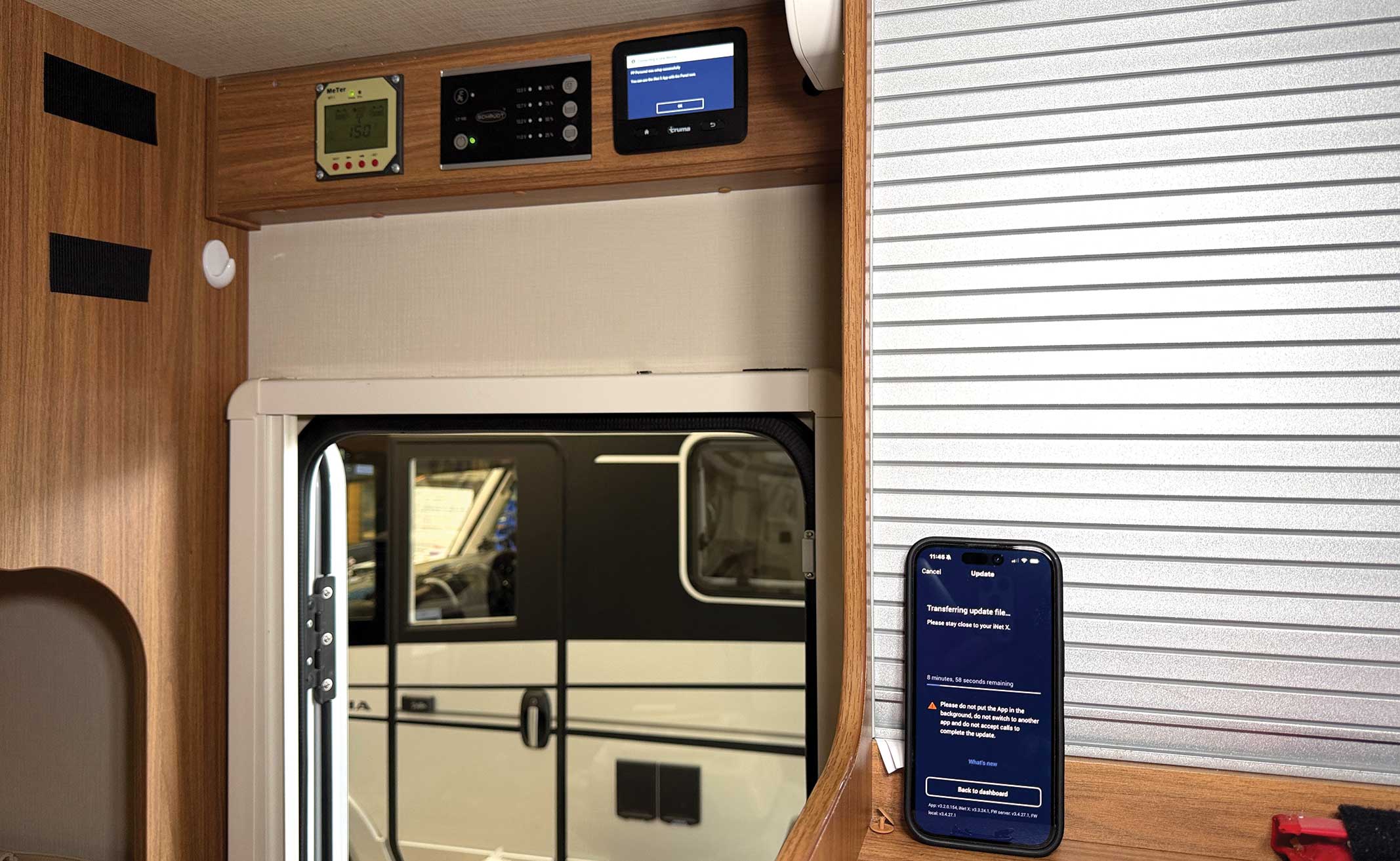

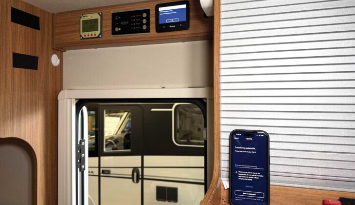

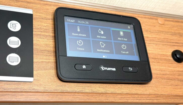

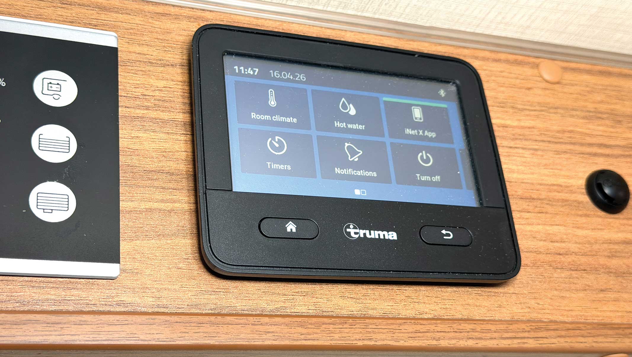

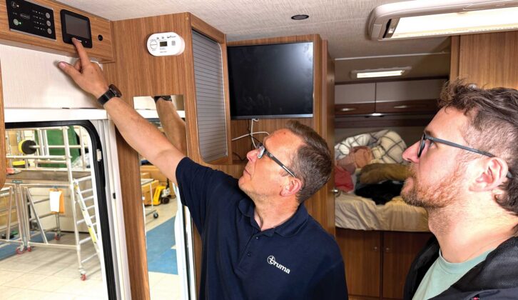

The next job was to connect the air-con unit to the cutting-edge Truma iNet X control panel, which, as usual, was located above the doorway.
The control panel fitted

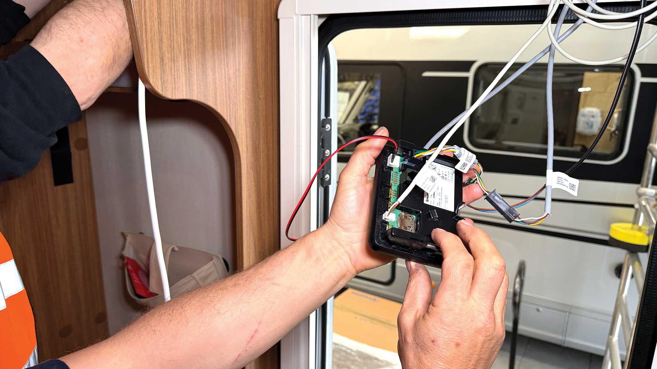

In this particular case, the aperture in the panel had to be enlarged slightly, to house the new panel. Once resized, the cables were fed through and connected to the panel, and the iNet X display clicked into place.
Next, the digital connection between the new Aventa air-con unit and the control panel has to be established. This is done via the panel’s menu and takes a minute or so to process.
Now, it was time to sync the (free) phone app to the control panel, so that the system can be managed when you are outside or away from the van. Again, this process is automated and may take a few minutes. For vehicles without the latest iNet X control panel, a separate interface can be fitted to deliver all the regular functionality.

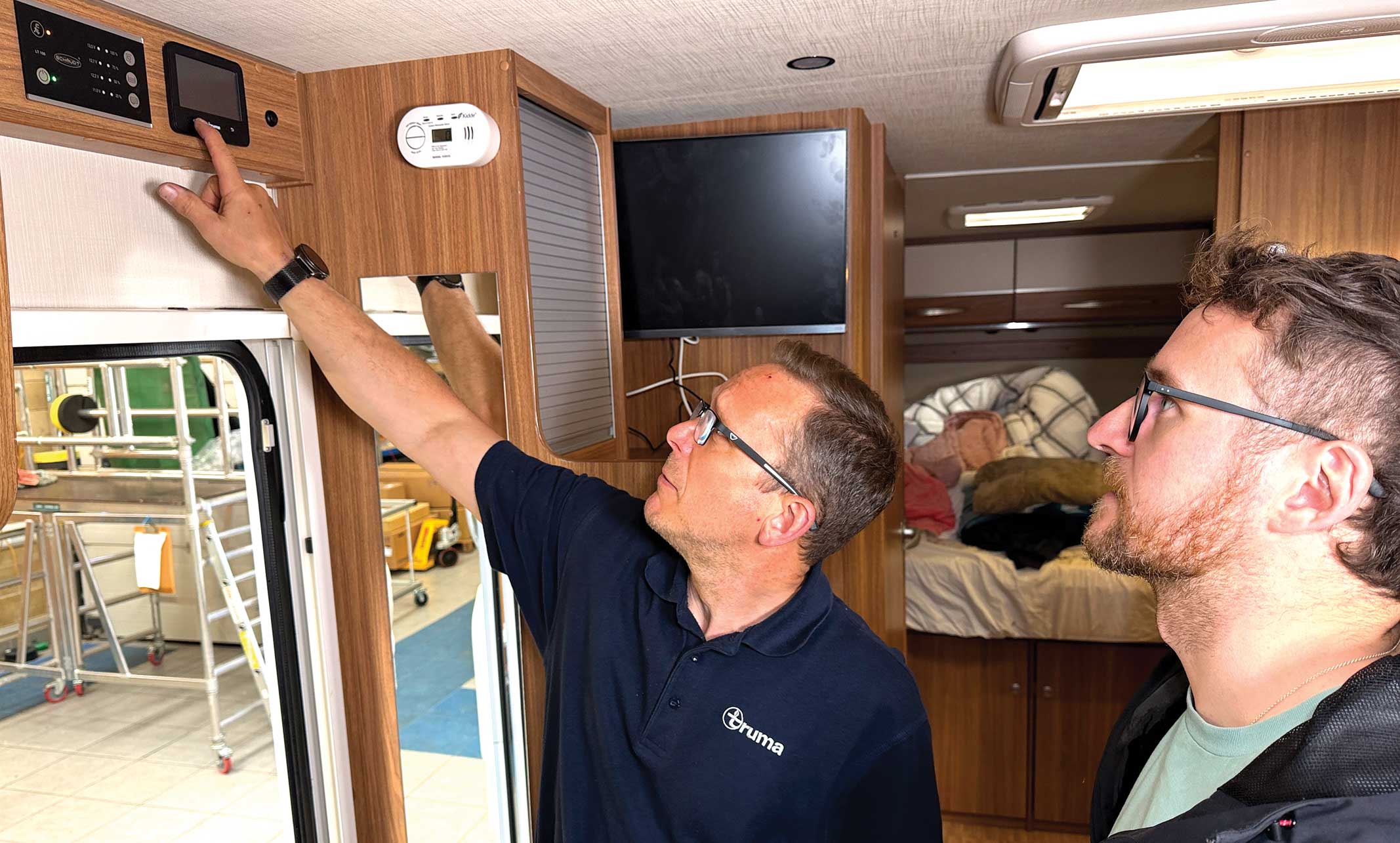

Once the technicians, Simon and Rich, were happy that everything was working properly, it was time to brief the customer on their new device!
Simon carefully explained how the system operates – it both cools and heats – and revealed the numerous functionalities that Aventa offers, along with the panel and phone-app options that are available to control it.
Briefing the customer
