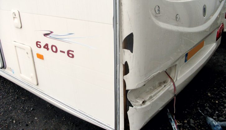

The workshop had a number of caravans in for repairs; the rear corner of one was damaged, a common issue with twin-axle tourers. At one time, this would have required completely new rear and side panels.
“We cut out the damaged areas in the aluminium sidewall and put in a new piece after any structural damage is repaired,” Jonathan explained. “The new piece is bonded in and then it is painted and finished. If the rear ABS panel has a split, we do a plastic-weld to repair it.
“If a section needs replacing, we can often cut a piece from a damaged panel we have in stock, and weld that in place. We never get rid of old panels, because there’s always something that we can salvage from them.”

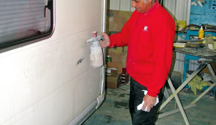

One of the staff, Pete, was working on a Bailey Senator with a damaged side panel. “First of all, everything is cleaned and decals are removed, so we can see what we’re dealing with,” Pete told me. “You must have a keen eye, because the last thing we want is to do a repair and then find a small dent somewhere and have to start again.”

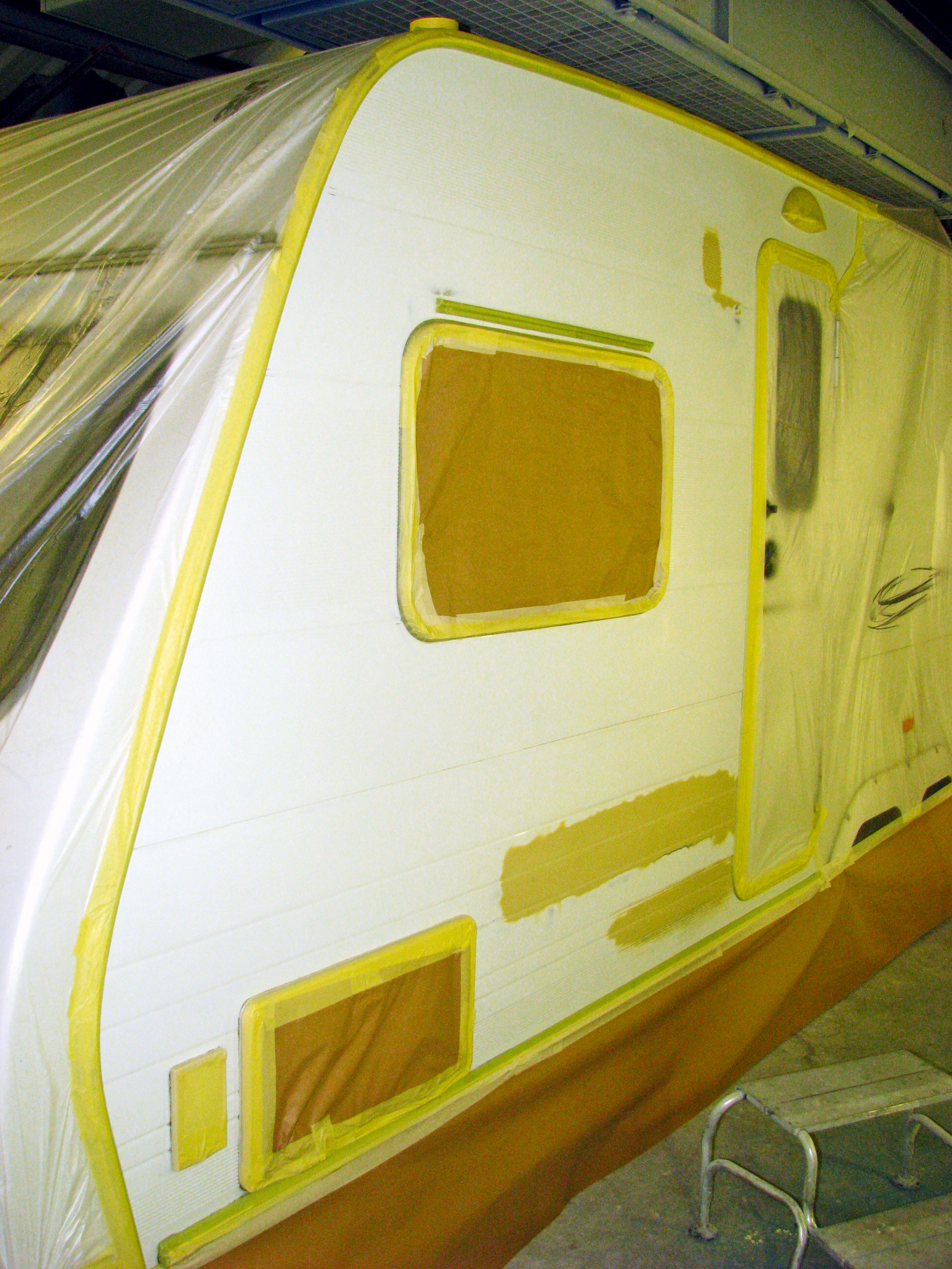

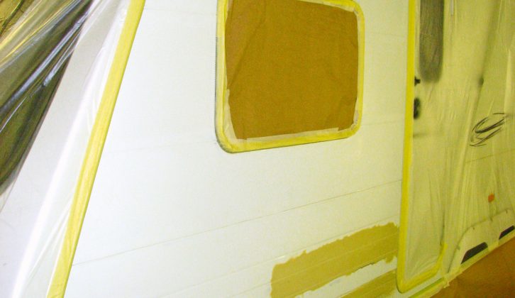

Paint: perfect matches
For ribbed panels, a mould of the ribbing is made using latex. The mould is then stuck over the area to be repaired before a specialist liquid filler is injected, which, when set, forms a perfect match. We continued on to the paint shop where a Lunar Lexon was prepared for painting in a heated, dust-free environment. To get a perfect match, a spectrometer is used.
“We’ve perfected paint matching to such a degree that we can just paint a small area, rather than whole panels,” Jonathan said. “We can even do silver, which is notoriously difficult to match. It’s no good just getting the paint from stock and hoping it’s a good match, because no two vans are the same. For instance, one might be taken abroad and be in bright sunlight for extended periods, which may cause faster fading than on one that’s kept in the UK.”

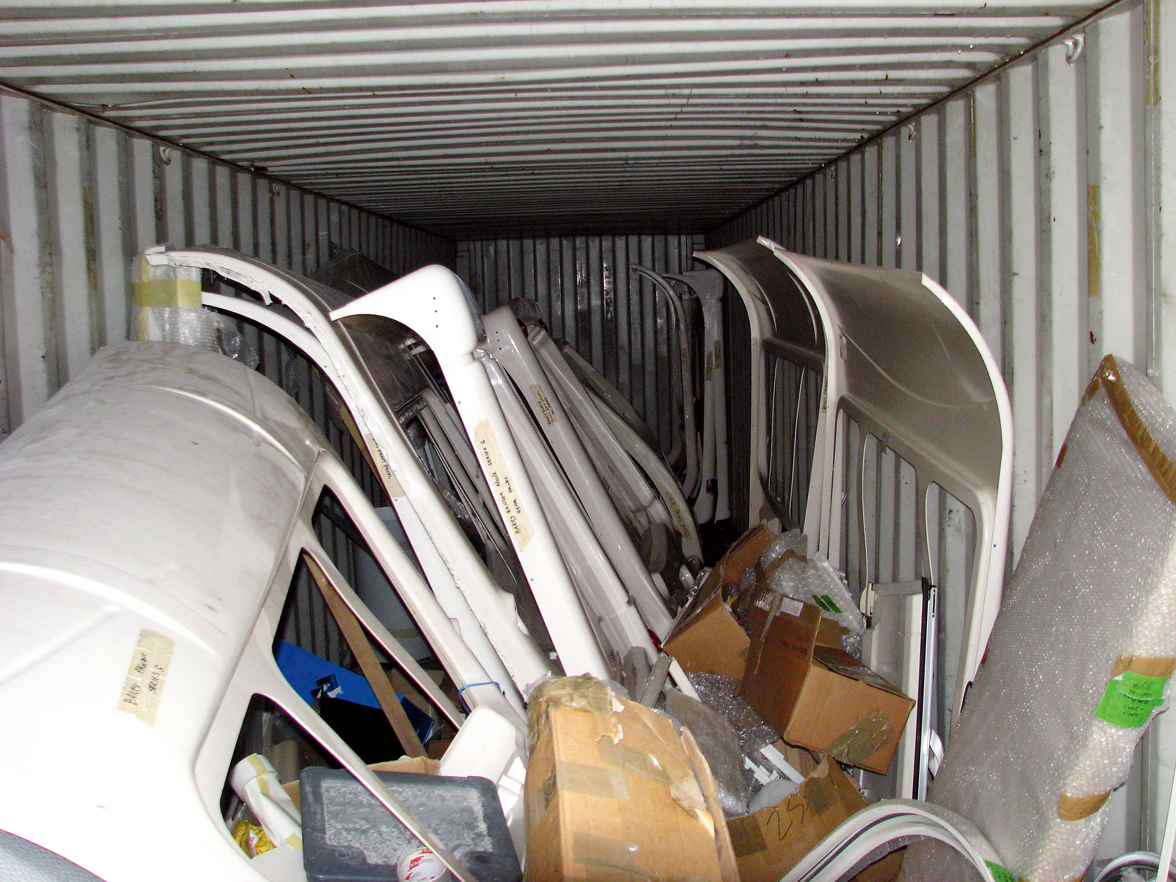

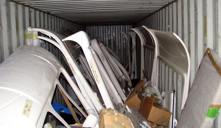

We then went to the ‘panel graveyard’, where I was shown a stack of front and rear panels; some were missing sections which had been removed to be used in repairs. Other panels, stored inside, had been refurbished. “Some of those are no longer available from manufacturers, so we will also supply other repairers,” Jonathan said.
