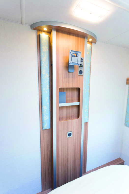

The aerial cable is usually connected to a coaxial socket close to a predetermined TV point with power and often, a TV mounting. Good-quality aerial brands include Vision Plus, Maxview, Status, Ma-Ve, Milenco and Labgear.

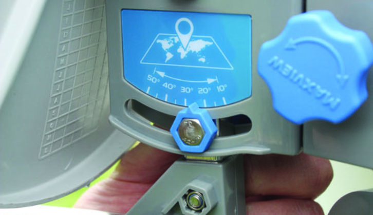

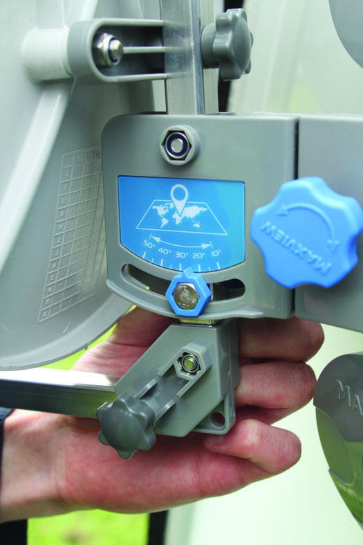

Suction-cup manual dish
As an example, the Maxview Remora Pro dish features two suction cups and is perfect for attaching to the flat (smooth) sides of a caravan. Bubble-effect panels, popular in Europe, might be a problem. Assembling the dish is simple and logical, and only takes a couple of minutes:
- Attach the dish securely to the caravan, ensuring that it is level and there’s a clear line of sight to the southern sky.
- Connect the coaxial cable to the LNB.
- Connect the other end of the cable to the TV (with built-in decoder) or to the receiver box. Some vans have a cable entry point. If needed, connect the decoder box to the TV.
- Turn on your TV.
- Set the elevation angle to suit your location, using the map that comes with your dish.
- Rotate the dish slowly on its horizontal axis (the azimuth) from left to right. Stop when you see/hear the TV find a channel.
- Alternatively, you can use a sat-finder device, or your dish’s integrated sat-finder (if it has one), to locate the satellite. Turn it on, then slowly rotate the dish from left to right. The LEDs will light up or the needle will move; you might hear a beep or change of tone when the satellite has been located. A clear picture should appear on your TV.
- Lock the dish at that angle.

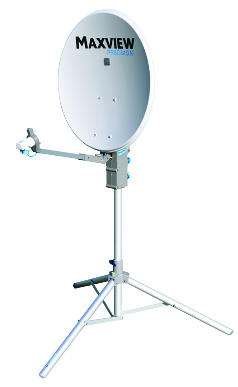

Tripod-mounted manual dish
- Assemble the dish and tripod. Position it on firm, flat ground, pointing roughly towards the southern sky. Ensure it is level, using the integral spirit level.
- Use the compass to make sure the ‘south leg’ of the tripod is actually pointing south.
- Pull the LNB arm down into the correct position.
- Connect the flexible cable.
- Connect the other end of the cable to the TV (if it has a built-in decoder), or the satellite box (which is connected to the TV).
- Turn on the TV.
- Set the elevation angle to suit your current location, using the elevation map, which you’ll find on the back of the dish.
- Rotate the dish slowly on its horizontal axis from left to right (the azimuth). Stop when you see/hear the TV find a channel.
- Alternatively, you can use a separate sat-finder device, or your dish’s integrated sat-finder (if it has one), to locate the satellite. Turn it on, then slowly rotate the dish from left to right.
- The LEDs will light up or the needle will move; you might also hear a beep or change of tone when the satellite has been located. A clear picture should appear on your TV.

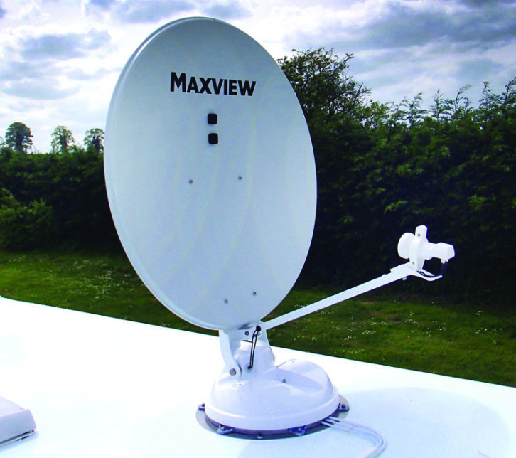

Automated roof-mounted dish
If you have a fully automated roof-mounted dish, finding a perfect channel signal is as easy as pie (easier, in fact!):
- Turn on the unit and your TV.
- Activate the dish by pressing the button on the control box. That’s all you need to do!
- If getting up from the sofa to do this makes things too complicated, you could consider downloading the system’s app to your smartphone.
- However it is activated, the dish will rise to the correct angle and automatically swivel until it finds the ideal angle for perfect channel reception.
