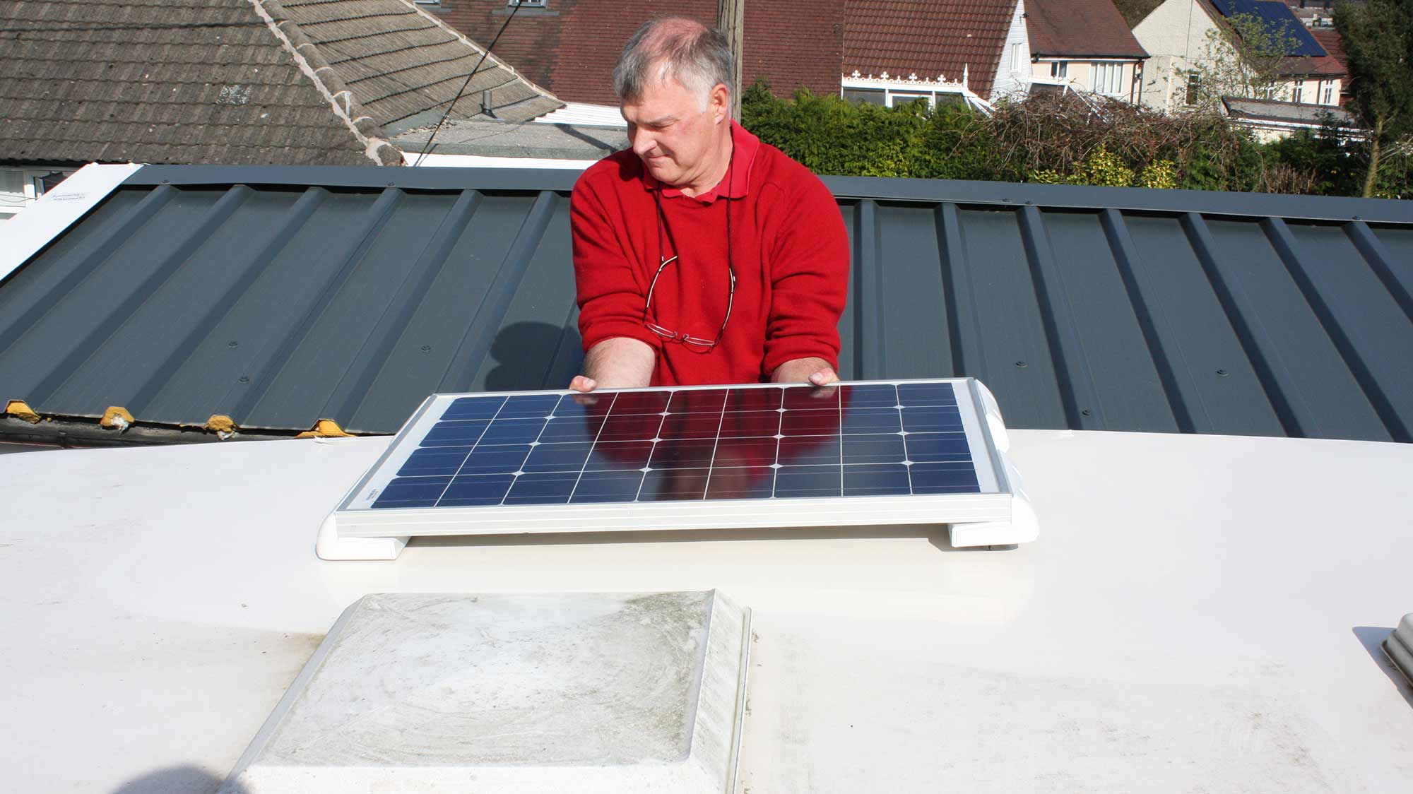

Installing a caravan solar panel is a straightforward DIY job if you’re comfortable with basic 12V electrics. If not, any decent caravan workshop can handle the install. Just be clear with them that you want the most panel wattage for your money. It’ll pay off every time you head off-grid.
The actual panel size is only one part of the equation, too. Other factors to think about include whether you want a permanently fitted roof panel, which you never think about again, or a portable one you rig up each time you pitch.
The choice is yours, but once you’ve tripped over your portable panel for the umpteenth time, you’ll wish you’d gone fixed. Just check your roof space first, to make sure the panels you have in mind will actually be the right dimensions for your tourer’s roof. No one wants to find out they don’t have room for their panel when they’re up a ladder covered in sealant.
