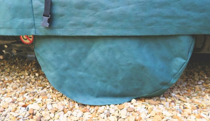

UV rays from the sun can cause the rubber in your tyres to degrade, resulting in cracks and premature ageing. To avoid this damage, protect the tyres with a wheel cover or store your van under cover.
The rubber in old tyres that are not used much can also harden, which leads to surface crazing. Similar damage can be caused by overheating, which is a result of under-inflation or overloading.

Caravans stored in winter are far more likely to suffer tyre deterioration
