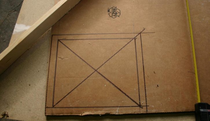

Having measured the heater, I drew a template of the opening on a piece of card. It’s easier to cut slightly undersize and then gradually remove sufficient material until the hole is just right rather than cut too much out and then have to try to fill in the hole, so I made the template slightly smaller than needed.

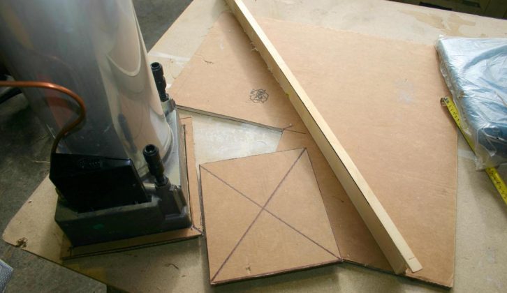

Having cut out the centre of the template, I had to trim the perimeter section until it fitted over the heater, confirming that the centre section was slightly undersize.

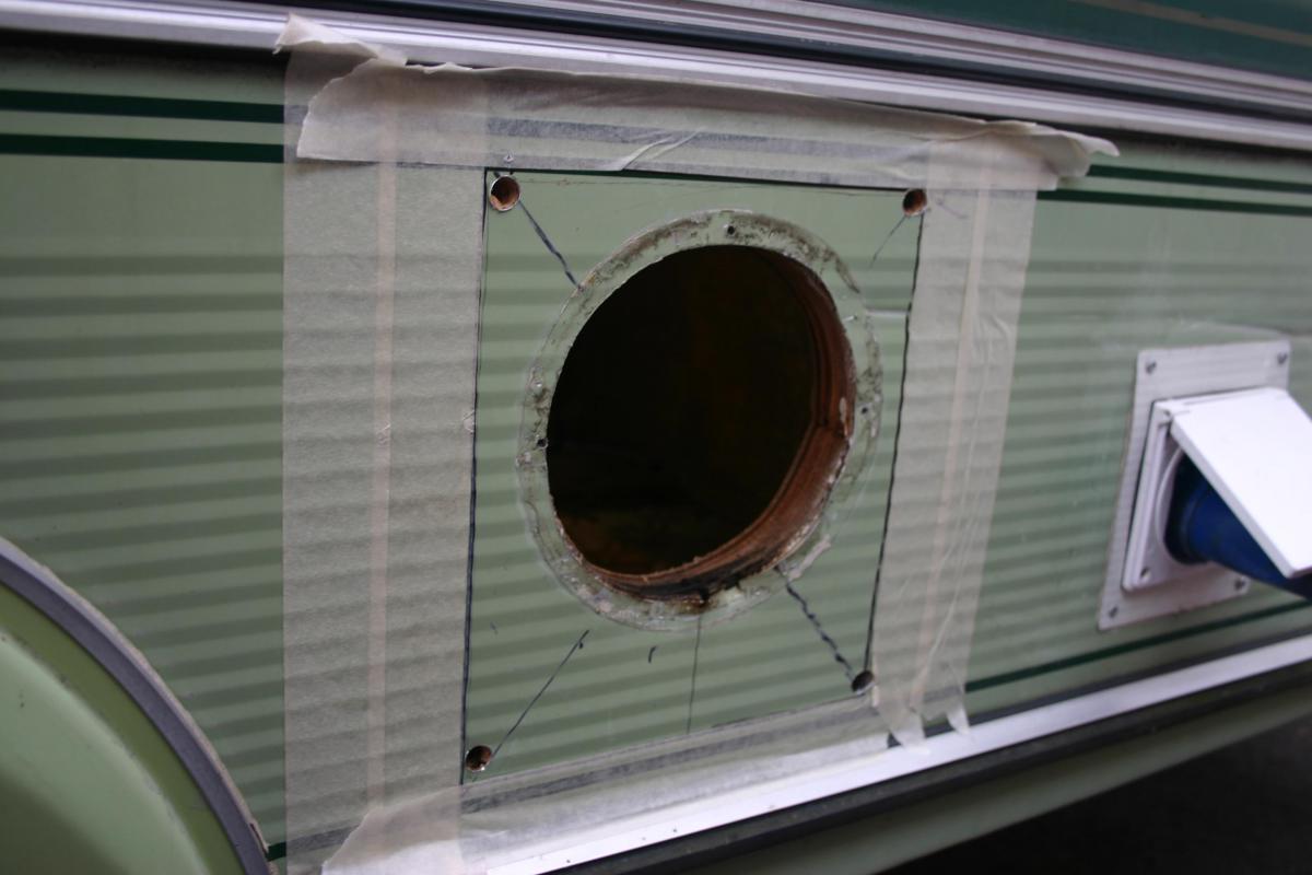

I used the template’s centre section to mark the hole’s position, avoiding the rubbing strake and upper trim. I masked the edge to stop the jigsaw’s sole plate damaging the paint, then drilled a 10mm hole in each corner and cut the central opening with the jigsaw.
