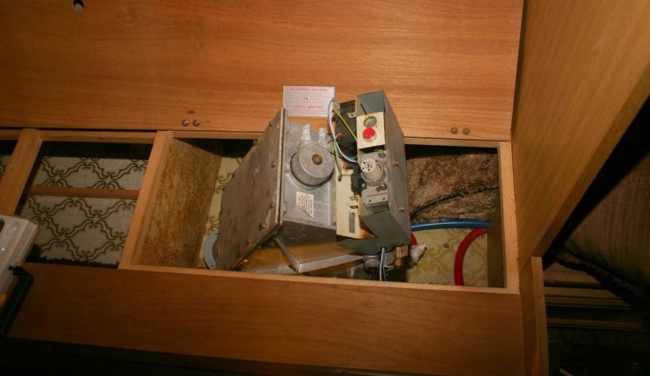

One of the appliances due for replacement is the old Morco water heater under the offside front seat. It had long since given up the ghost. Morco still makes boilers for static caravans but snapped bolts on the tank and hoses bypassing the heater suggested it was scrap. We are going to fit a good second-hand Carver Cascade Mk II in its place.
[tl:gallery size=460]
5
Unusually, the control panel for the heater is mounted on the end of the unit itself and pokes through the seat base. The flue runs through the side of the caravan on the opposite end. Removing the control panel and surround was straightforward and most of the water hoses had already been detached.

Finally, I undid the screws that held the heater to the floor. Because of its size, I was concerned it may be impossible to get the heater out from under the seat without dismantling it, but with a bit of manoeuvring it wasn’t a problem.

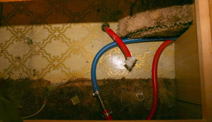

The hoses don’t conform to the normal conventions of red for hot and blue for cold. That’s another thing that I’ll need to put right when I replumb the water system!

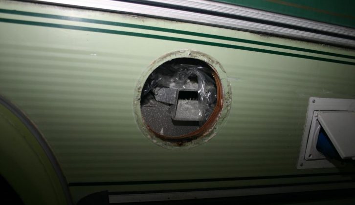

Luckily, the opening in the wall left by the Morco flue is much smaller than the one the Carver needs. I should have no trouble enlarging the hole, although I may have to fit a new timber framework around the perimeter to support the fixings around the flue.
