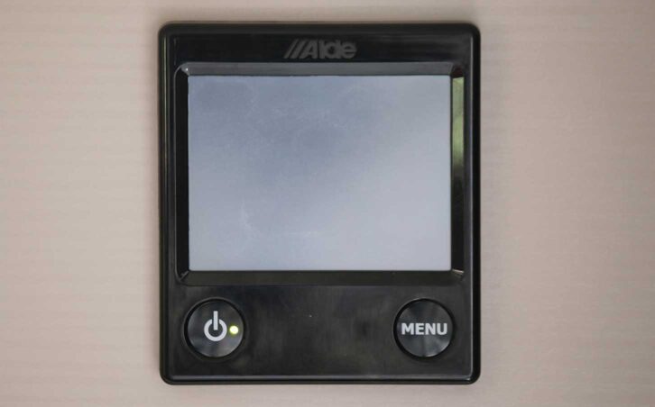

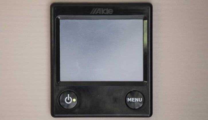

There is a third option, which is to have a ‘Dark’ screen. This turns off the display after 30-seconds, although the small green LED on the main on/off button remains illuminated to show you that the system is still operating. In the ‘Dark’ mode, all you have to do to see the display is touch the screen and it will light up for 30 seconds. Should you want to alter the settings, the display will remain on for 30 seconds after any adjustments have been made. Although this is one of the simplest functions on the 3030 control panel, it’s also one of the most useful.

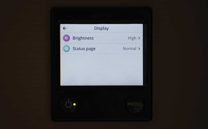

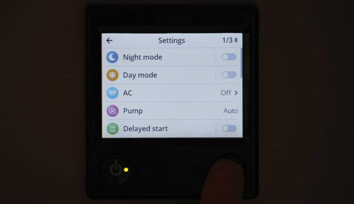

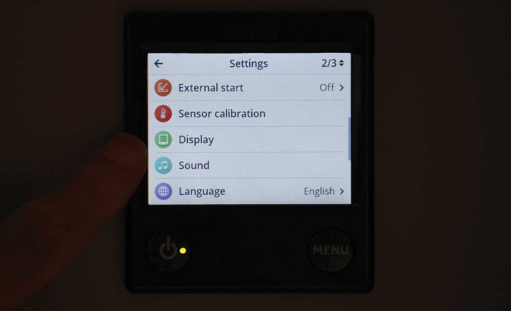

With the Alde system turned on, press the ‘Menu’ button at the bottom right of the control panel twice. This will take you to Page 1 of 3 of the settings. Touch the ‘Page 1/3’ icon at the top right of the screen. This will take you to ‘Page 2/3’ (where you need to be).

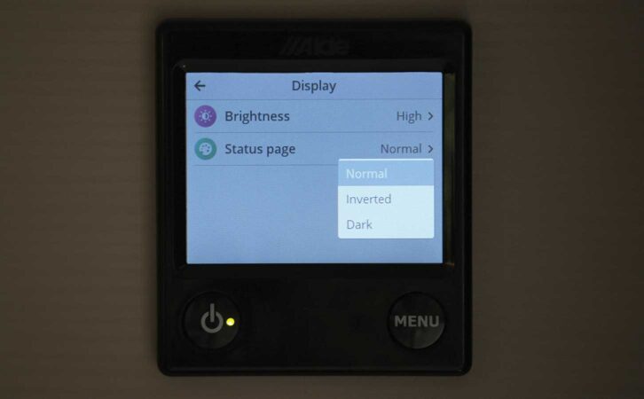

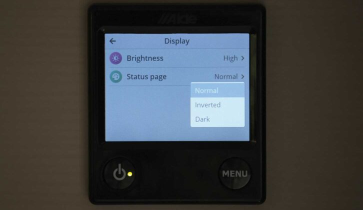

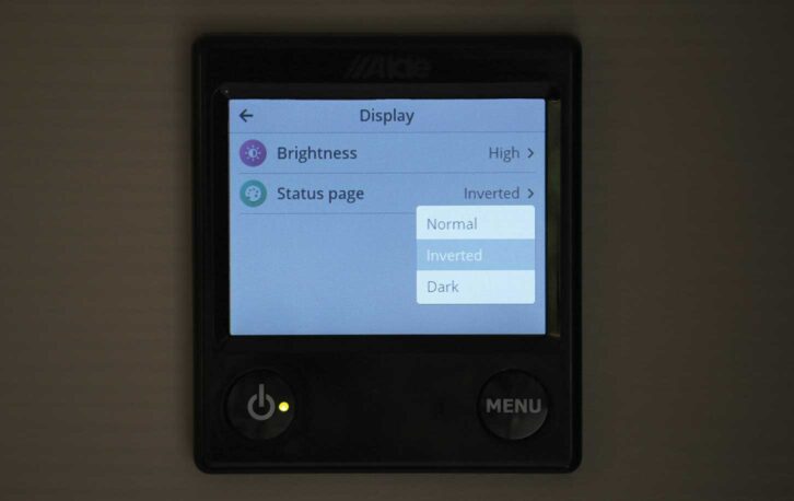

Halfway down the list of icons on ‘Page 2/3’ you’ll see the green ‘Display’ icon. Touch this, and the next page will give you the choice of two display settings, ‘Brightness’ and ‘Status page’. Touching the ‘Status page’ icon will bring up a drop-down menu giving you three choices: ‘Normal’, ‘Inverted’ and ‘Dark’. Obviously, the ‘Normal’ setting is the default, bright-background setting. ‘Inverted’ gives a coloured display on a black background, and ‘Dark’ is the setting where the display goes off after 30-seconds.
After making your choice, press the ‘Menu’ button twice to return to the ‘Home’ screen. If you’ve chosen the ‘Inverted’ setting, that is the display you should see. As far as I know, choosing the ‘Dark’ setting produces a dulled version of the ‘Normal’ setting, even when the brightness is turned to high.

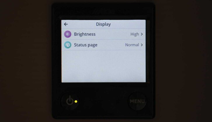

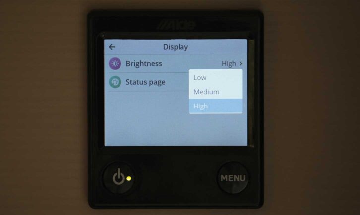

To change the brightness of the display, follow the initial steps outlined above and, when you get to the ‘Display’ menu, rather than changing the ‘Status page’ settings, select the ‘Brightness’ icon. This will open another drop-down menu, this time offering the options ‘Low’, ‘Medium’ and ‘High’.
For daytime use, my personal preferences are for the brightest setting on the ‘Normal’ display; anything dimmer makes the screen harder to see. For evenings and nights, we use the ‘Dark’ setting because, as mentioned, using even the lowest brightness setting on either the ‘Normal’ or ‘Inverted’ displays leaves you with a screen that gives off quite a bright glow.

2. Press the ‘Menu’ button twice to get to the ‘Settings’ page.
3. Touch the ‘1/3’ icon to go to ‘Page 2/3’, then select the ‘Display’ icon.
4. This will give you options to adjust the style and brightness of the display.
5. Touch the ‘Status page’ icon and a drop-down menu will appear.
6. Select ‘Inverted’; you might find that this is your preferred setting.
7. Press the ‘Menu’ button twice to return to the ‘Home’ screen – now inverted.
8. An alternative to ‘Inverted’ on the ‘Status page’ menu is ‘Dark’.
9. As before, press the ‘Menu’ button twice to return to the ‘Home’ screen. The display will go off after 30-seconds but the green LED on the on/off switch will remain illuminated.
10. To change the brightness of the display, touch the ‘Brightness’ icon and the drop-down menu will give you a choice of ‘Low’, ‘Medium’ and ‘High’.
