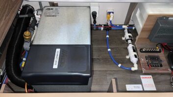

There was much scratching of heads until we came up with the bright idea of connecting the pump wires off the caravan socket by two short lengths of wire, each with insulated crocodile clips on the ends.
This enabled us to see that the pump flow was excellent, so the problem was clearly in the caravan system itself.
We checked the pressure switch, but this is connected at a T-piece and water doesn’t flow through it, so that clearly wasn’t the difficulty.

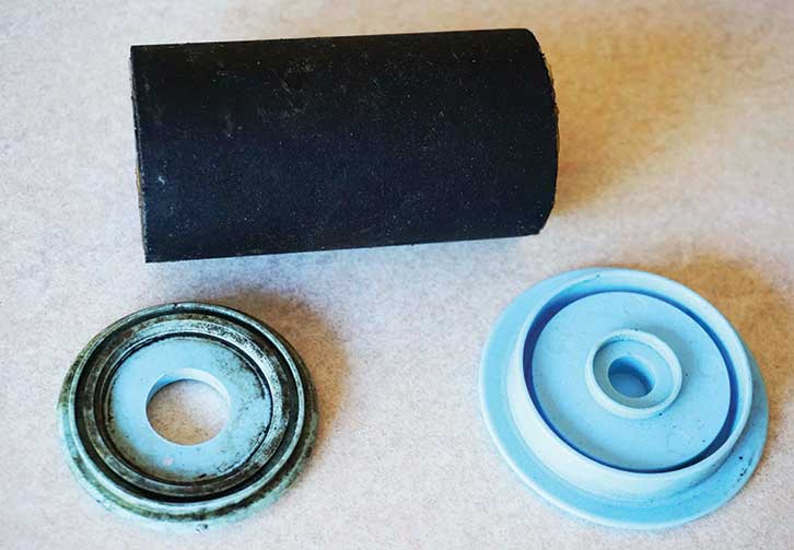

Finally, we removed the blue filter cover, just above where the pump connector is plugged in. The old filter looked well past its best and actually fell apart on removal. The thought occurred to us that perhaps after three years, it was clogged and not functioning properly.
The blue cover was replaced with no filter in position and the system tested again. Eureka! We now get an even better flow than with a new filter in place, which is how we plan to go on.
