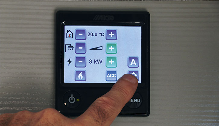

On the Control Panel, starting from the Home screen, press the Menu button, which will show you the default settings; temperature set at 20°C, water heater on, and using electricity only, on the 3kW setting.
You don’t need to alter your preferred settings when you set up the Night Mode. You’ll find that whenever you turn off the heating system, it will always return to those settings when you turn it on again.
Touch the Settings icon at the bottom right of the screen, which will take you to page 1 of the Settings.

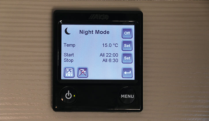

Touch the Moon icon and you will see the Night Mode menu page displayed. First, set the overnight temperature.
We tend to set ours to 15°C, but you can choose anywhere between 5°C and 30°C; it’s up to you. Touch the Back Arrow (bottom right) to return, and now set the time that you’d
like Night Mode to start.
This is when the system will change from your default settings (20°C, water heater on, and so on) to the new chosen night-time settings (15°C in our case). Bearing in mind that the caravan will still be the higher temperature when Night Mode takes over, you might want to set the time to half an hour or so before you go to bed, so that there’s time for the interior to cool down a bit.
Next, set the days on which you want Night Mode to run. You can specify individual days, but we select All, so it works every day. Tap the Back Arrow to go to the Stop Time.
Again, bear in mind that the caravan won’t instantly be up to temperature, so I would also suggest setting the Stop Time to be an hour or so before you tend to get out of bed.
Of course, the time it takes to heat up the caravan will depend on the outside temperature and which power setting you will be using: Gas/Gas + Electricity/Electricity on 2kW or 3kW (1kW will struggle to heat the caravan and the water).
Set the times
With your Stop Time selected, touch the Back Arrow to return to the Night Mode menu page.
Now at the bottom left of the screen, you’ll see there are two icons. The one on the far left (which looks like a split screen)is to invert the screen – that is, rather than having the glaringly bright screen with black figures displayed during the night, the screen will be black with white figures. If you prefer that, tap the blue icon so it turns green.
Next to that is another icon, showing a shower head with a red cross over it. This turns off the water heater, again a good idea for night-time, so tap that and it will turn green.
The water will, of course, remain warm enough to use at night should the need arise.
Finally, ensure that the icon at the top right of the screen is green and showing On.
If it is blue and shows Off, touch it, so that it changes to green and On.

1. First press the menu button,
2. Next, touch the Settings icon.

4. The Night Mode menu page.
5. Set Night Temperature, then press Back Arrow.
6. Set Start Time and select a day, or All.
7. Now set the Stop Time.
8. If you want to invert the screen display, tap the icon (bottom left) so it changes from blue to green
9. Similarly, if you want to turn off the water heater overnight, touch the Shower icon to turn it green.
