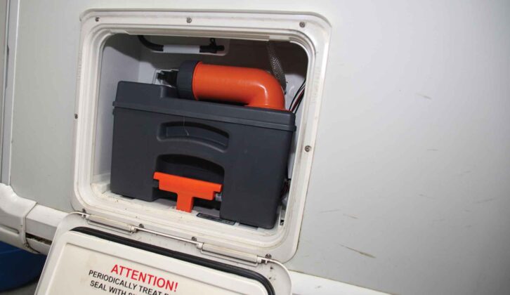

To begin, simply unlock the cassette locker so you can open the hatch. To do this, you will generally have to nip either the yellow or orange handles together with the grey grip, which will release the cassette.
The cassette should be quite easy to slide out now – if it isn’t, never force it or you risk breaking it. Should your cassette not be coming out, the most common cause will be that the toilet blade hasn’t been closed, subsequently locking it in place. Close it and you should find the cassette now comes out.
