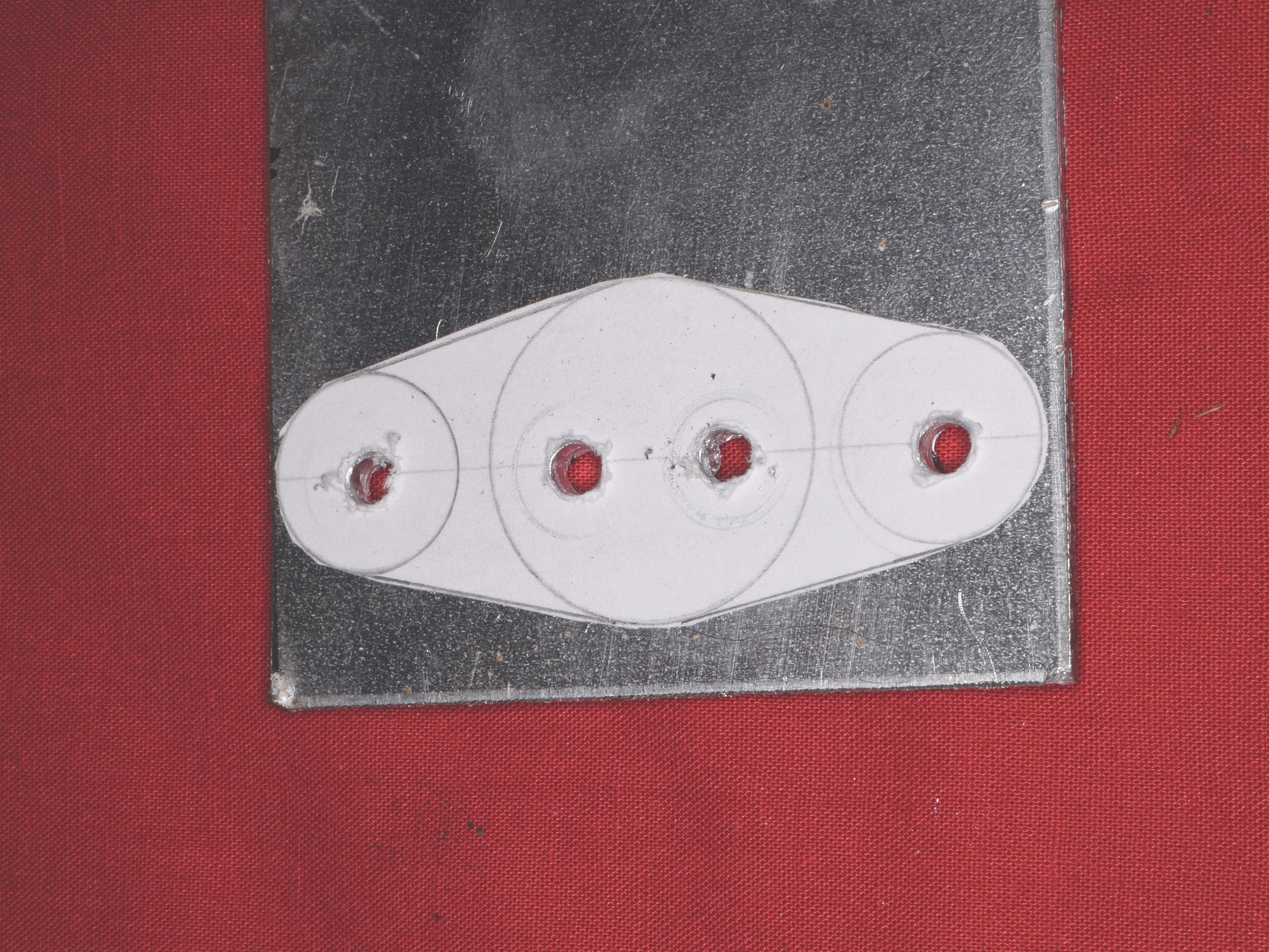

For the catch assembly, mainly non-ferrous materials (copper and aluminium) have been used.
This means that the various parts will not be trying to grab hold of the magnets during assembly, which could make for a very difficult situation.

- Aluminium plate, 3mm thick. Once again, eBay has many suppliers of this material.
- M4 x 6mm stainless steel countersunk screws.
