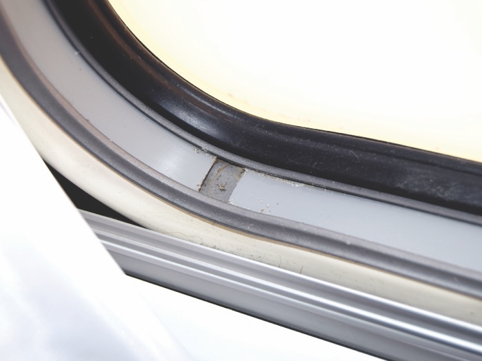

1. A split in this PVC strip has rendered the left-hand window catch inoperative.

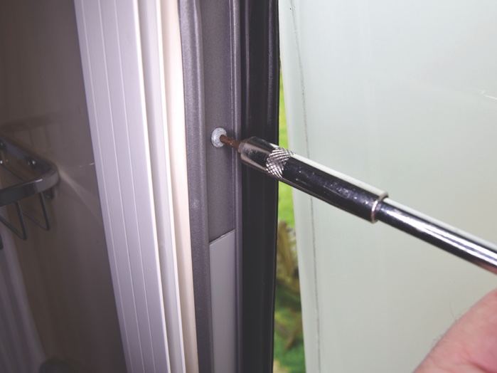

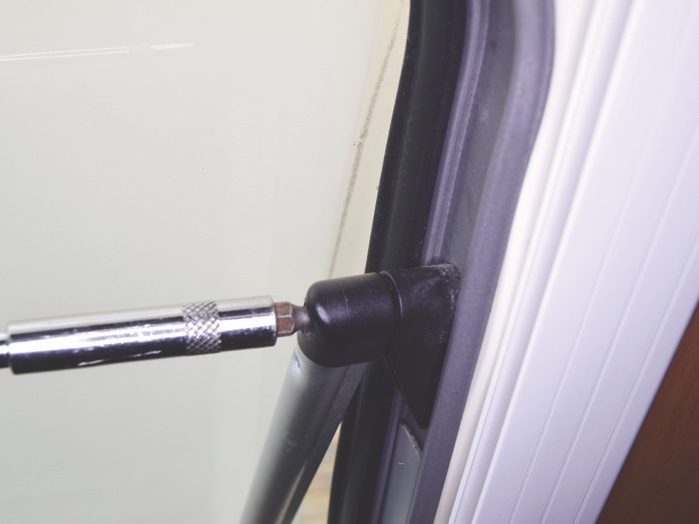

2. Remove the end-stop screen from the left-hand side of the window frame.
3. Next, remove the window stay-bracket from the right-hand side of the frame.

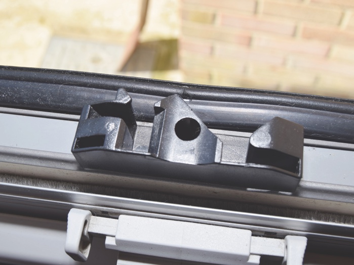

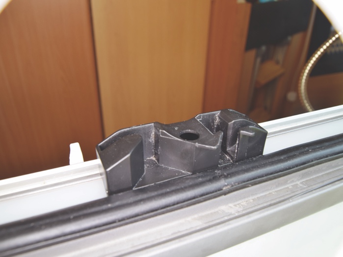

4. The central sliding block is now ready to be removed from the window frame

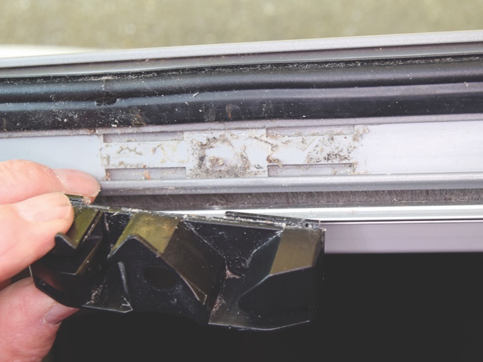

5. Using two screwdrivers, push to release lugs, then pivot block out from runner.
6. Block removed, showing four recesses driving strip when catch is operated.

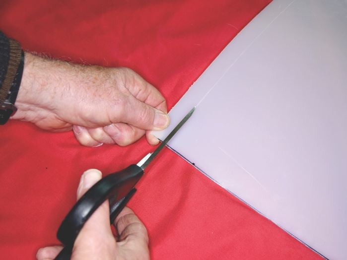

10. Next, carefully mark up the edge of the nylon sheet before cutting.
11. Using sharp scissors or shears, cut along the marked line

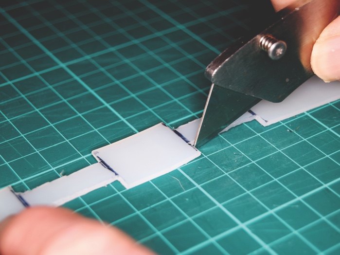

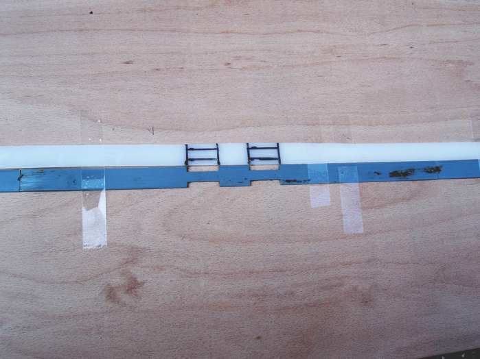

12. Reassemble PVC strip next to nylon strip, then mark aperture cutting points
13. Using a craft knife, carefully cut out the apertures as marked.

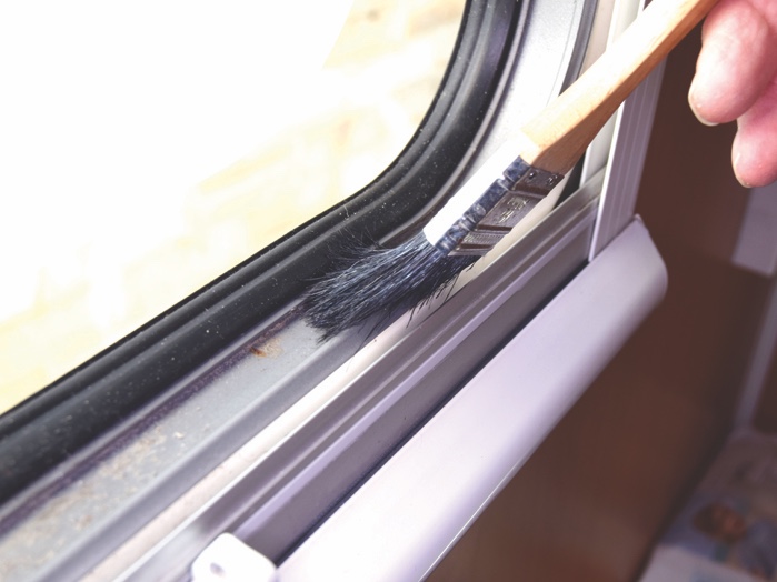

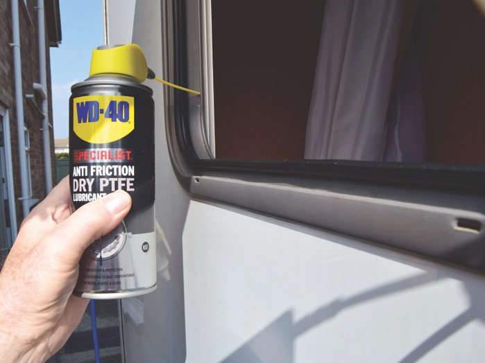

14. Using white spirit and a small brush, clean the inside of the guide channel.
15. Then apply PTFE spray to the inside of the track and allow it to dry.
