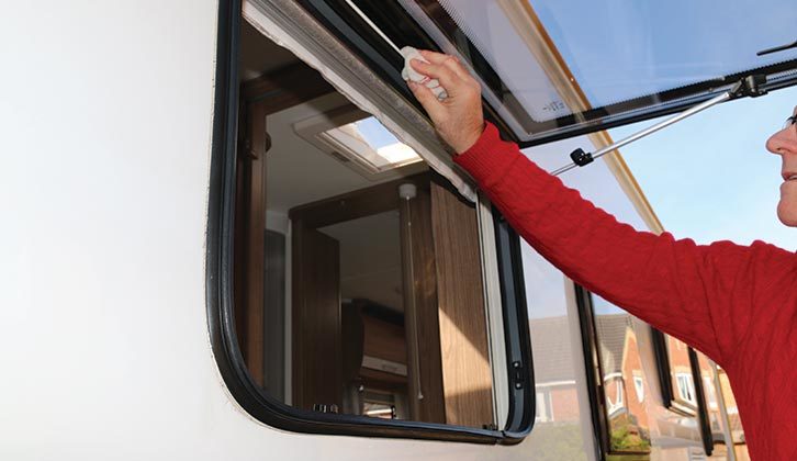

With any luck, all of the van windows will open freely for you. So what needs to be done to keep them that way? Start by fully opening the window that you’re going to be working on.
Then, using only clean water and a cloth, clean the rubbers, wiping all the way around the window aperture.
Again, you shouldn’t use any kind of detergent (washing-up liquid or soap, for example) because these may react with the rubber, which will become sticky to the touch, immediately or over a period of time.
While on that subject: if you find that any of the rubbers are sticky, there’s not a lot you can do in the long term, other than replace them, but a sprinkling of talcum powder might alleviate the problem in the short term. Chances are that if you do have a sticky seal, it’s been caused by someone using incorrect lubricants, or detergent.
Having thoroughly cleaned the window rubber with clean water, allow it to dry.
Of course, you can work your way around the van and clean all of the seals before going on to the next stage of maintenance; but with the windows wide open, be careful that you
don’t walk into any of them – it’s very easily done!
Lubricate the rubber seals by spraying silicone lubricant onto a cloth and wiping it around the seal. I recommend spraying this onto the cloth, as opposed to directly onto the seal, because the stuff tends to go everywhere if you’re not careful.
You don’t need much, and once wiped over the seal, it’ll have a pleasing sheen. That should prevent any sticking during the season’s touring.
Don’t just do the window seals, though – all of the other external openings are likely to have a seal as well, including the entrance door, gas-locker doors, external hatches, and the toilet cassette door. Give all of them the same care, using clean water and silicone lubricant.
