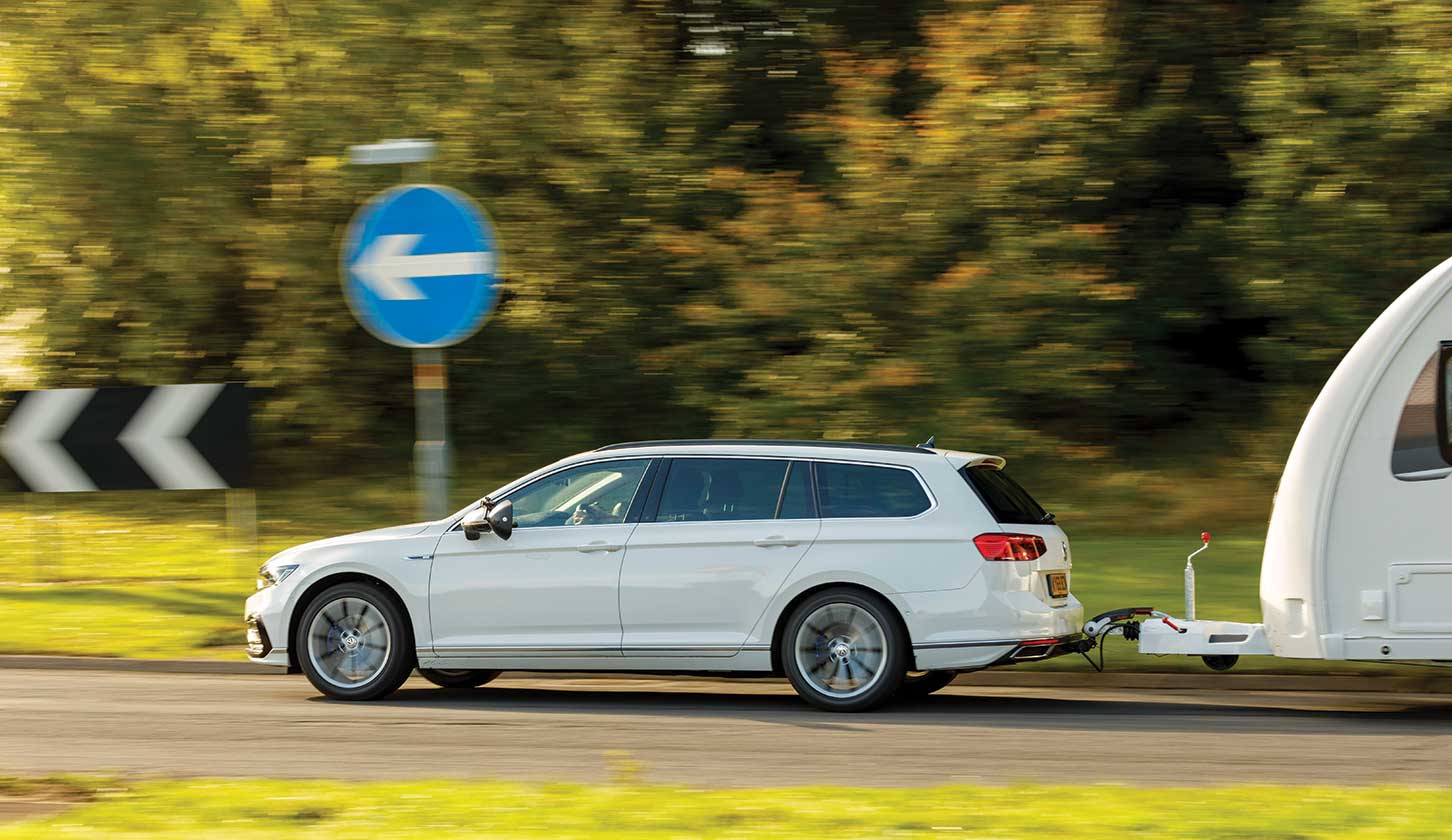

Is a legal match a safe match?
A car’s legal towing limit is determined by its ability to tow a trailer – or caravan – uphill, repeatedly. So it’s really a measure of the strength of the tow car engine and the durability of the transmission.
It doesn’t necessarily mean a car will feel stable and secure towing that much weight when it hits the caravan speed limit of 60mph on the motorway with a gusty wind blowing for company.
The two major caravanning clubs both recommend an 85% matching ratio for safe, stable towing.
In other words, if your car has a kerbweight of 1500kg, don’t tow a caravan weighing more than 1275kg (1500 multiplied by 0.85). This is often referred to as ‘the 85% rule’, but it’s a guideline or rule of thumb, rather than a legal requirement.
The club considers it acceptable for experienced tow car drivers to tow up to 100% of the tow car’s kerbweight, but never more than this – even if it’s legal to do so.
