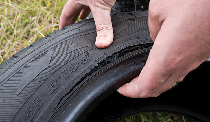

Take a look at the tyre walls for bulges caused by the tyre structure failing. Also keep a close eye on any signs of cracking. Walls can crack and this is easiest to spot at the bottom, where the tyre wall is flexed the most.
Radial cracking is harder to spot, but to look out for it, examine between the treads and search for cracks running around the radius (hence ‘radial’ cracking). The other thing to spot is cuts in the sidewall, which are caused by an impact of some sort or anything stuck in the tread. Any of these will require immediate investigation by a tyre workshop.

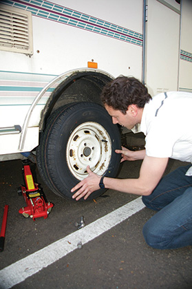

You can’t do this inspection properly with the caravan in one place, either. Roll it forward a few feet and clean the tread that was in contact with the ground.
There is also no alternative to sliding underneath (with all wheels chocked) and having a look at the inward-facing tyre walls. Your mobile is a bonus – it works as a torch and you can poke the camera into places your eyes can’t reach, to look for damage.
Don’t forget to check the spare tyre, too. Yes, it’s a very unpleasant task to have to (safely) clamber underneath the caravan or wind down a carrier, only to discover that all is well, but if you need that spare at some point, you’ll be glad you checked.
